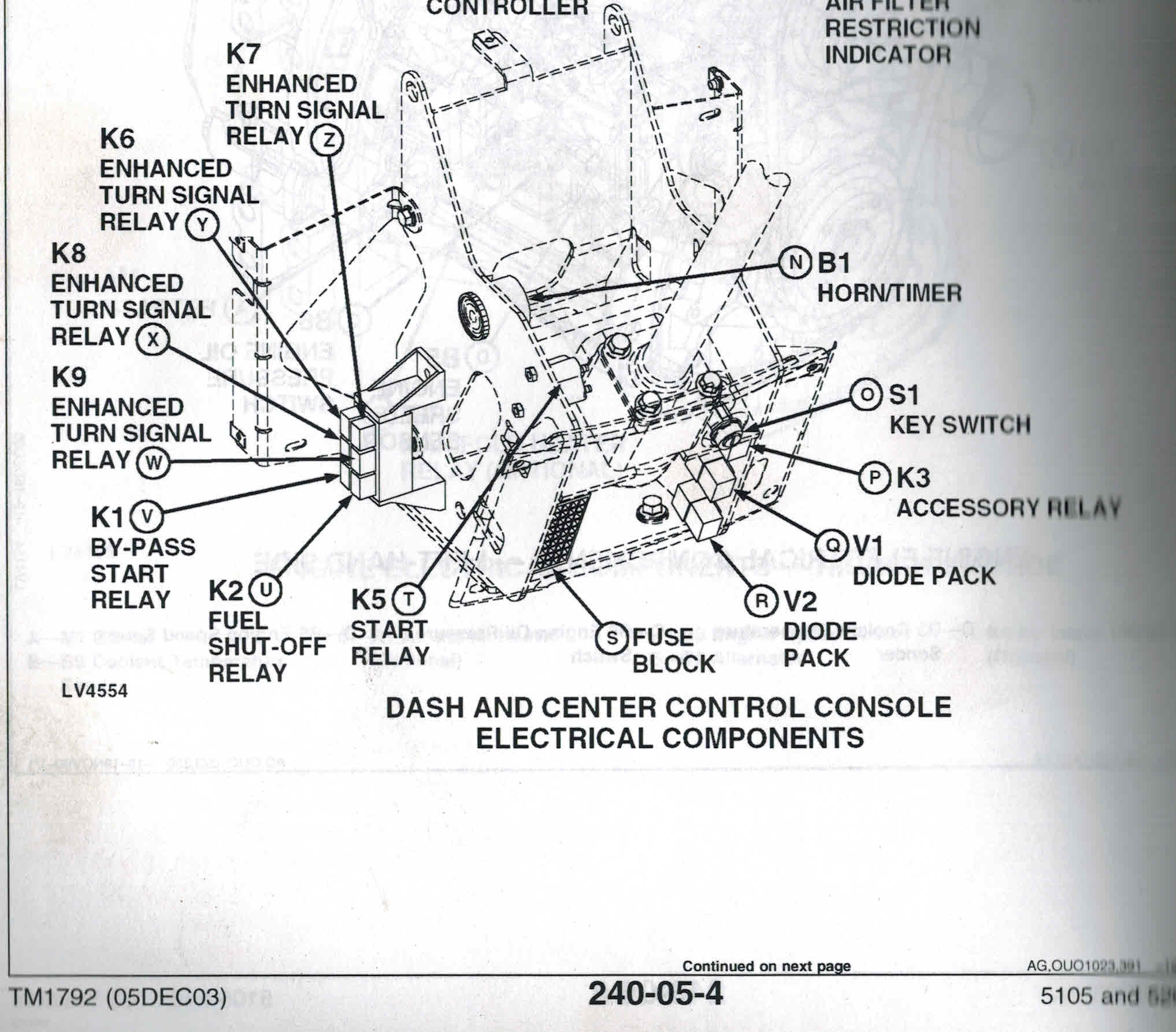

Does anyone know if this unit has a separated relay for the Inj pump solenoid?
If so, Where is it located. I have only found 1 relay and 2 other relay-ish items inside the console by the fuse box. The one relay tested fine.
/ JD 5105 not staying primed #15
I'll attach a copy of the manual page showing the locations of some of the relays but to troubleshoot your problem correctly you should acquire a manual. The up front cost may seem like a lot but will pay off in the long run if you wish to do your own repairs.

Two of the six relays that are in the left side of the console tested bad. I swapped them around and was able to get voltage to the shutoff solenoid. Ordered from the dealer.
