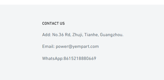

#74
It's valid if you want a chinese rebuilt engine in your tractor
