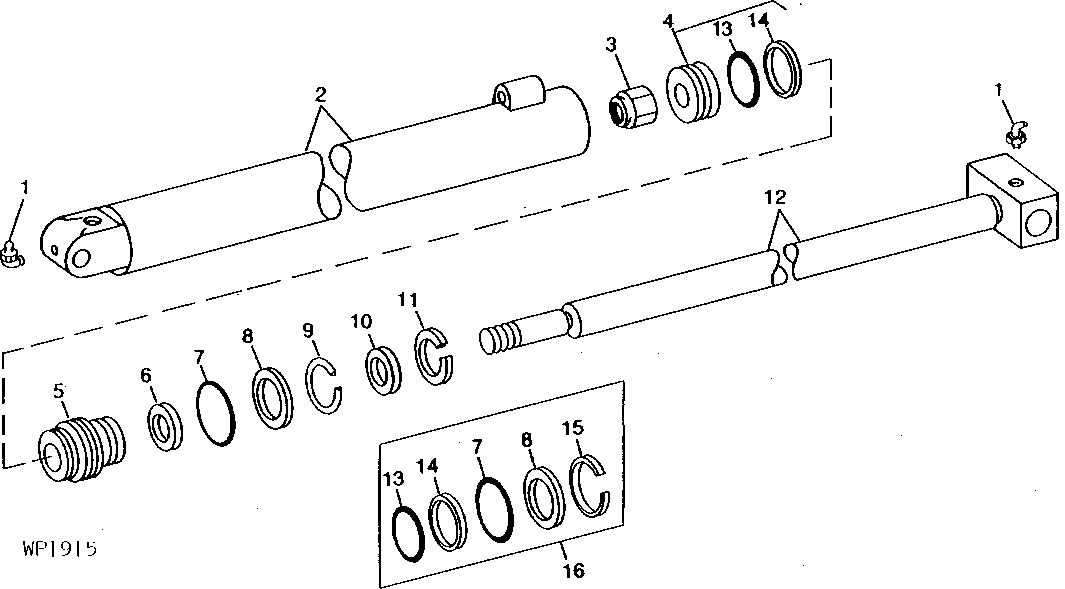

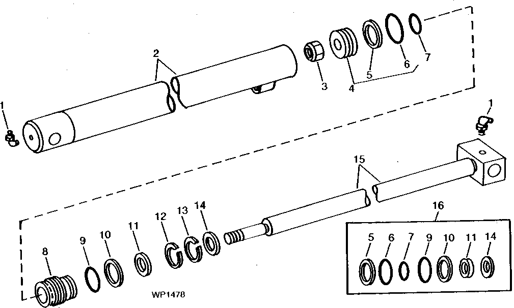

the other more common type will expose the inner ring after the suck-back ring is removed .....thinking you have this style Deere Runner.......just tap the gland in enough to make clearance for internal ring to clear and remove
I guess I did mention it....:eek:

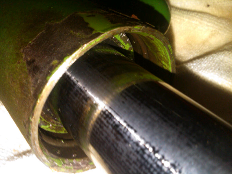

Not sure if I did it correct or not, but I needed to fill the outer "suck back" ring with bondo in order to slide the guide back in the tube far enough to expose the second (internal) ring. It wouldn't just slide back in the tube without filling the groove. It may be a few days again before im able to work on it, but I will give it a shot. Why does the easiest of jobs always turn out to be the biggest pain in the butt?:laughing:
