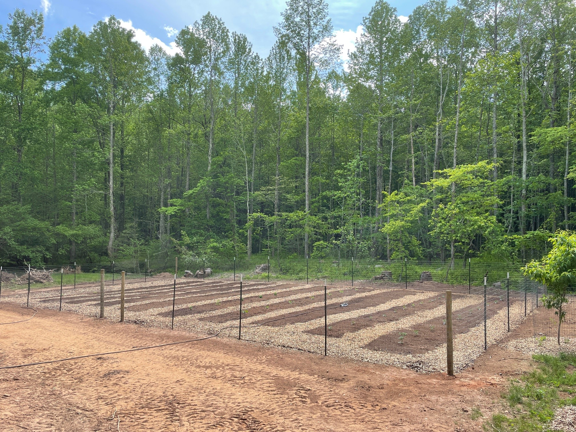

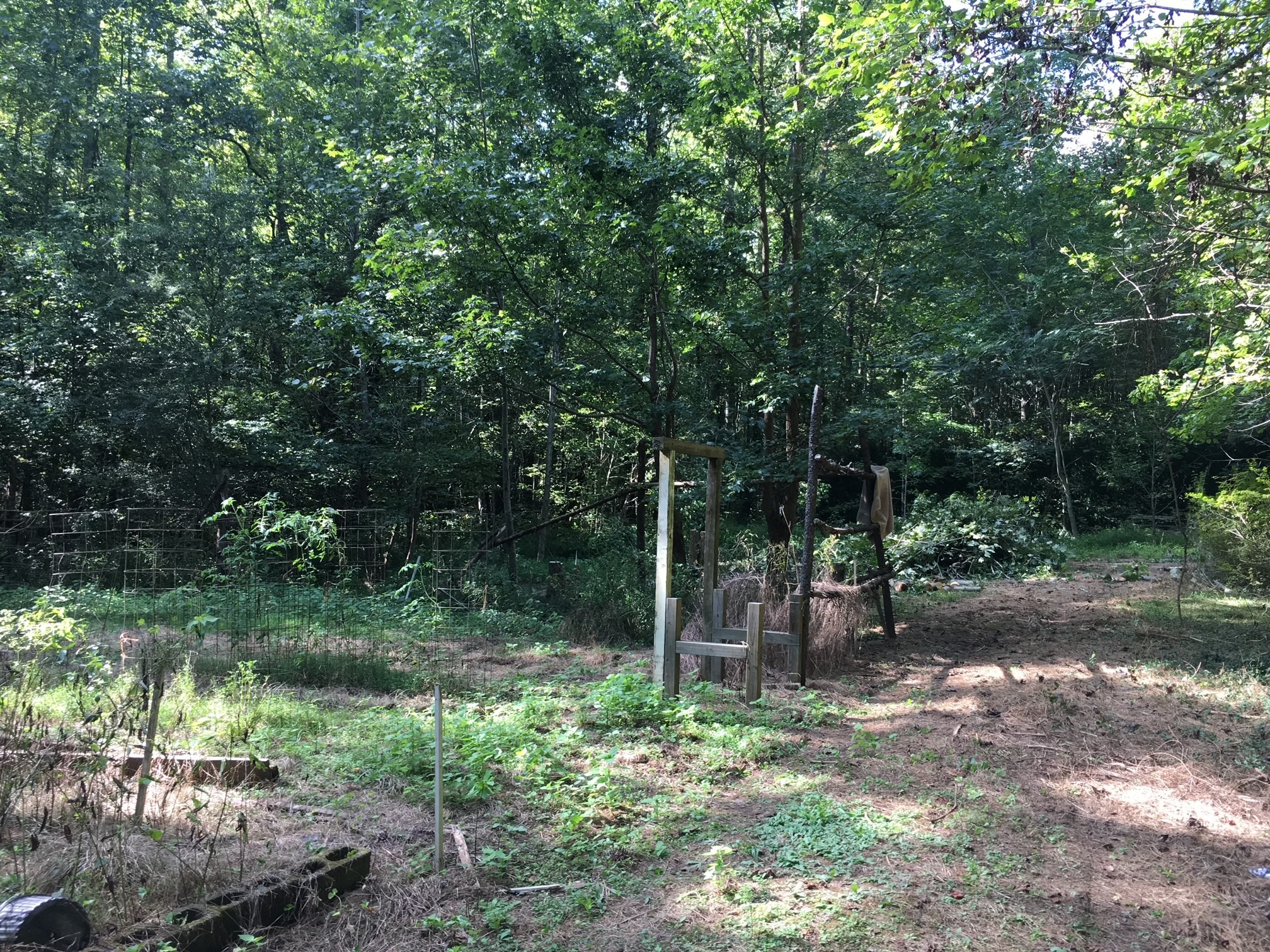

Here is how I just got through with a similar task in the North Ga mountains. The ground on our property also has a very large quantity of small to medium sized rock and stone. I started with tree cutting followed by stump grinding as much as was possible. Then I used a heavy duty single shank subsoiler to pull up all the bigger roots of the trees within the garden area we were planting (only broke one shear bolt in the process). This also brought up a lot of the larger rock buried in the soil we were then able to clean out. Next step was using the box blade tilted forward with all the ripper teeth down as deep as they go and running in all directions to get the ground broken up. This pulled up the remainder of the roots and much more rock and stone that we picked up.
Final steps were to grade the area relatively flat with the box blade and then make a few passes with the tiller. This either brought up more rock or buried them down deep. After then tilling in a couple of truck loads of compost, we have a pretty nice garden area. Had to fence it in to keep the deer out and hopefully the bears won't try to get in.
Here is a before and after of the general area. Its not as large as what you are talking about doing but the process should work the same. Good luck with the project.
Bruce.
