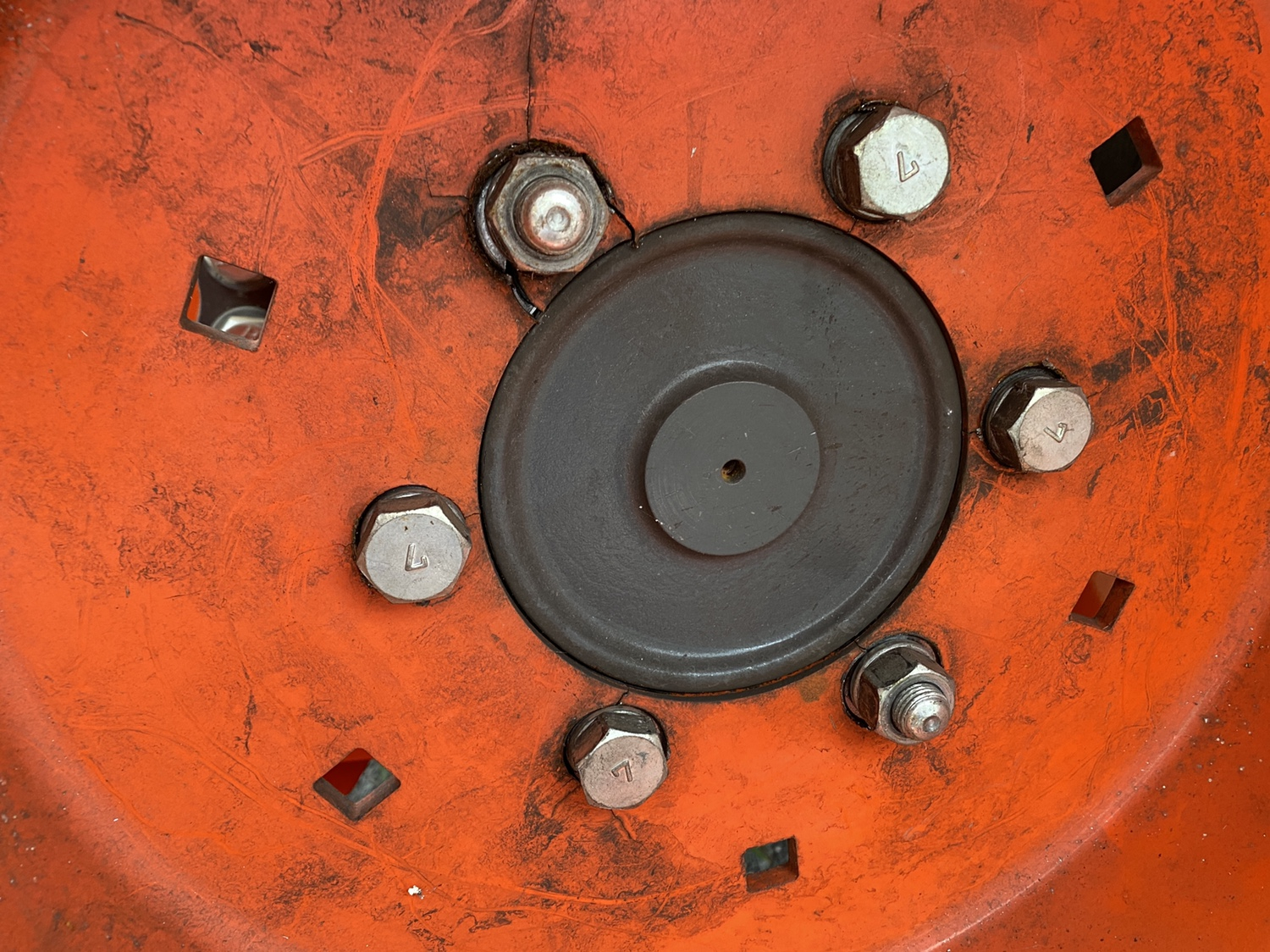

Discovered an issue with rear tire rims on my L3940 cracking at the lugs. . Looks like I can get a new disc for it. Just worried about the weight of removing the tire. I have BH so no problem jacking it up. View attachment 754795
I had this problem and I solved it by taken a 1/4 flat steel and cut a round plate big enough to cover all of the bolts. Then I drilled hole in them it to match bolt holes then put plate on an bolted it down. I have not had any problem since and I even have Foam filled tires that makes them real heavy.

/ Removing loaded tires #27
Use the hoe to lift the tractor up, put blocks under it, then use the hoe to remove the tire (if the hoe isn't on the same tractor).
On my 4300, I have industrial R4's so just jack up the tractor and keep the tire upright. They are liquid filled and heavy but not impossible to move around.
Sorry to see the serious cracks in your wheel.
