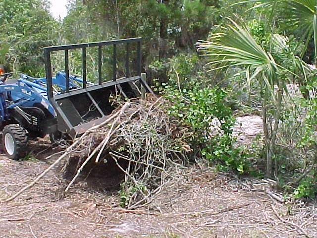

   / Removing barbed wire fence #21
Doesn't look like it would be that tough from here...

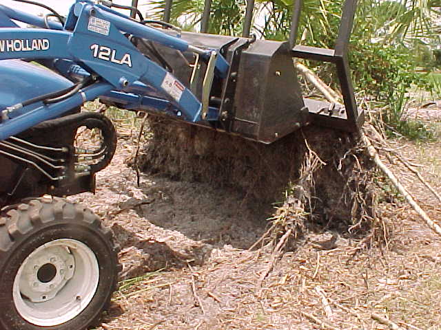

   / Removing barbed wire fence #22
But, it's actually like a carpet of vine roots, and they don't always want to come out of the ground.

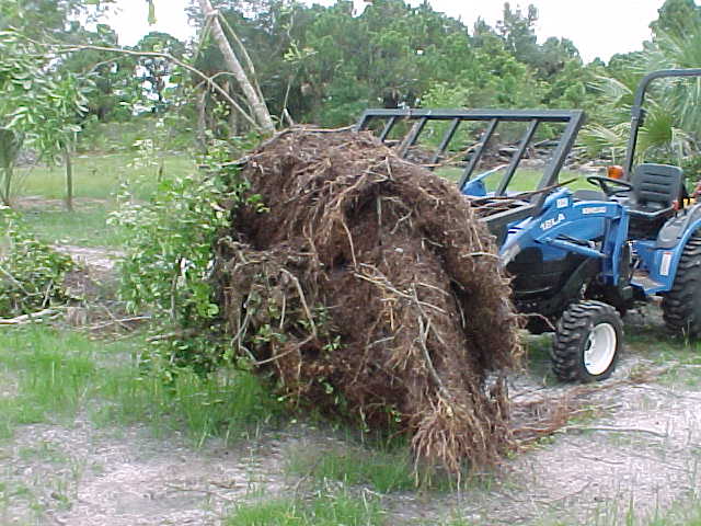

   / Removing barbed wire fence #23
Sometimes I get a pretty good load with one scoop.

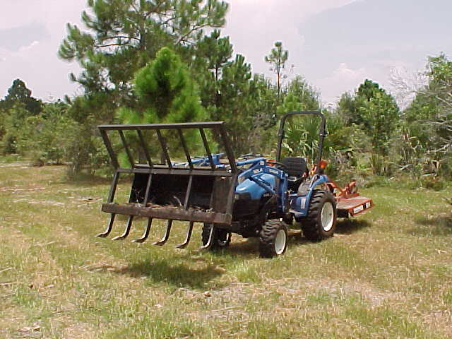

   / Removing barbed wire fence #24
And here's the monster than can handle it - all 18 HP of it /forums/images/graemlins/grin.gif. If you missed the story of building the rake, it's here - bucket mounted root rake

   / Removing barbed wire fence #27
One of these days, Real Soon Now, I'm going to fabricate different shanks for the scarifier teeth. The ones I got from the box blade are a little too short in the lower (mostly horizonatal) portion, and when I try to fill the rake, a lot of stuff rolls off to the front instead of curling to the back. I need shanks that are longer at the leading edge and with a little more curve. It's a digging fool, though, at least in the Florida sand. Sort of like extra aggressive bucket teeth.
