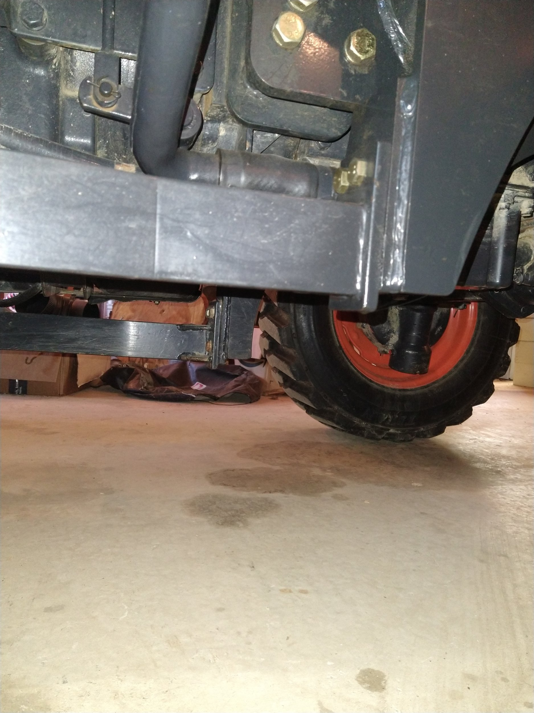

I have a 2014 Kioti NX4510. The FEL is attached to a Subframe. It's a wicked strong loader, generally I assume it's a good idea to leave on the subframe. The problem is, I'm getting ready to use it for some rugged woods work (skidding), and the subframe eats up a lot of clearance. On the left side in particular. I've gotten it stuck on a stump fairly often. Obviously I could remove the frame and the loader, but then I would lose the use of the FEL mounted Log grapple. I also know a FEL is also handy if you get stuck.
- is the subframe primarily used to spread the horizontal load/stress from pushing?
- would I stress anything out by lifting logs with the log grapple without the sub frame components bolted on? (Vertical loads)
Can post pictures if needed. Thanks!

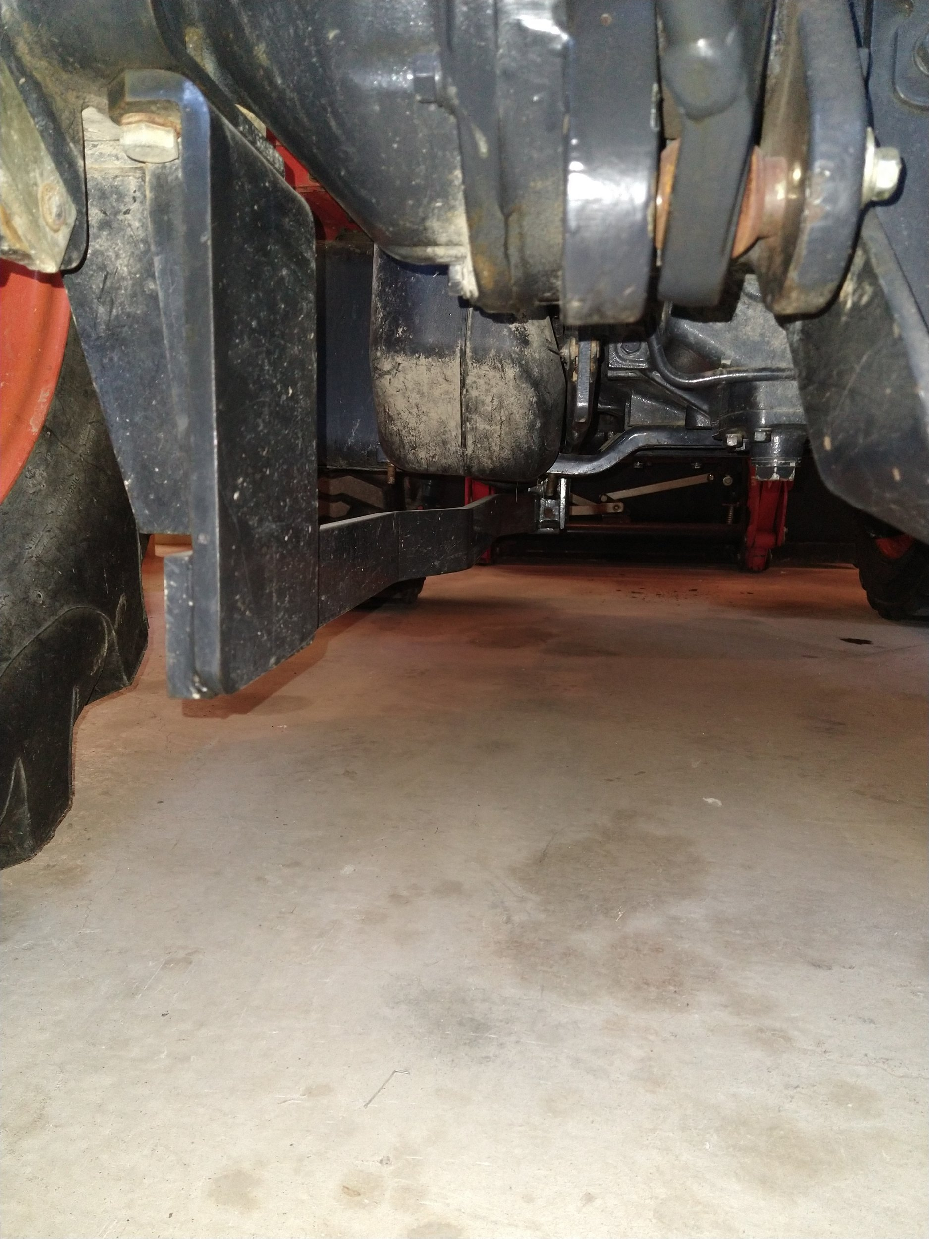

Picture attached. The subframe is in parts. The magor attachment point is bolted to the area next to the engine, but then a long horizontal piece is bolted to that piece, and goes to the back axle. I'm wondering if I take off just the horizontal piece

Here is a decent shot. The vertical part that goes up out the top of the photo attaches to the loader arms. The horizontal goes to the back axle. Note the bolts

I would learn to live with it... test it out and see how much it gets in the way (or if it saves your under belly). Why remove it until you know it's a problem!

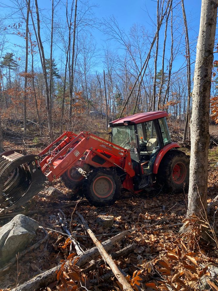

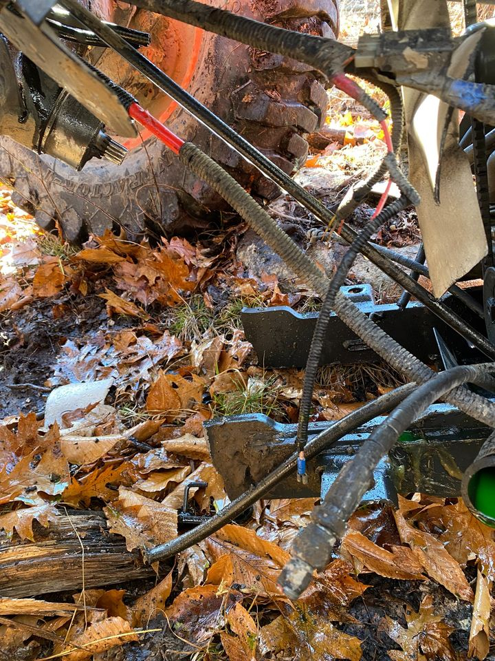

Here's what can happen, even with a subframe if the tractor is stressed beyond design. Note his subframe sitting on the ground in the first picture. These pictures were from a post earlier this year. Apparently, this owner was logging too. I call it a Dead Kioti.

Looks like a good reason to leave it on
I think I saw this for sale on Facebook or craigslist! I think they got it put back together... I think I'm convinced.
