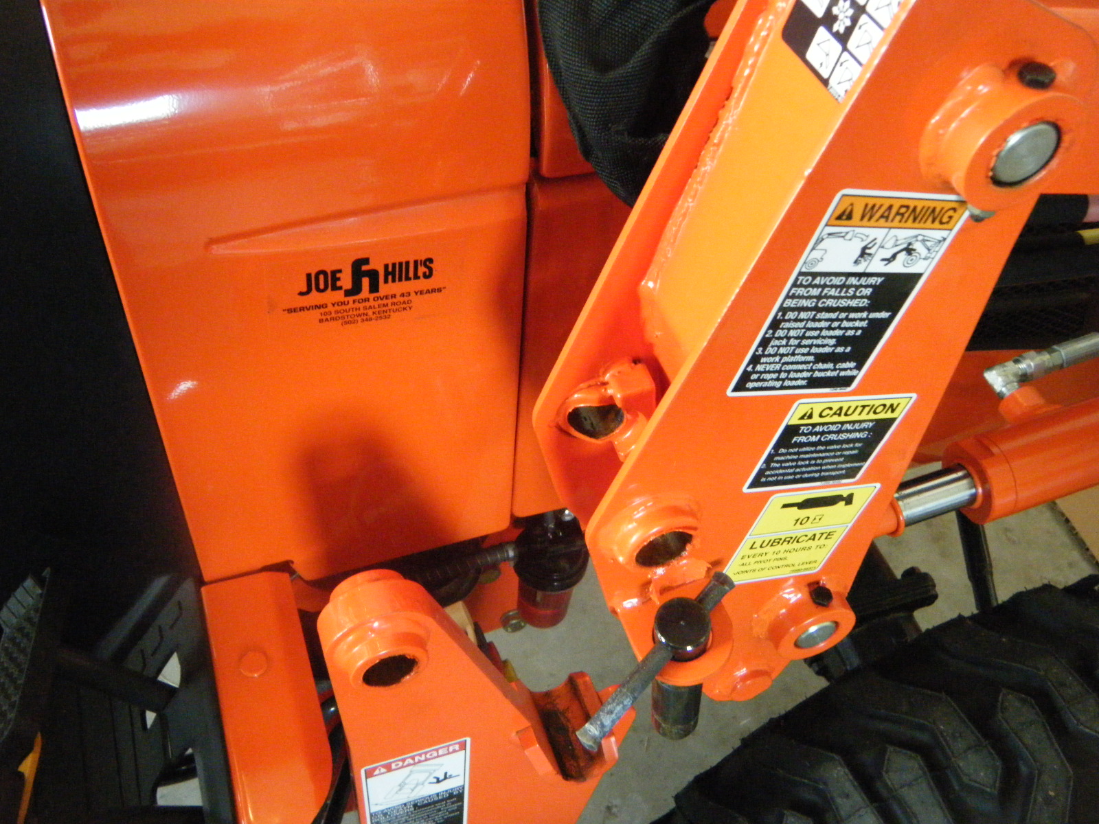

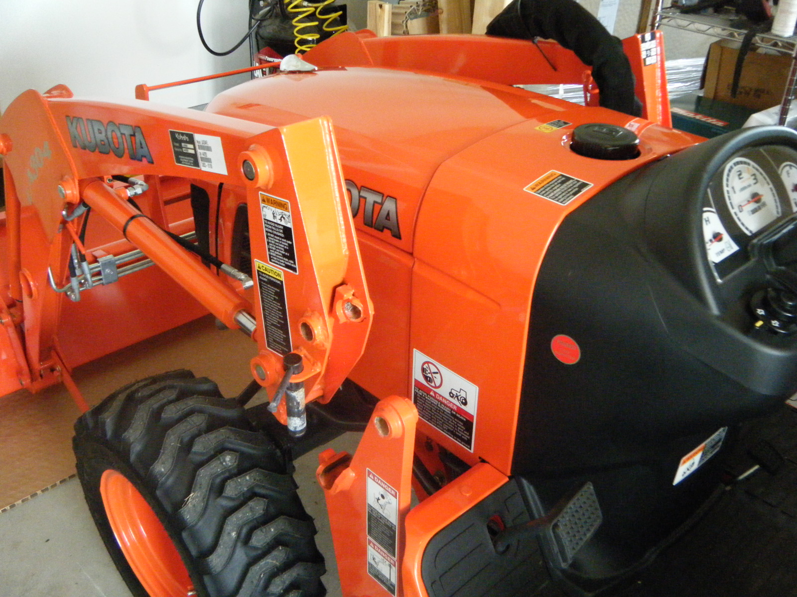

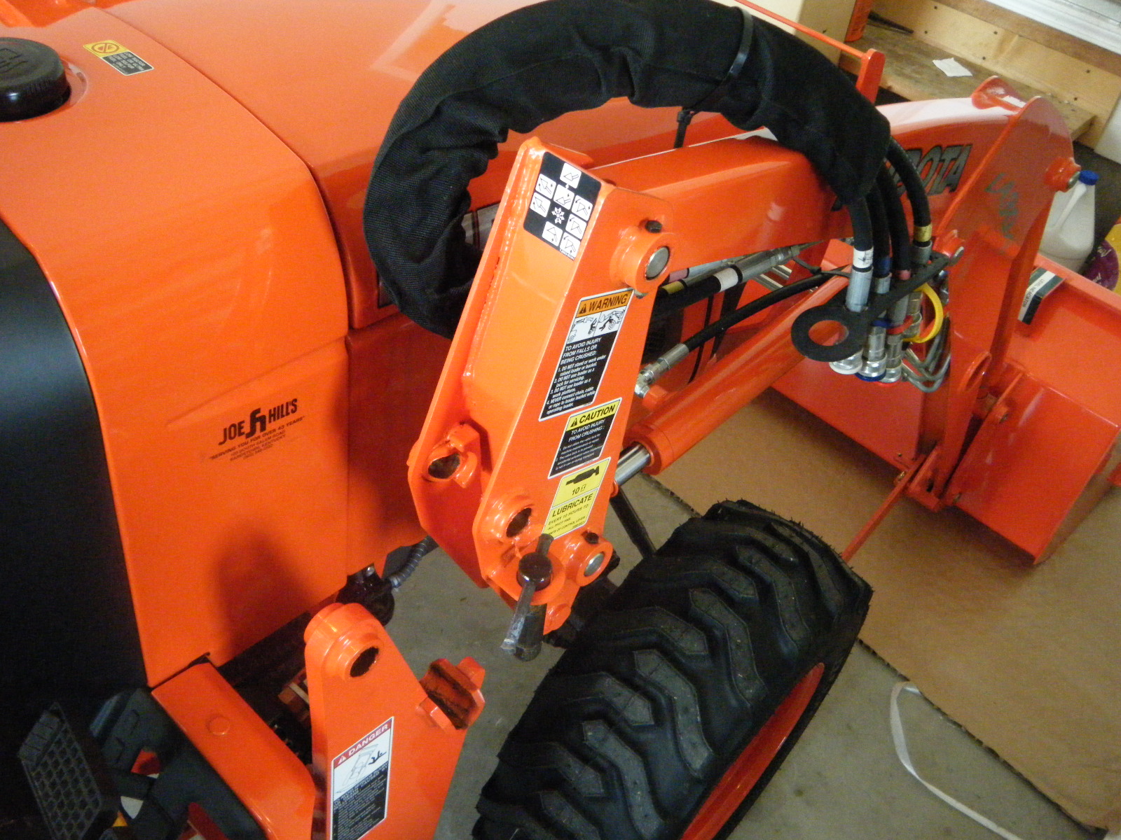

Never mind the cluttered garage (a man will resort to all kinds of things to make a new toy fit and nearly take a cussing from the wife explaining why room wasn't made for her car). Anyway, I decided to take the FEL for two reasons, 1. to learn how and 2. make things easier while mowing. It was pretty simple to do. Followed the instructions but didn't really lift the front wheels, or at least it didn't appear to . After lowering the stands, I lowered bucket and rolled it slightly keeping pressure off stands. The right side pin pulled out easily. The left pin was a little stiff so I bumped the control lever a second time and it too slid out with no effort. Then rolled the bucket back slightly and it lifted out perfectly. This is a lot simpler than it appeared to me.

Amazing piece of engineering, aint it! A few more times and it'll be like second nature. Just remember to rotate the joy stick in all directions to equalize the pressure in the hoses before you unhook it. If there's too much pressure in one of the hoses, it can be a real "beach" to get it plugged back in.

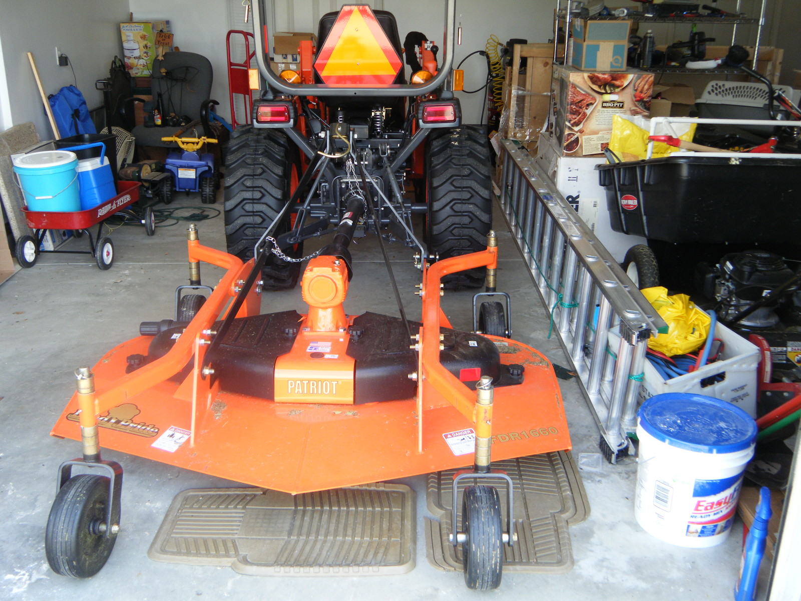

Kosby - Can you post some pics of your 3200 w/out the FEL on? How many hours you got on that puppy? Looks emaculate.

More Green influence... I can't believe the FEL dis/connect is much different between colors. I don't think twice about removing mine whenever I feel like it - it's too easy. If you mow with the FEL on, take it off once and mow. You'll never mow again with the FEL attached! Yeah, a little oil drops out of the QDs, but I put a shop rag below the connects and wear latex gloves (don't like being oiled, and here come the Deere jokes...). Takes all of 5 minutes to be finished and put away. In hot weather, though, the oil can expand in the unconnected FEL hoses, making it near impossible to reconnect the QDs. I've had to resort to a block of wood and channel locks to depress the QD stop and release some pressure.
WARNING: If you do that you MUST wear eye protection. MUST! It will spray everywhere - soaking you and whatever is around you. And it sprays hard - it's under a lot of pressure, and don't think you can cover it with a rag and be safe. You just do not want that oil going into your eyes under pressure... I've found it best to reconnect in the early morning, before everything heats up, if you keep it parked outside in the sun (like I do).
