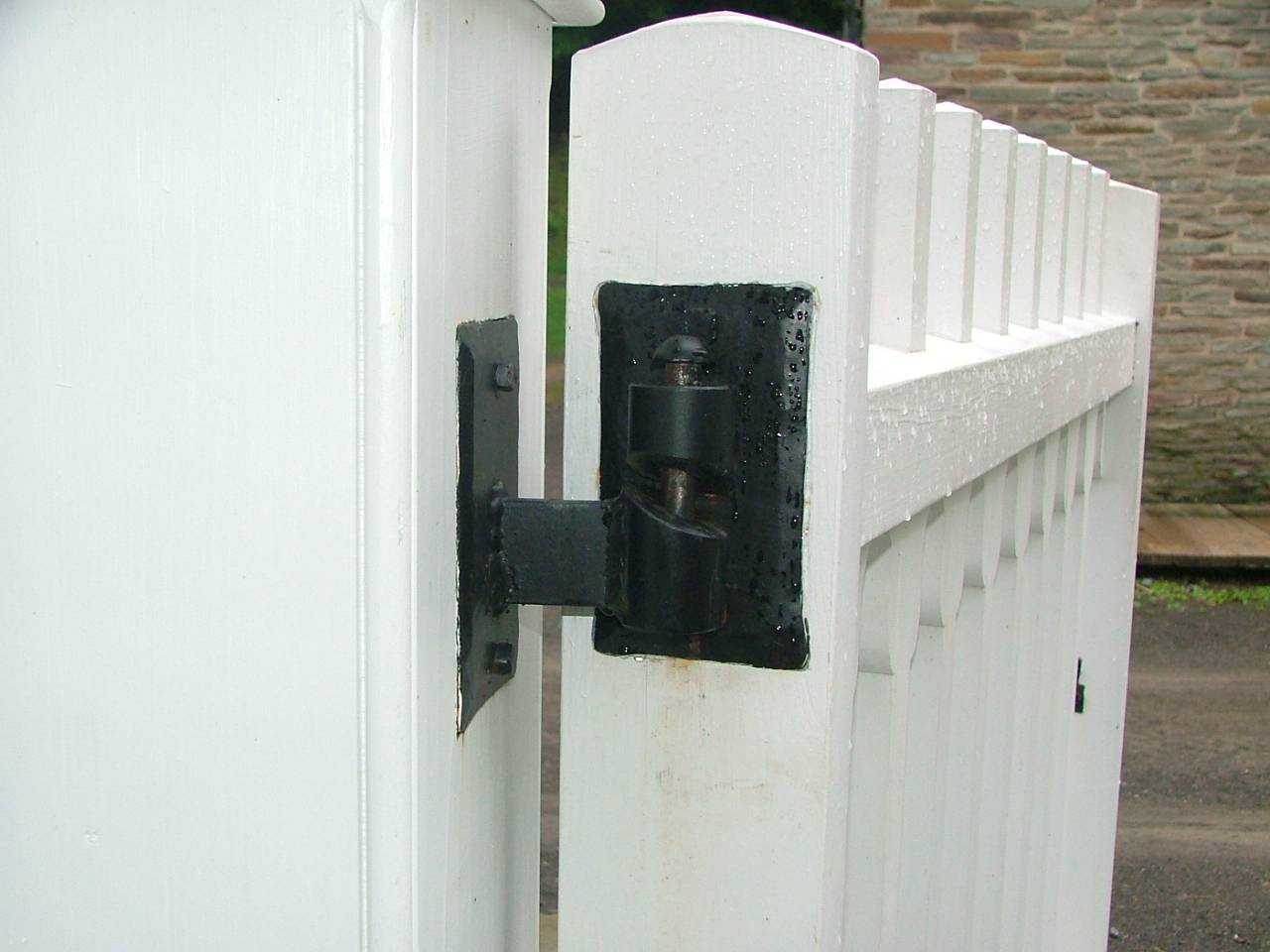

spring hinge on the gate, available at lowes.

If you are only opening your gate 90 degrees, you can make a set of hinges that will make the gate rise on the outside, & lean in, when opening to either direction. Then the weight of the gate will make it close without a spring. Not sure how fast you want it to close.
To do so, make your hinge pins adjustable and stagger them from plumb when the gate is closed, but plumb & level the gate when closed. The more you stagger the top hinge pin from the bottom, The more the gate raises & leans when open & the faster it closes when turned loose.
If it has to swing both ways there used to be pretty common self centering gate hinges that looked pretty much like the ones you have, except the strap part had an upside down V notch in them so when the gate opened either way, it rode up on the V, then gravity returned it to center to close. Of course both hinges have to be positioned with the L up, like your lower hinge. Maybe they don't make them any more because I couldn't to find a photo of them. They'd be easy to make from your hinges but would wear out faster than the old heavy duty ones I remember.

Here's a photo of a similar one but the whole hinge is cut at an angle instead of just a V notch.
