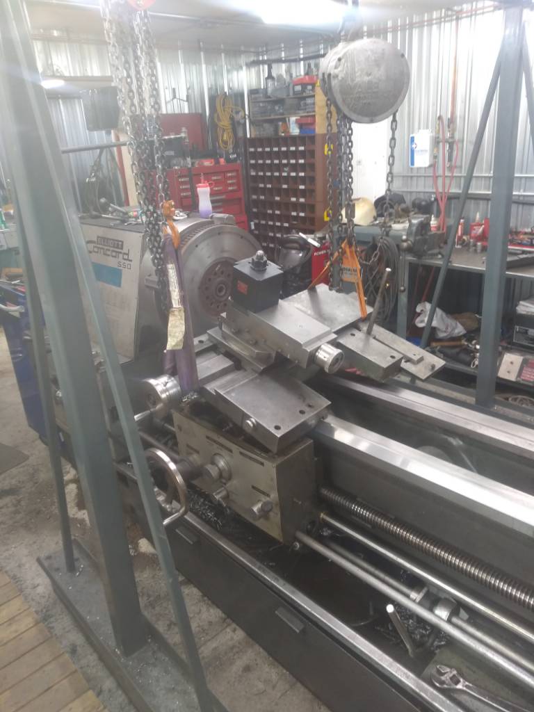

Another recent PITA.... Bearing went in the apron gearbox. Better part of a day to tear it apart and fix. This winter when it slows down enough I want to pull the entire headstock off and fix an oil leak. IMG_20201008_124640724.jpeg

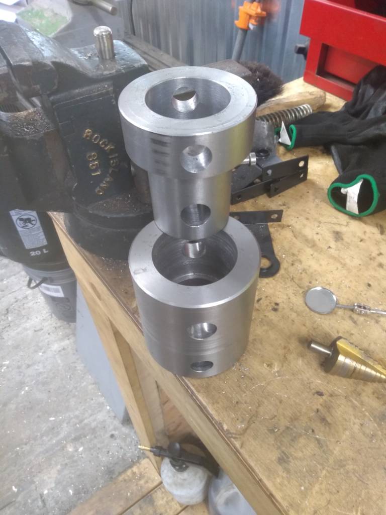

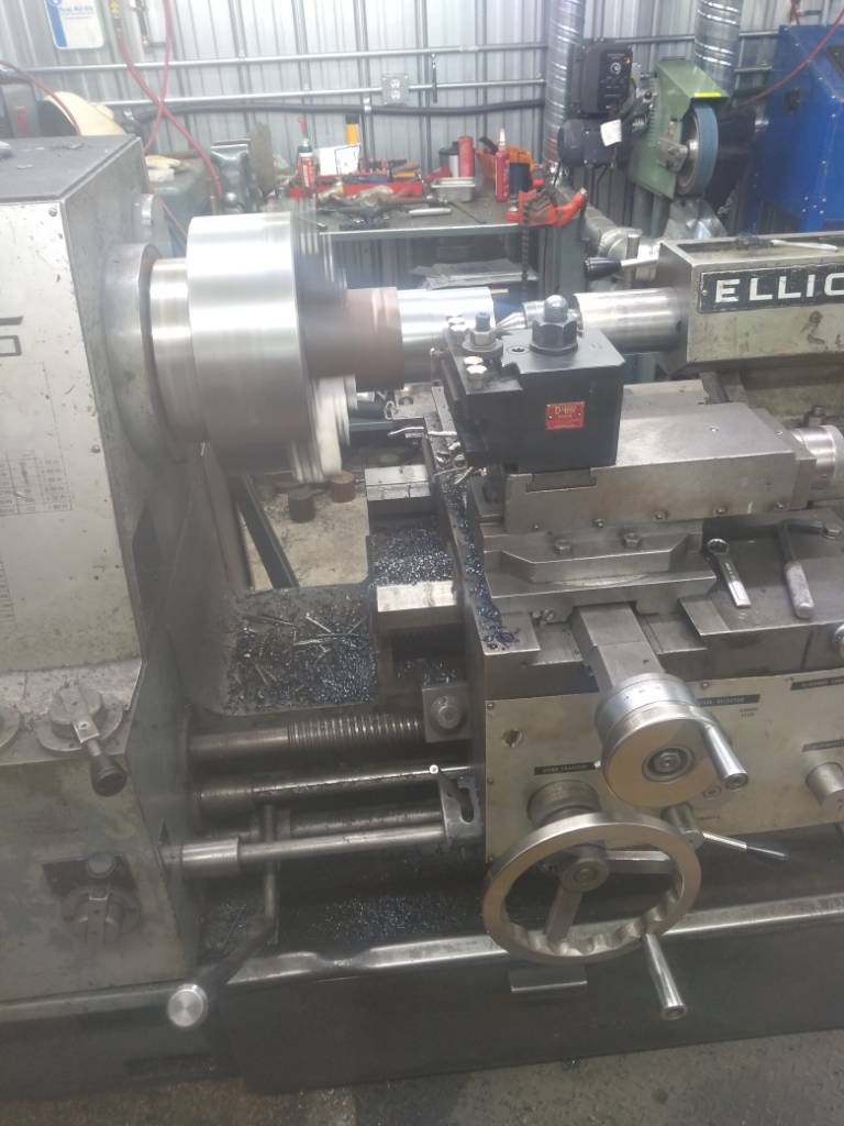

Another recent one. A bit of reverse engineering on what used to be a shaft coupler on a disc that was no longer available. Started as a length of 5" round 1045. These jobs are where having a nice heavy lathe pays off. View attachment 674460View attachment 674461View attachment 674462

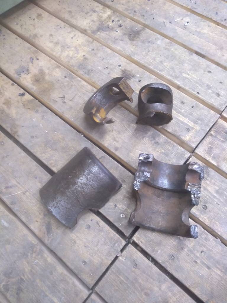

That’s the big brother of a job I’m contemplating right now-I’ve a Deere model 31 hydraulic auger that some dipstick welded the a 9” auger to the coupler-can’t find a new, used or reproduction coupler for the auger drive anywhere so I may have to make it. It will certainly tax my nearly non-existent machining skills but I’ll certainly learn something.
How did you reverse engineer the damaged coupling? Just eyeball and experience? Or did you have some drawings/plans for the original design?

Basically I was given those parts and a napkin sketch with some rough dimensions of what it needs to attach to. Just one of those things you sort of figure out how to do after doing it enough times.
Do you have a picture of what you're dealing with? I've had to do a few emergency butchery repairs in fertilizer augers for one of my customers before. One of them we were able to weld on a small U joint off the shelf from a parts store in place of the original coupler.

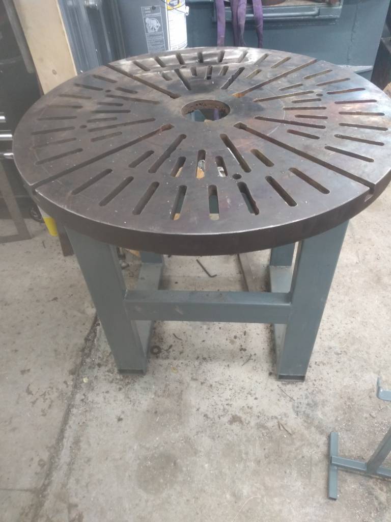

Here's my new welding table. Been using it for a bit now and I'm incredibly happy with it. Frame is 2x4x0.125 tubing, and the top is a spare lathe faceplate I had. IMG_20201027_145114517.jpeg
/ Reintroduction and project thread #18
That’s a great idea, luv the slots for bolt up fixtures
#19
I had wanted an acorn platten for years but never found one.... Had this spare 40" faceplate and finally decided to just make something.
It's really been nice having the slots, also being cast all the spatter and such doesn't stick

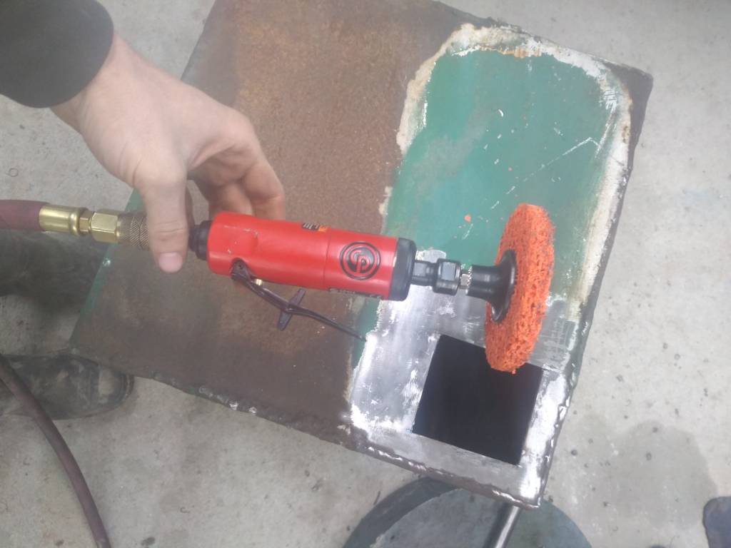

First one is a product I highly recommend. Norton blaze rapid strip wheels. Absolutely magic at removing paint, rust, and mill scale. Next up is a pump housing at the start of being rebuilt.IMG_20201101_101737495.jpegIMG_20201104_103121049.jpeg
