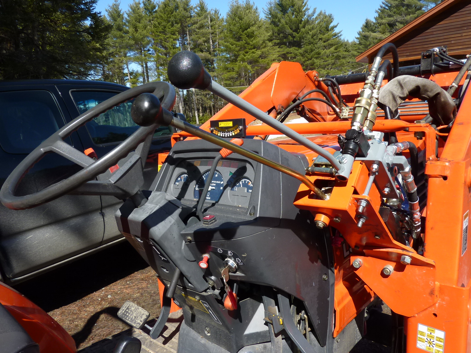

Finaly had a chance to look at the solenoid valve. It is made by NACHI. Spec is here:
http://nachihydraulics.com/pdf/Nachi_SK-G01.pdf
It is a tadem type, interestingly the pressure rating on the T port is >3000 PSI.
I'm still trying to figure out if the base is standard. The spec has dimentional drawings. Anybody familiar with standart base dimensions that can confirm this solenoid mounts to a standard base?
I guess the thing to do is to look at another brand of valve known to fit standard base and compare the dimensions. I'm working on this.
I'm hoping I can simply buy another brand of solenoid valve with similar spects and just swap it and see.
