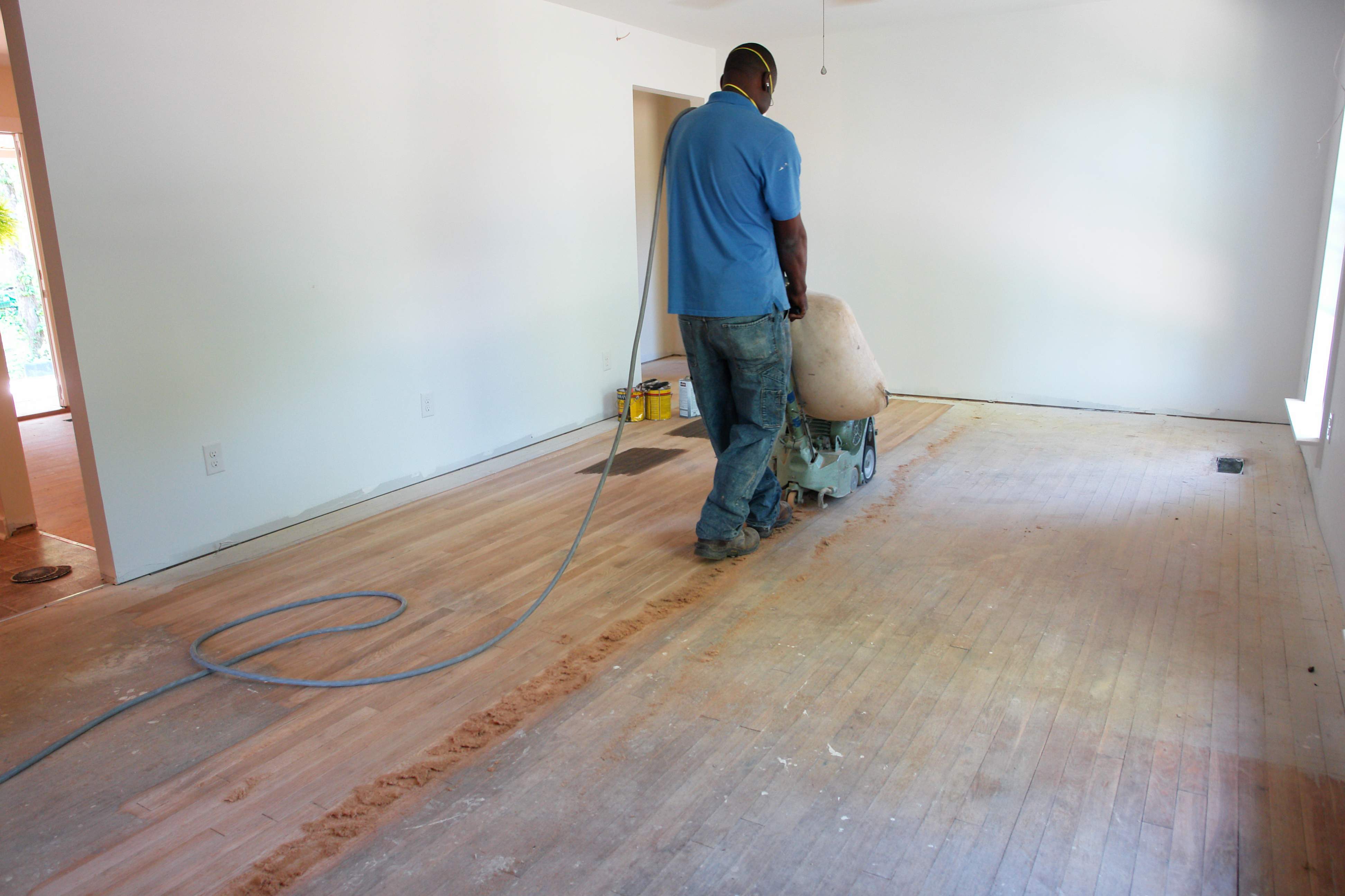

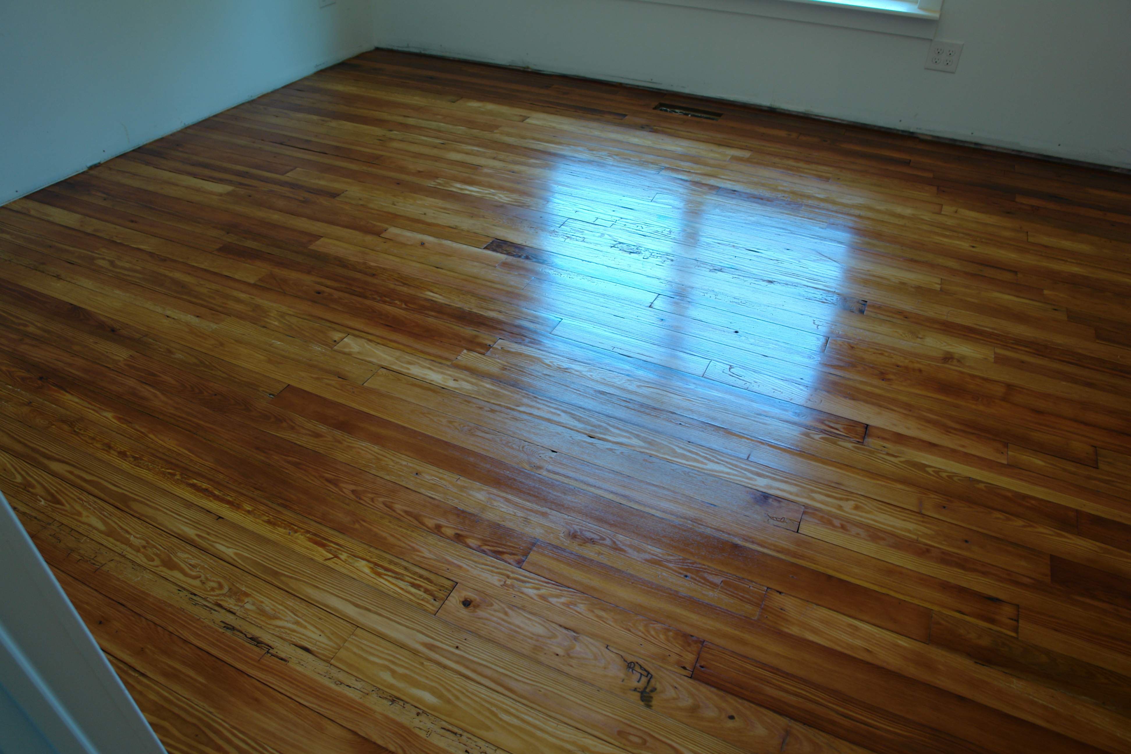

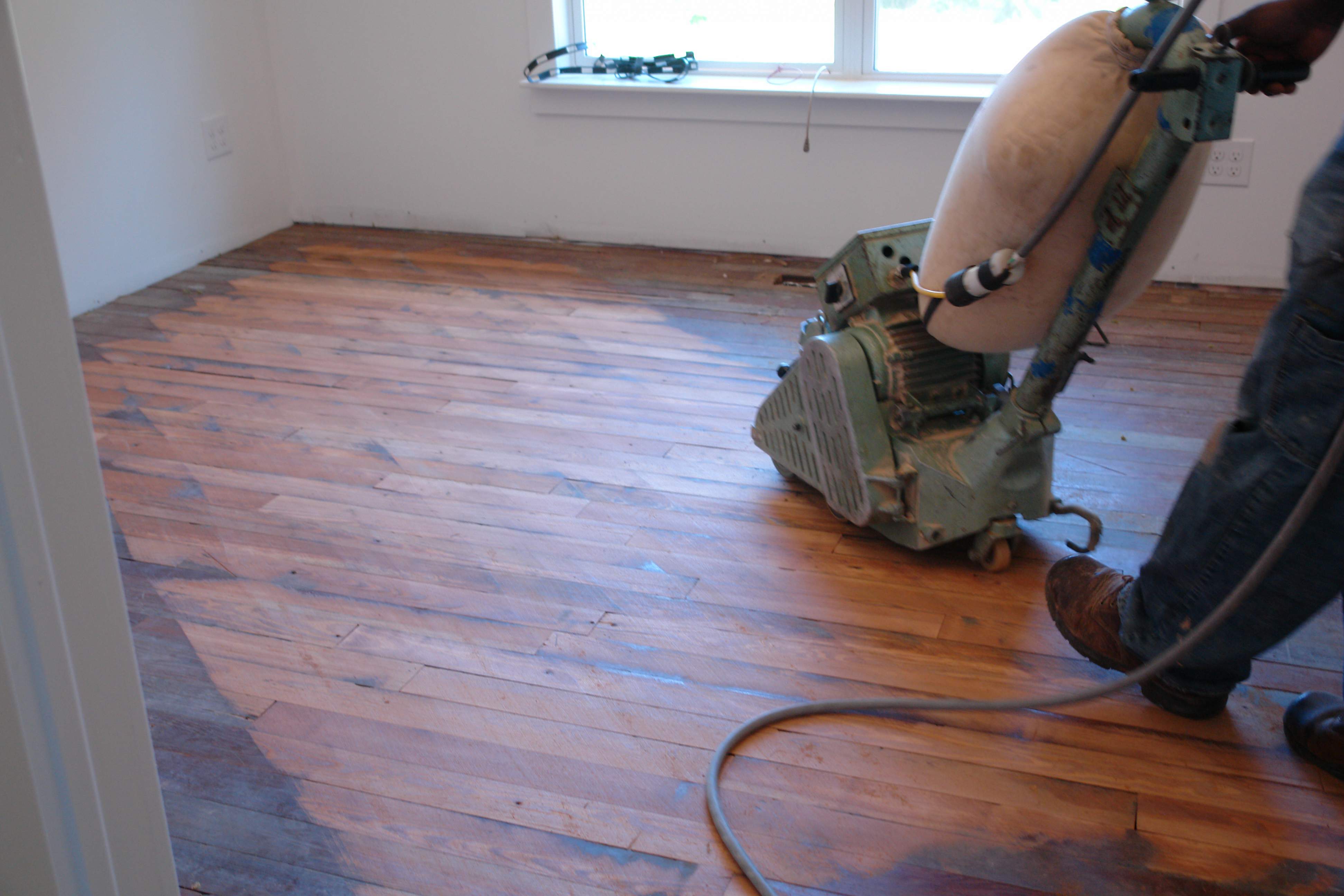

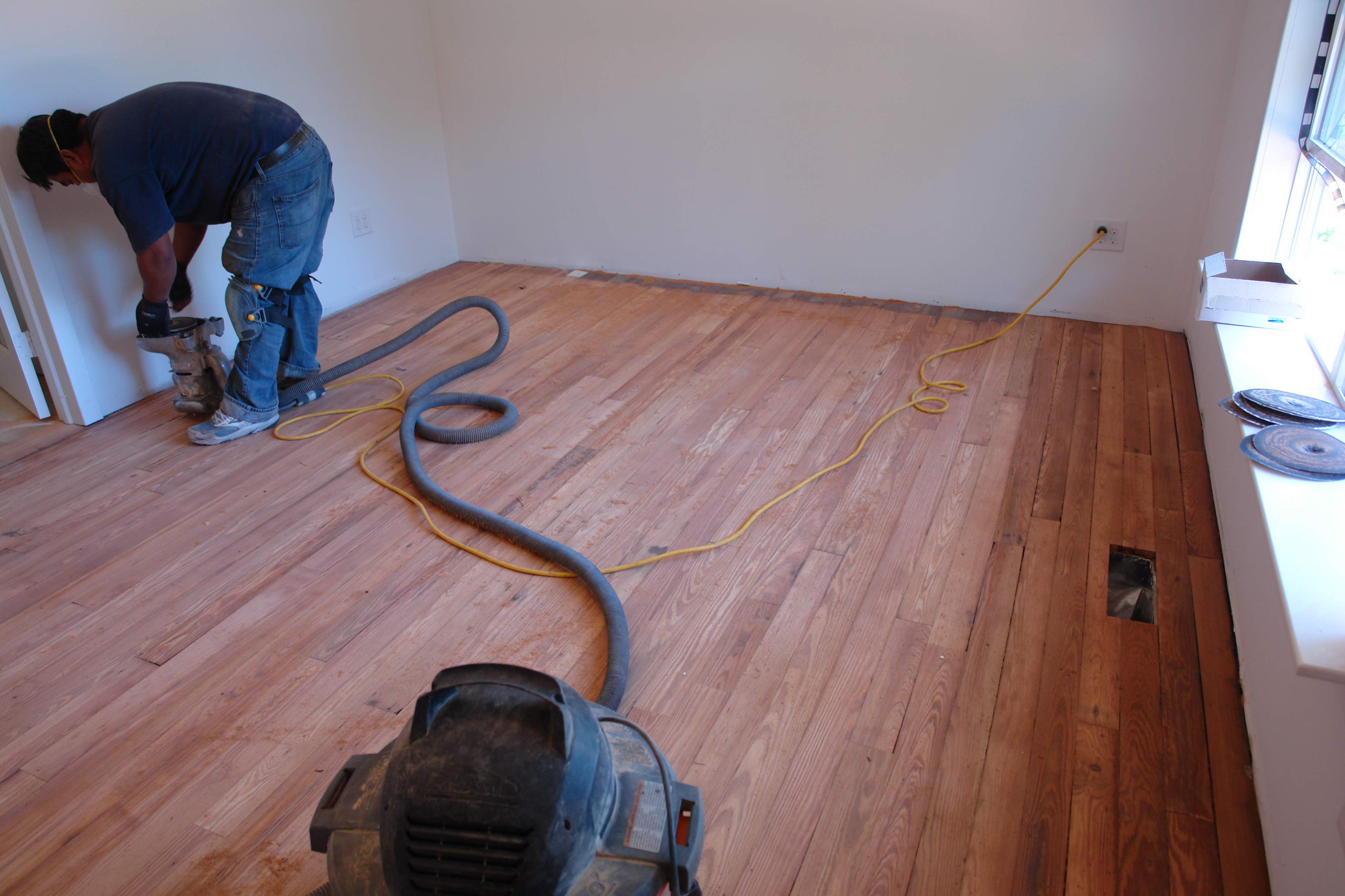

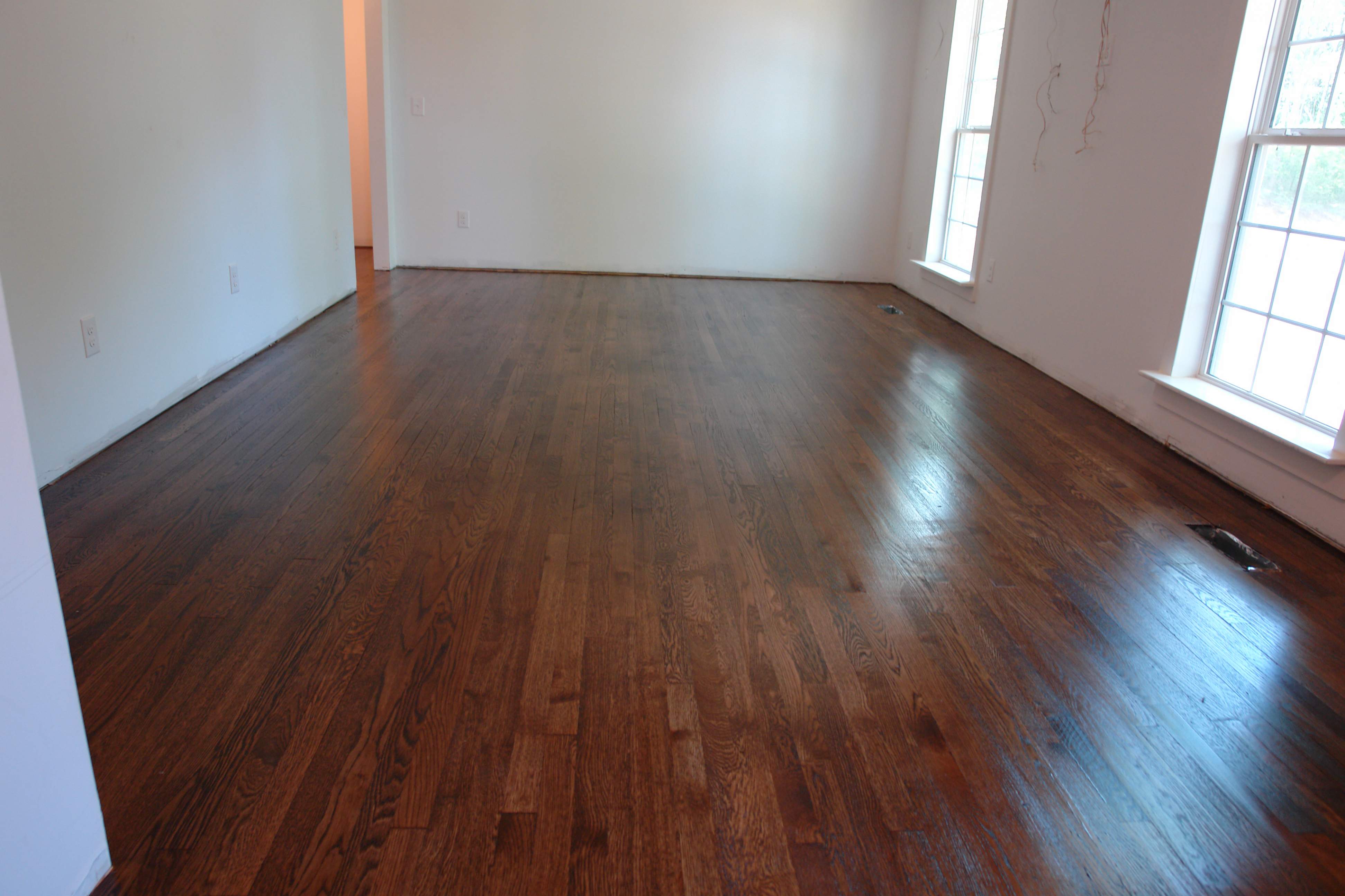

DSC03507.jpgDSC03492.jpgMy wife and I have had the hard wood floors refinished in two of the homes we currently own. I hired it out to flooring professionals both times. The last house we had done just this spring, was a rebuild house. 60 year old white oak floors that had layers and layers of wax on them, pet stains, water damage and we also tore some walls down and put new walls up in different locations. The flooring people came out, popped out the water damaged flooring and put down new solid oak flooring. Same thing with the new construction area. They then came in with a large drum sander and a vacuum system. The vacuum system is not only key for keeping the dust down, it sucks up all the dust accumulated on the floor from the previous swipe and helps keep the sand paper clean. After 3 passes at different angles with the drum sander to make sure no strips were sticking up higher than the other strips, they had a screen sander that they used to smooth out the wood grain. Being that there had been pet stains all over the floor, which had absorbed into the wood for many years, we decided to stain the raw wood before sealing it. The floors came out wonderful. A 1450 sq.ft house we had completely redone for about $1500.00 dollars.
