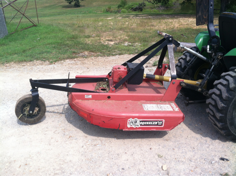

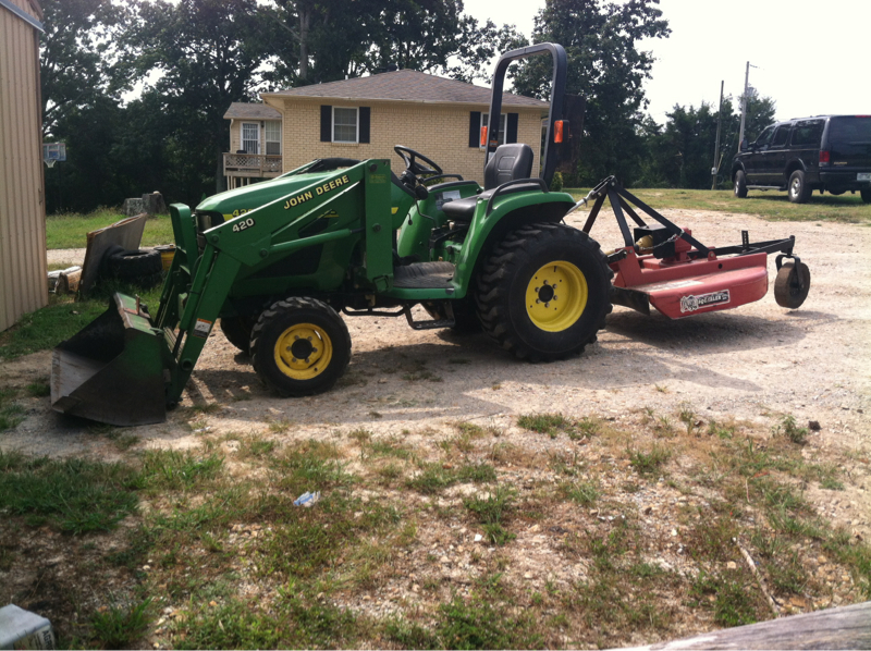

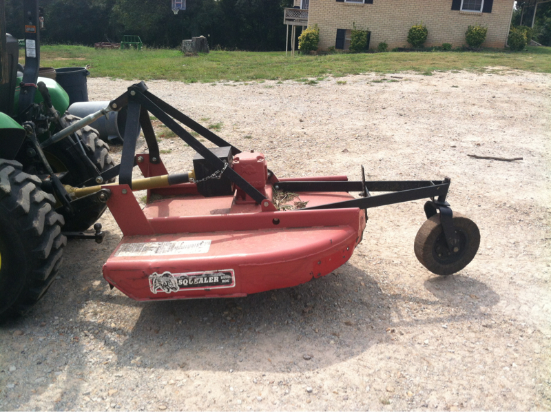

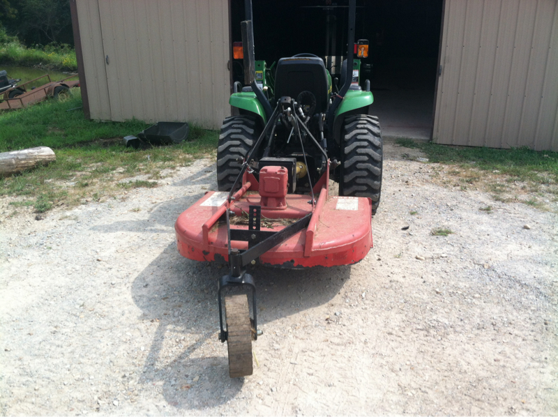

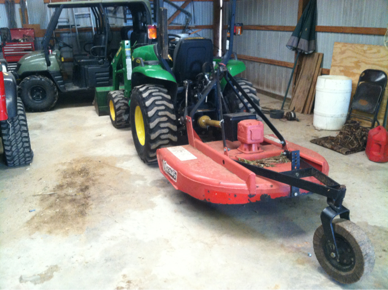

Here is my 4 foot bush hog brand cutter, it weighs 455 pounds, it is attached to my 4200 Deere tractor which is not much difference in size if I remember correctly . It is rated for 15 to 30 pto horsepower. It was 800 dollars at my local case dealer new. The tractor handles fine with this cutter. It is being a good cutter and does more than it is supposed to. By the way the tractor is only 20 on the pto. Hoe this helps. LUTT
