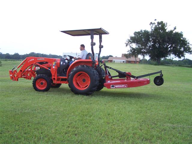

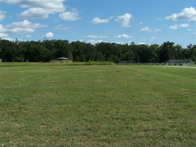

My 5 acres is part of a subdivision of lots between 5 and 20 acres each. It was a dairy farm at one time and was primarily Penasacola Bahia. Those that are not maintained become over run with briars and weeds. However, if it is mowed regularly, the Bahia comes through. I am mowing mine weekly now that I have my tractor, and it it has been mowed regularly over the past 3 years. It looks great. I think the cheap (and fun) way out is to mowmowmowmowmowmow.

Rick - that place looks really great - what grass is that?
