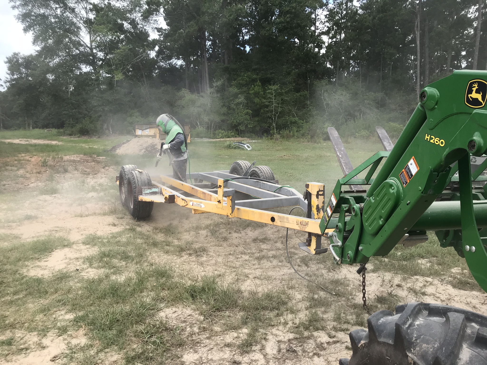

I didn’t get any pics last night. Was out till 10 spraying, trying to get it down before the storm that’s here now. It’s coming along. Will be like a new trailer soon. I’ll try to get some new pics tomorrow. My shop is a wreck after this project. Need to pick up some more oil dry already

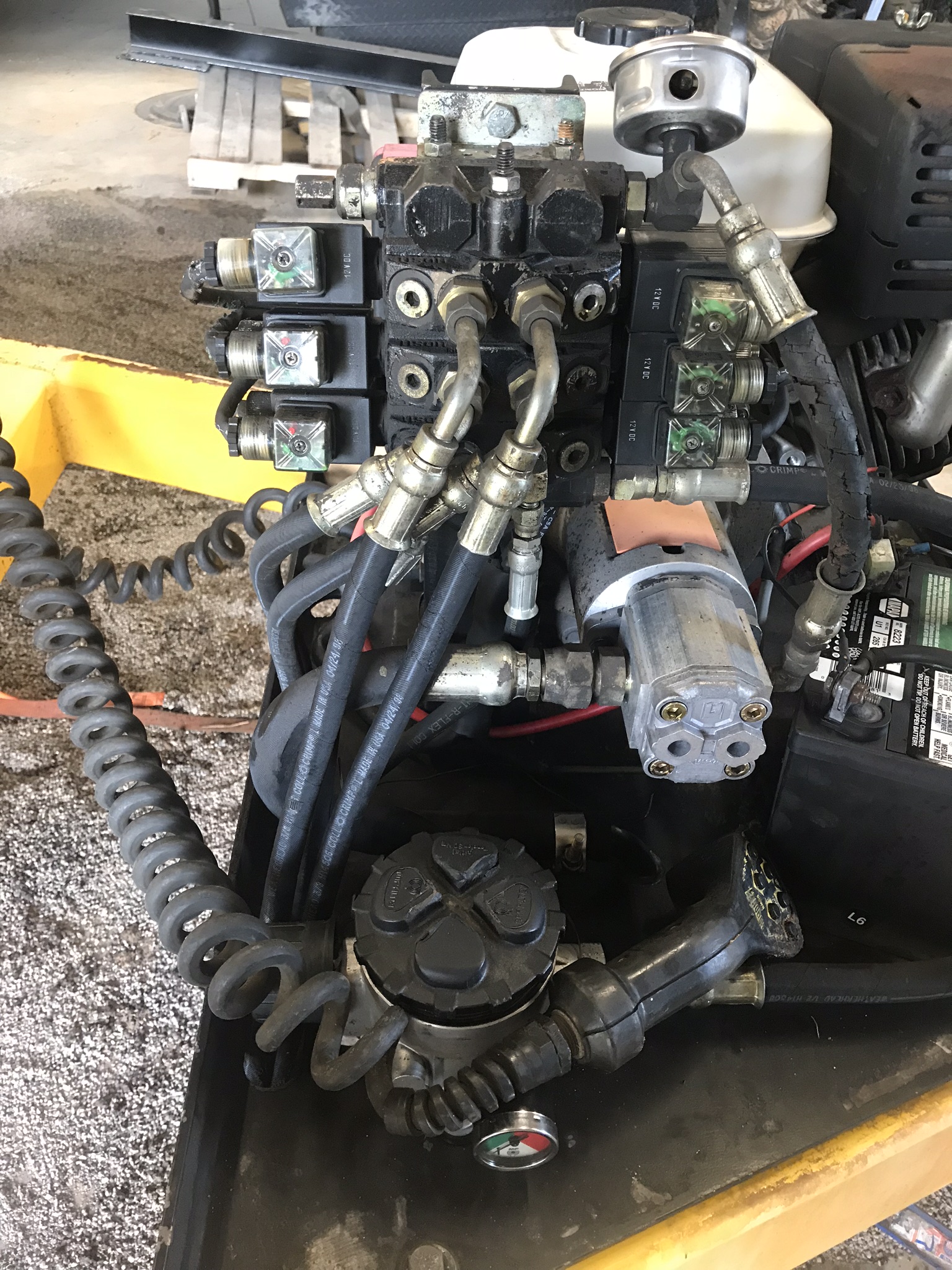

I知 ready to wrap this project up. Tired of messing with it and spending money on it. Still haven稚 gotten the money from my dump trailer but oh well.
So far we致e done
Sandblasted Trailer
Primed and paint
Installed all new led lighting
Brand new load range h 18 ply 17.5 tires and wheels
Removed and installed new fenders
Ordered all new hyd hoses
Changed pump oil
Bought 15 gallons of hyd oil
Build new pins
Built custom hook for the haul line after dropping a box
Hopefully I can get the bed on it tomorrow, run all the hyd lines and install the pump. If everything goes good it値l be just about done!
I knew I needed to rebuild one cylinder, ended up the snap ring was seized in there so took it to the hyd shop, $300 later it was good to go. When I picked it up I asked them to test the other one too. It was blowing oil everywhere. That was another $200.

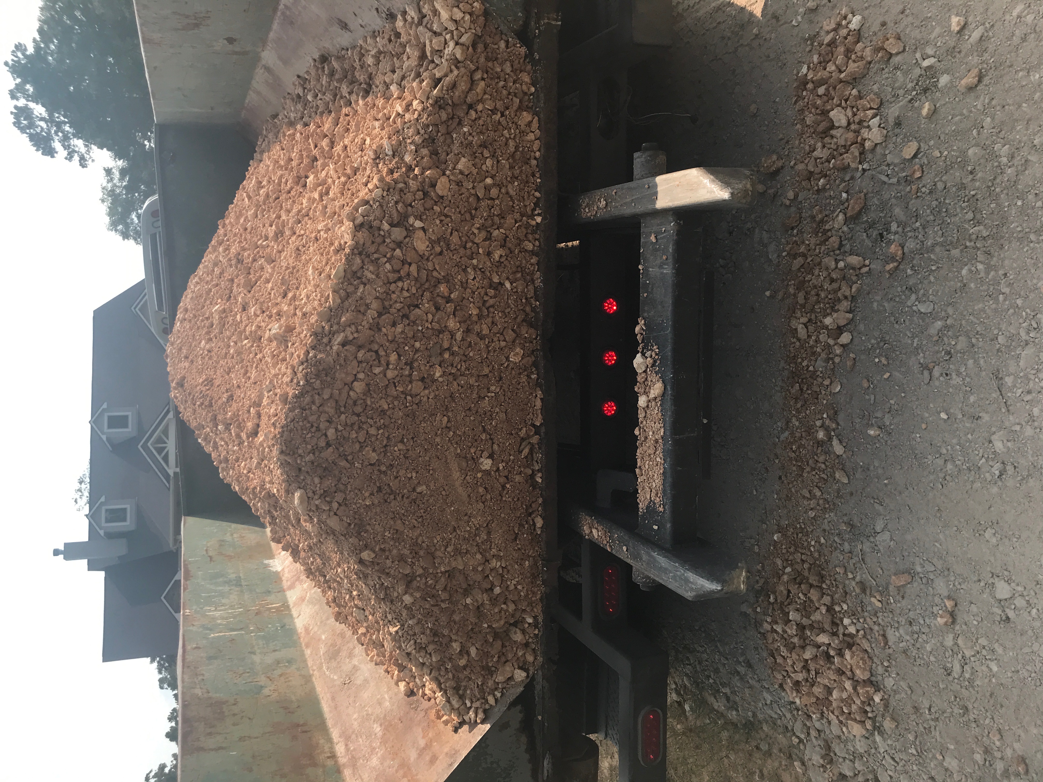

First trip to the dump went well. Went in around 18k lbs and out at 15k for a total of 3k in the one container. These have been sitting for 2 years so I have no idea who’s stuff or what stuff is in these. Loaded up with road base for the ride home and left the dump at 26,880 lbs. drive home was uneventful but I need to order all new brakes. I have zero brakes and the running lights don’t work. I’m assuming it’s a ground issue. Will work on that soon.

I need to get some more pics. Hauled another load to the dump today and brought back nearly the same as the load on Thursday. I think I was within 100 lbs with a different size box. 3 buckets from the track hoe is the ticket to 11k of rock.
Figured out the running light issue, there a bad connection between two lights that kills them all down stream. I ran a jumper wire and back fed the other direction. Everything is good but I might cut the bad section to make sure it won’t ground out. Problem is it’s ran inside the frame completely and can not get access to where it is.

Took another load to the dump but stopped off at a real rock place for a load. Total rock came out to 13k and gross was 28+k lbs. dumped it easily. Loving this thing so far. New plasma came in and miller 252 will be here Wednesday. I値l start working on the boxes and making them into something I can use. I値l pull the best two for use as a container and the rest will become flatbeds or sold. Could get 1000-1500 out of each of them I bet. They need a couple hundred in welding but new are 4K
