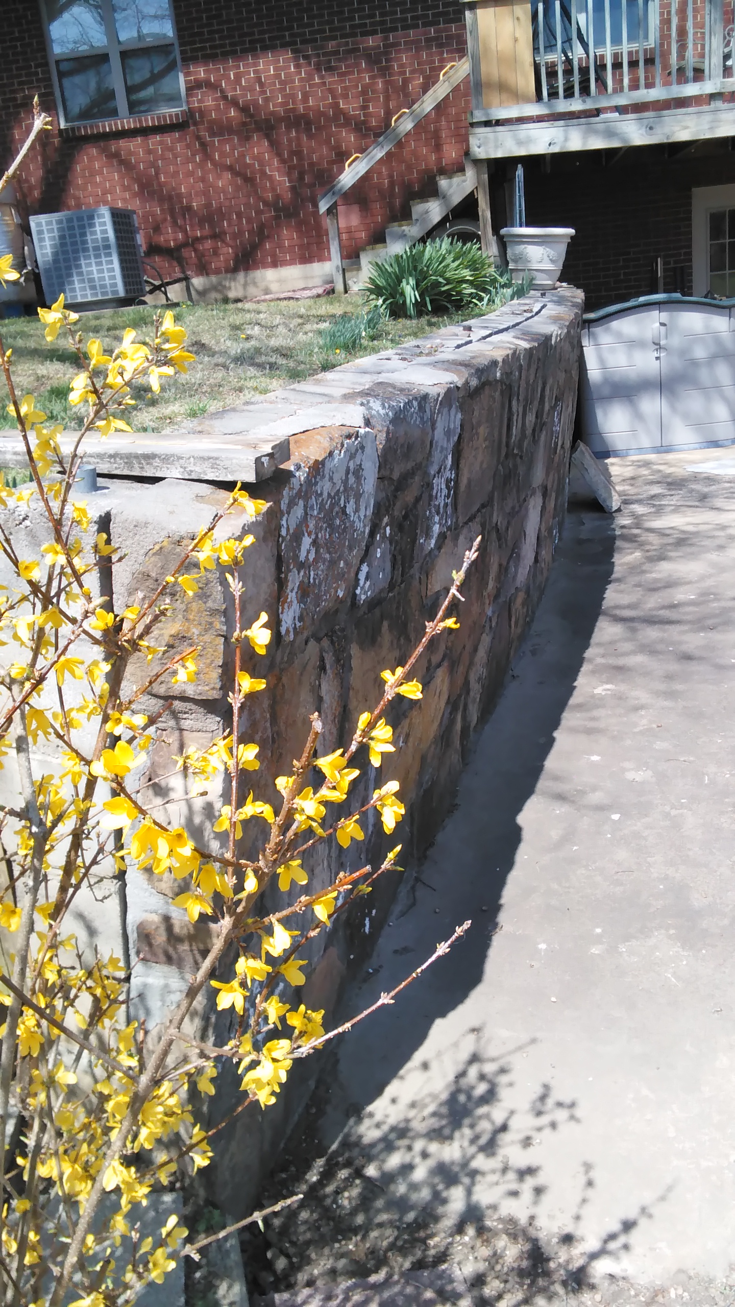

The old wall has been there about 50 years, and I think it started failing when the former owner replaced the sewer line about 25 years ago and had a back hoe working only a few feet from the wall. The sewer line is deep and goes under the far end of the wall. I have had the place four years, and the wall has leaned about two inches more since then. It's along one side of the approach to my walkout garage-basement. The dirt level is from 8 to 12 inches below the top of the wall. The part within ten feet of the concrete garage wall is thicker and barely leaning at all. The new wall will need to be 48-50 inches tall. The old one is 58". Here's a picture.

its hard to tell from that picture but it looks like the wall is ending under the deck and you may have a problem with the post there that is holding up the end of the deck.......I'd guess that the footing for that post does not go down to the bottom of the wall so when you remove the wall theres a good chance you will undermine the soil that the footing is bearing on.......general rule of thumb is if the soil within a 45 degree angle from the bottom of the footing is disturbed it has compromised its bearing capacity......if that is the case it's not a big deal you would just have to remove the footing thats there and install a new sonotube down to the level of the bottom of the wall and fill with concrete up to the post.......Jack

That post does not have a footing. It's a 4x4 in a hole in the ground that a contractor for the previous owner installed. I have already dealt with the other supports for that deck a couple of times and have fixed the problems there. I am planning to temporarily support it with a post on a spanner from the top of the wall to hard ground until I replace that support with a 4x6 ground contact treated support that goes onto a footing at the base level of the wall. The wall is barely leaning within 10 feet of the house, is thicker there, and in no danger of toppling at that point.

Are there no drain lines coming out the end ? Or at least indications of drain hole every so often in the rock wall ?

There are a couple of 4" pipes coming through on the inside, but they are stopped up with dirt. The previous owner likely compromised the wall by re-doing the sewer line that passes under it, (backhoe pads right by the wall) and by allowing a 6" holly tree (I removed stump four years ago) to grow about two feet from the wall along the middle of the span. Handrails are not an issue. I'll put a 36 inch welded wire fence above it if necessary. I think it will be one of those walls that steps backward with each tier.
Yes, It's a shame. The wall on the other side of the walk out is still almost perfect, and it's taller, with a fence to prevent falls.
The one that is failing is actually a concrete block wall with a rock veneer face.

The first ten feet or so out from the house is more substantial and only barely leaning, not in any danger at all. I am hoping to somehow tie into that and not have to mess with that part, which is the trickiest, since it involves a deck support. Maybe take the veneer off that part and match it with a new wall on out from there. It's a concrete block wall with native rock veneer about six inches thick.
