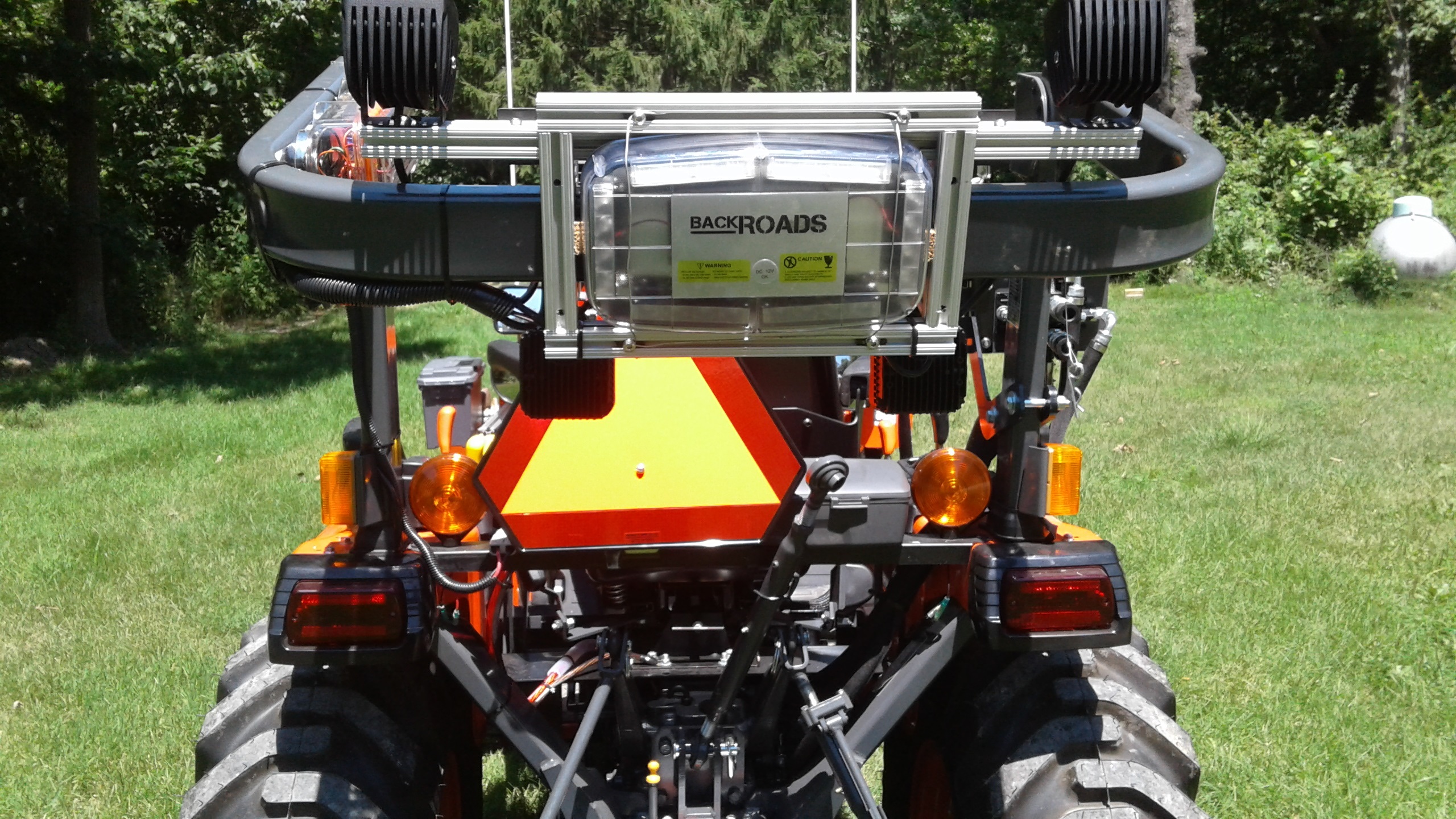

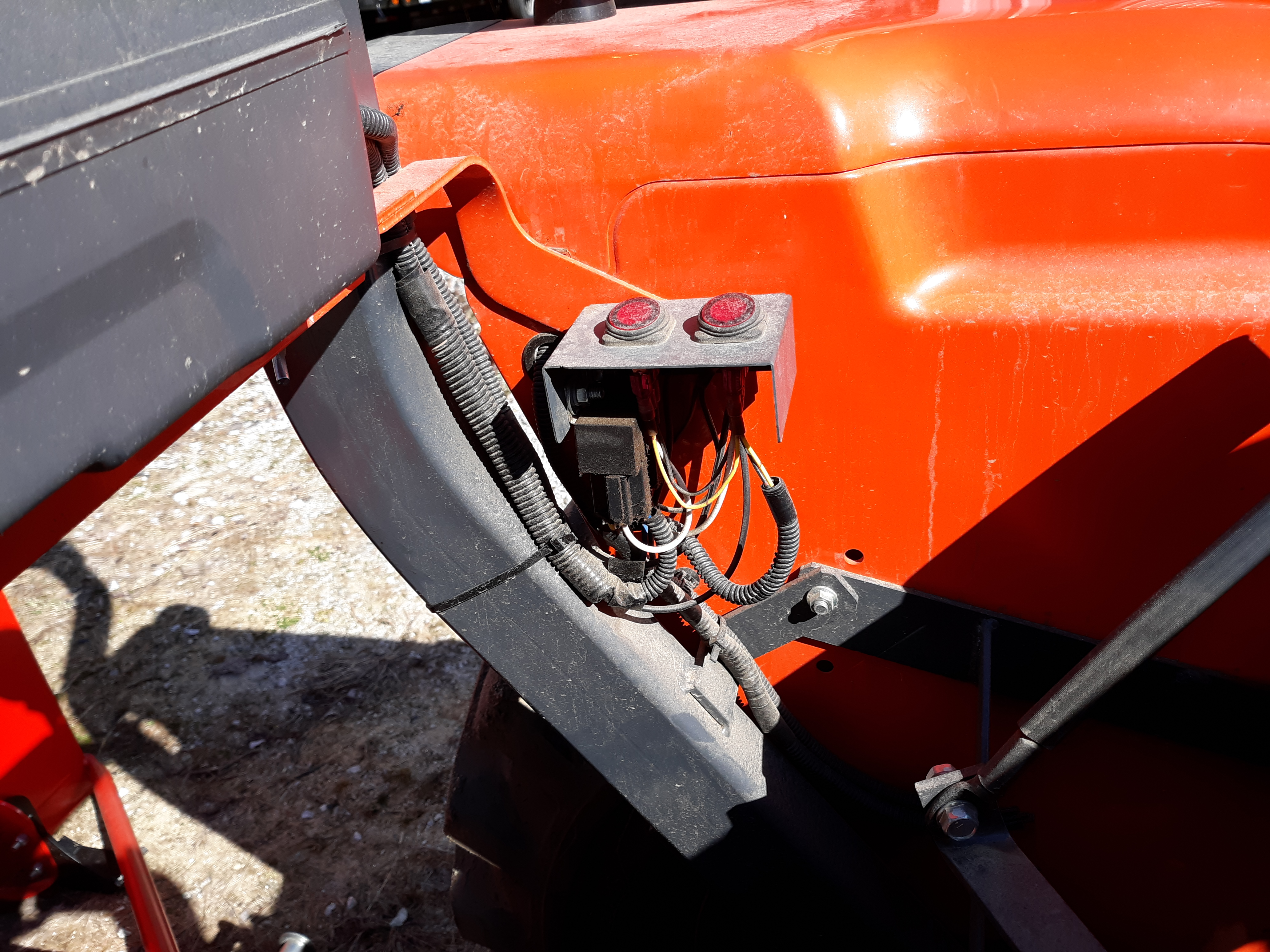

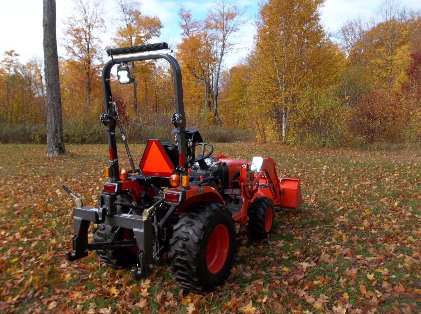

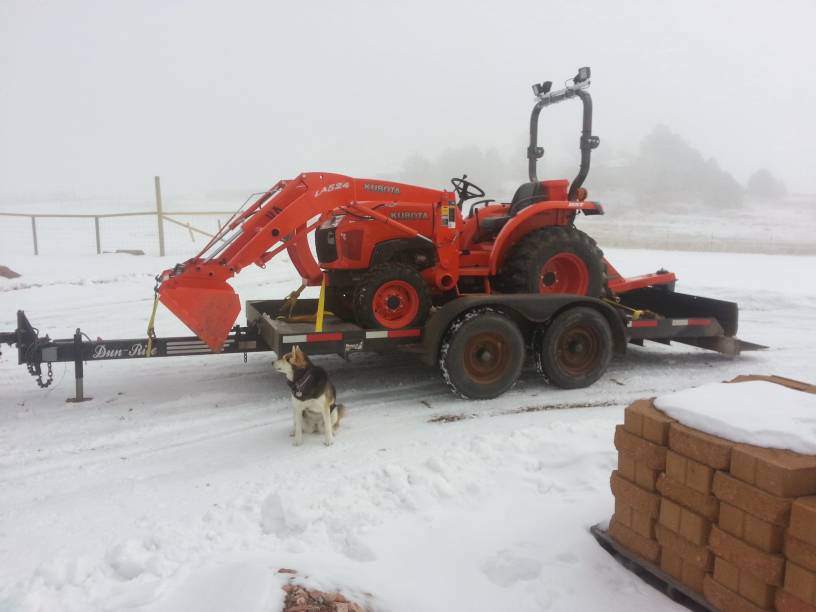

I used some PVC pipe pucks as spacers & clamped a pipe over my ROPS. Drilled holes in that bar & put generic LED cubes on it. I wanted to securely mount things but not modify the ROPS. Was some random towel rack square pipe or something & a couple square U bolts so dead easy.
Forget where I wired it to, under the dash somewhere as I put a switch on the dash. All the Kubotas have a ignition switched plug under the left (standing behind looking forward) fender. Its 10 or 15 amps, plenty for 4 LED cubes.
The plug is either the male or female Original 2 pin Power connector for VHF/UHF Power cords - Power source side | Powerwerx. Common ham radio plug, but it's hard to figure that out & not well documented. You still need a switch or 2 if you use that circuit. IMG_20140209_110007-3.jpg

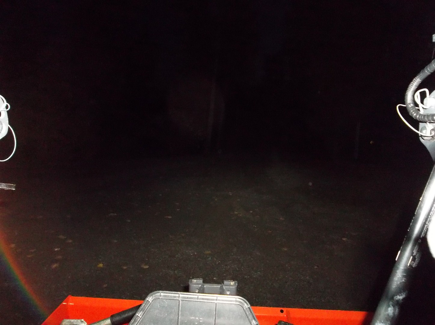

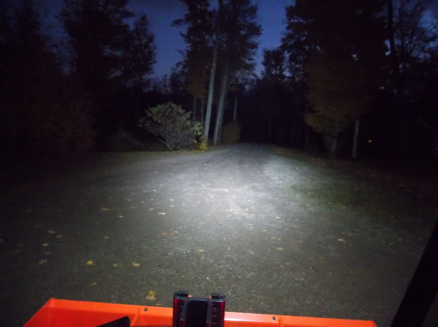

I have just this single 80W LEDworklight on my tractor. Very little current draw.
Pics show the halogen worklight my dealer put on, versus the LED.

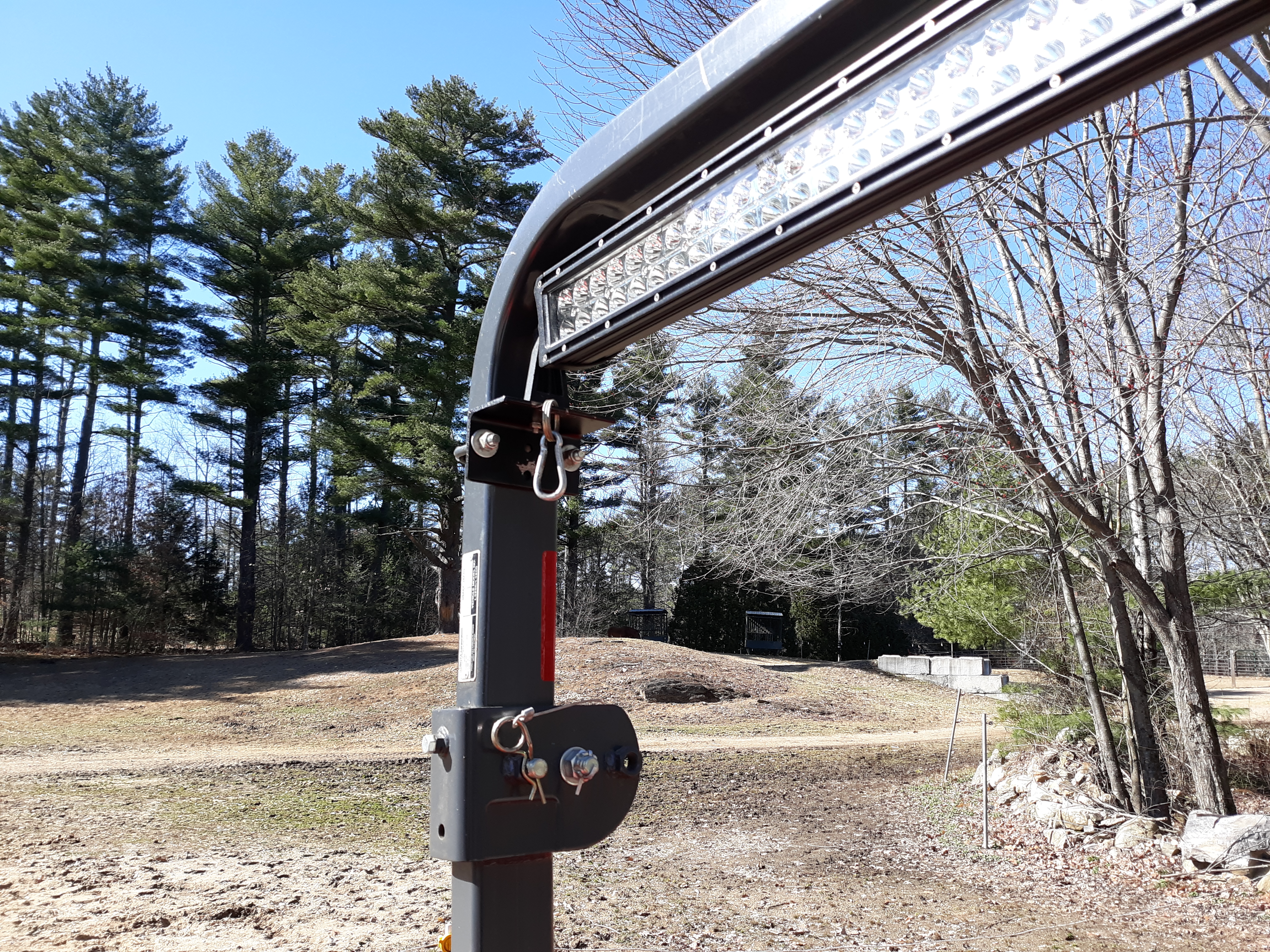

I documented my overkill led bar install on the L4060HSTC that replaced my L3200 at https://www.tractorbynet.com/forums/customization/376458-let-there-light-l4060-light.html. I love the light, but it was probably a bit overkill. I'd likely go with 4 8-10" bars & stock wiring if I had to do it over again just because it would have been so much easier.
At any rate those "300 watt" 40-50" bars only pulled half that at best on my bench top power supply. They were only $70 each or something. They were noisy RF wise & one leaks/fogs a bit, so you get what you pay for. They do provide massive light though no matter how exaggerated the ratings are. So ya, most ratings are overestimated or flat out fraudulent. But they are still better than halogen bulbs on most measures.
