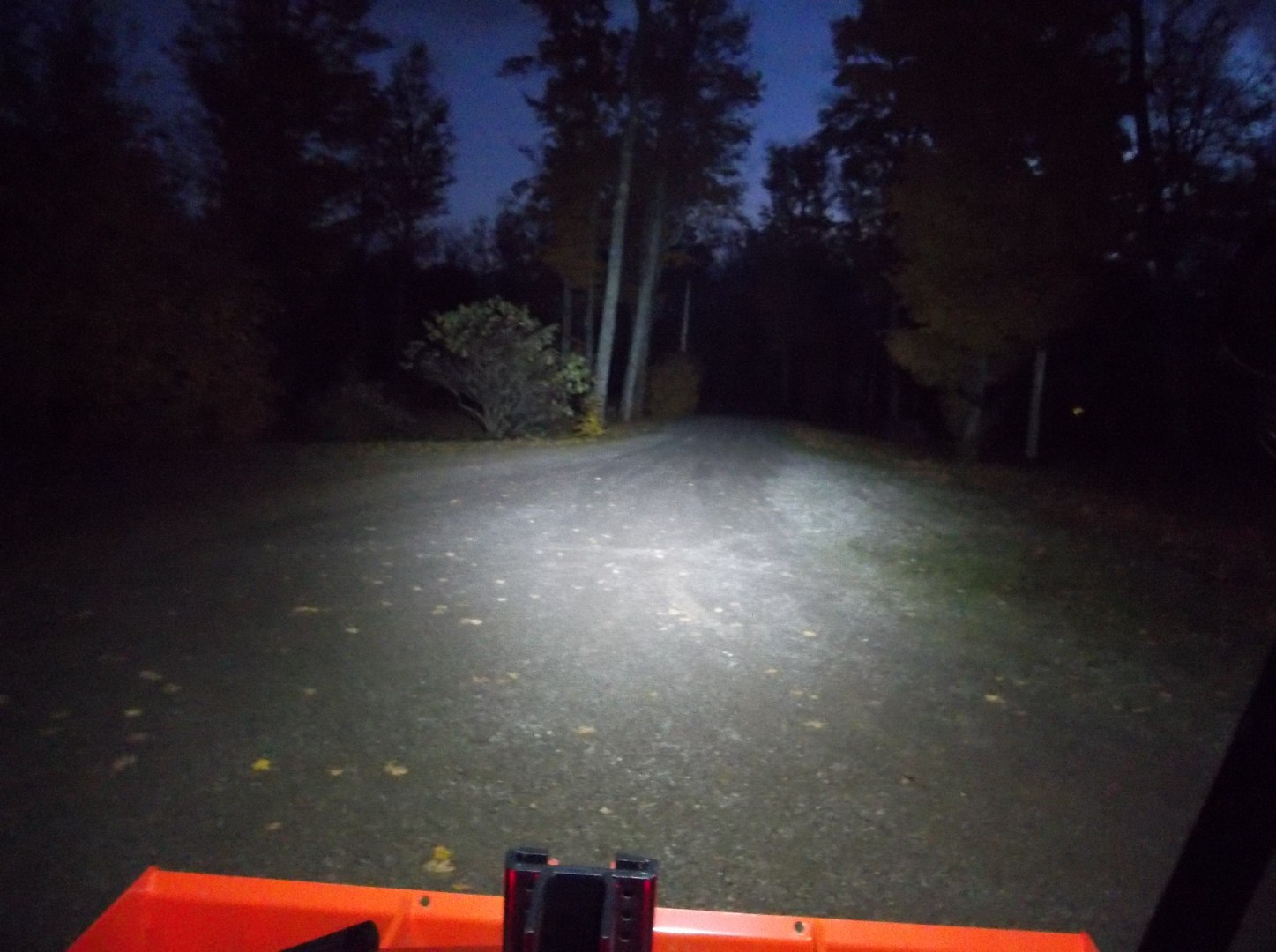

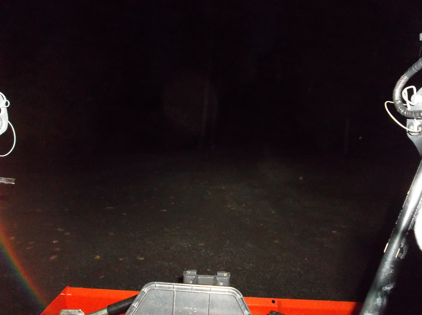

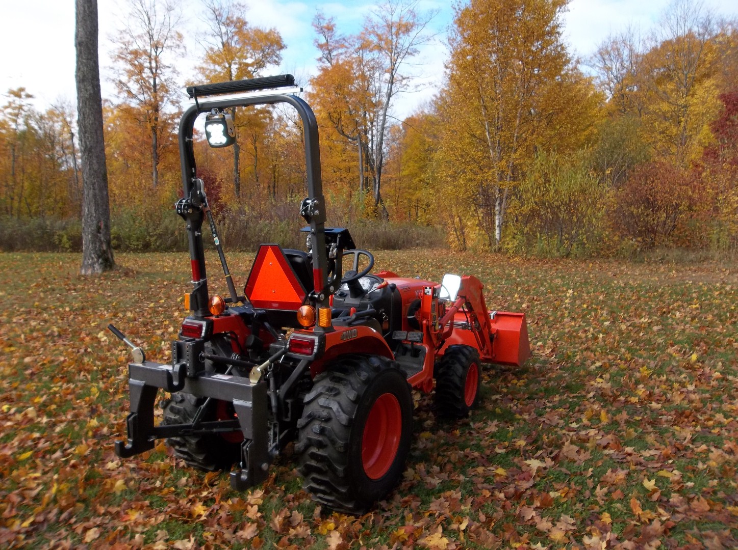

I have just this single 80W LEDworklight on my tractor. Very little current draw.
Pics show the halogen worklight my dealer put on, versus the LED.

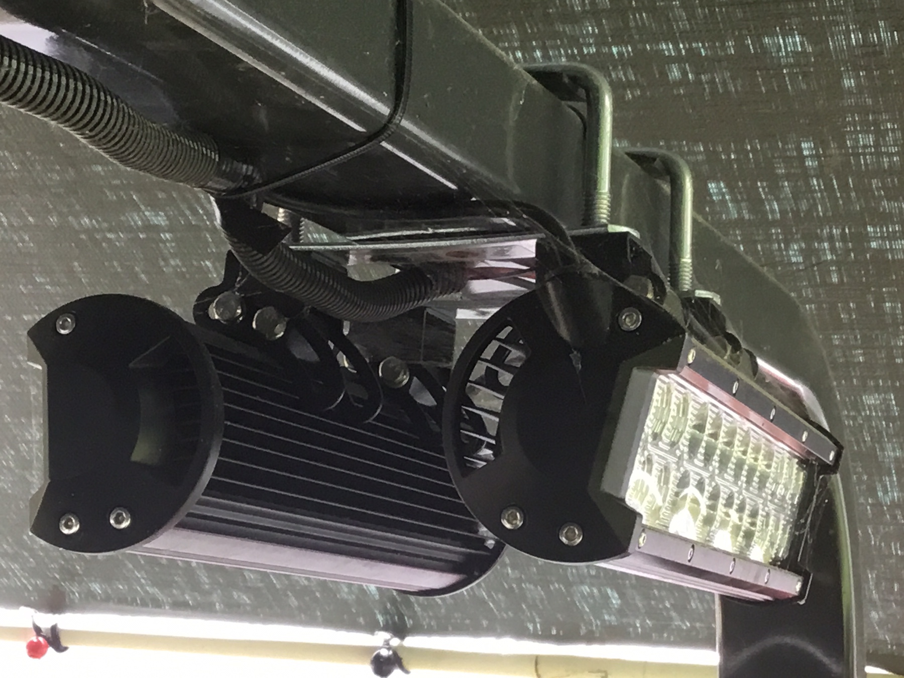

I documented my overkill led bar install on the L4060HSTC that replaced my L3200 at https://www.tractorbynet.com/forums/customization/376458-let-there-light-l4060-light.html. I love the light, but it was probably a bit overkill. I'd likely go with 4 8-10" bars & stock wiring if I had to do it over again just because it would have been so much easier.
At any rate those "300 watt" 40-50" bars only pulled half that at best on my bench top power supply. They were only $70 each or something. They were noisy RF wise & one leaks/fogs a bit, so you get what you pay for. They do provide massive light though no matter how exaggerated the ratings are. So ya, most ratings are overestimated or flat out fraudulent. But they are still better than halogen bulbs on most measures.

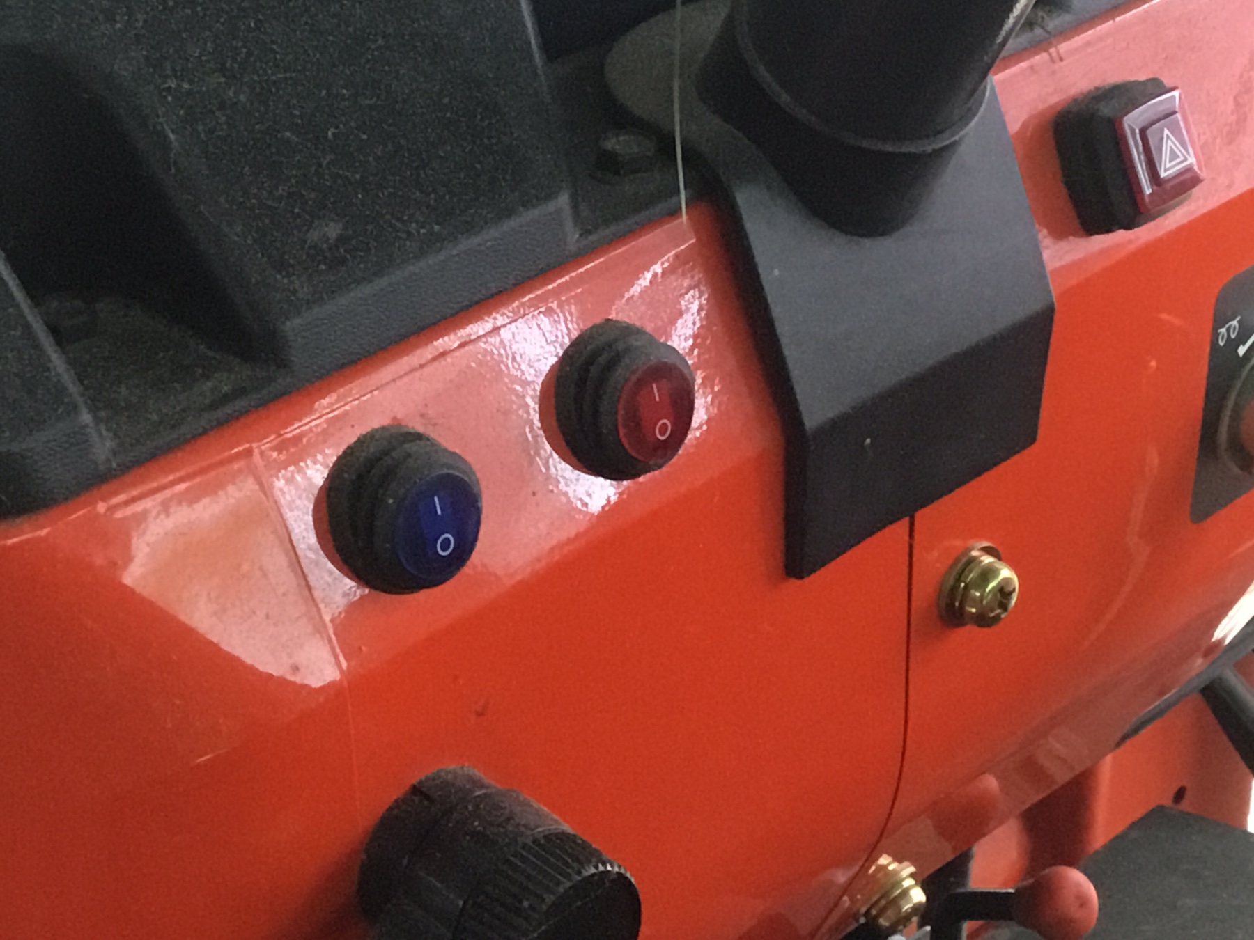

I added five 27 watt round LED lights to my tractor - 2 forward facing and 3 rear. I disconnected my 2 65 watt headlights which were basically worthless and the 5 new lights draw the same as the 2 original ones. Night and day difference in light output. I wired them into the factory headlight harness so I did not need to add any switches to the dash. Also added a flasher unit. 2 for $15 or 4 for $30.
