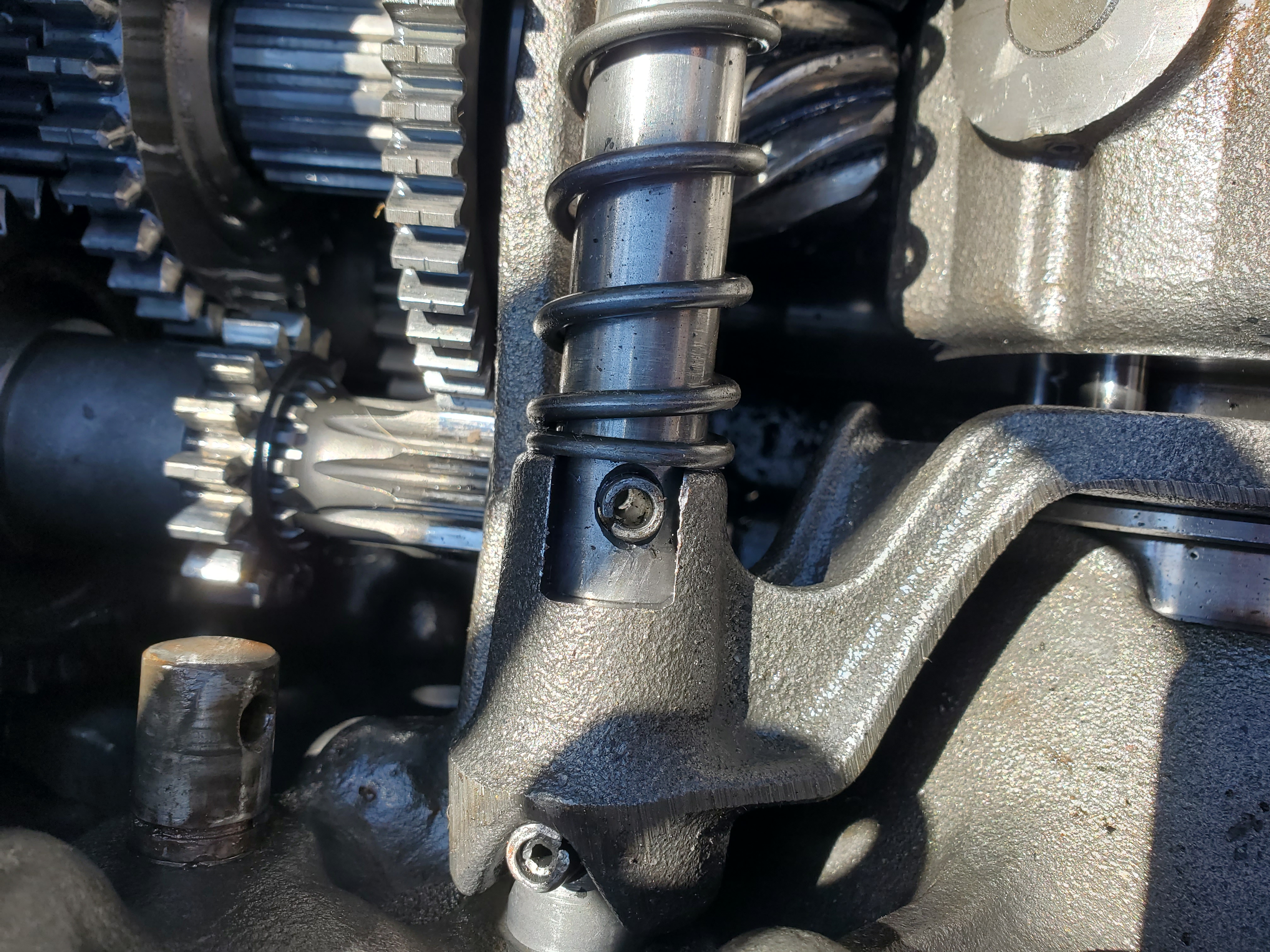

Your will have to remove the differential lock shifting mechanism. I am old and can't remember much. The bolts that hold the ring gear were sheared on the FX24D that I worked on but they will have to be removed on yours. Not sure it makes any difference before or after the unit removal. I did not remove the pinion so I cannot advise you on that. You can go back to the thread I attached in post 22 to see pictures in different stages.
/ Rear wheels binding
#52
I have been looking at your post often!!! It's very helpful. This is the first time digging into something like this so I'm just hoping I can put it back together!

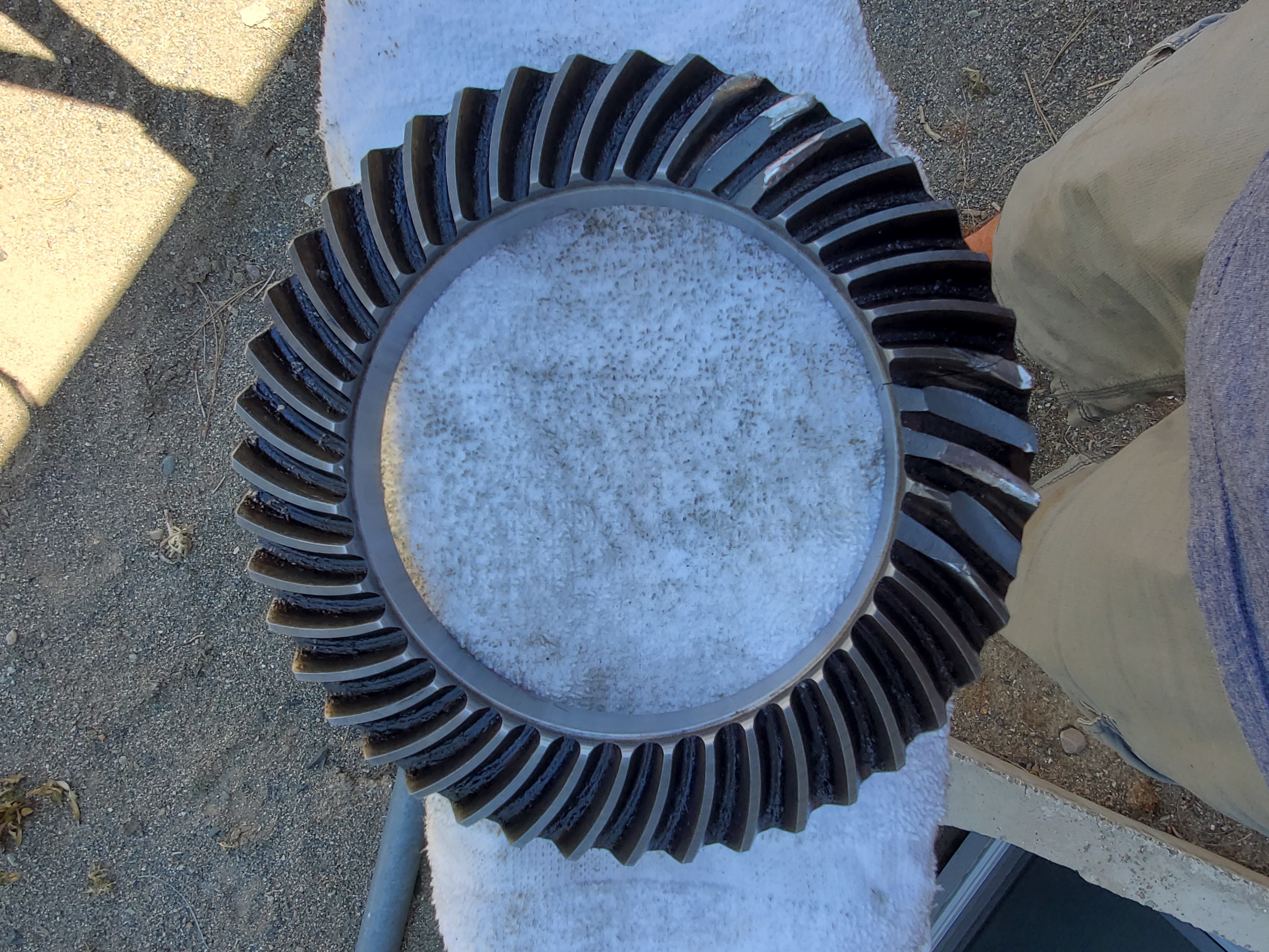

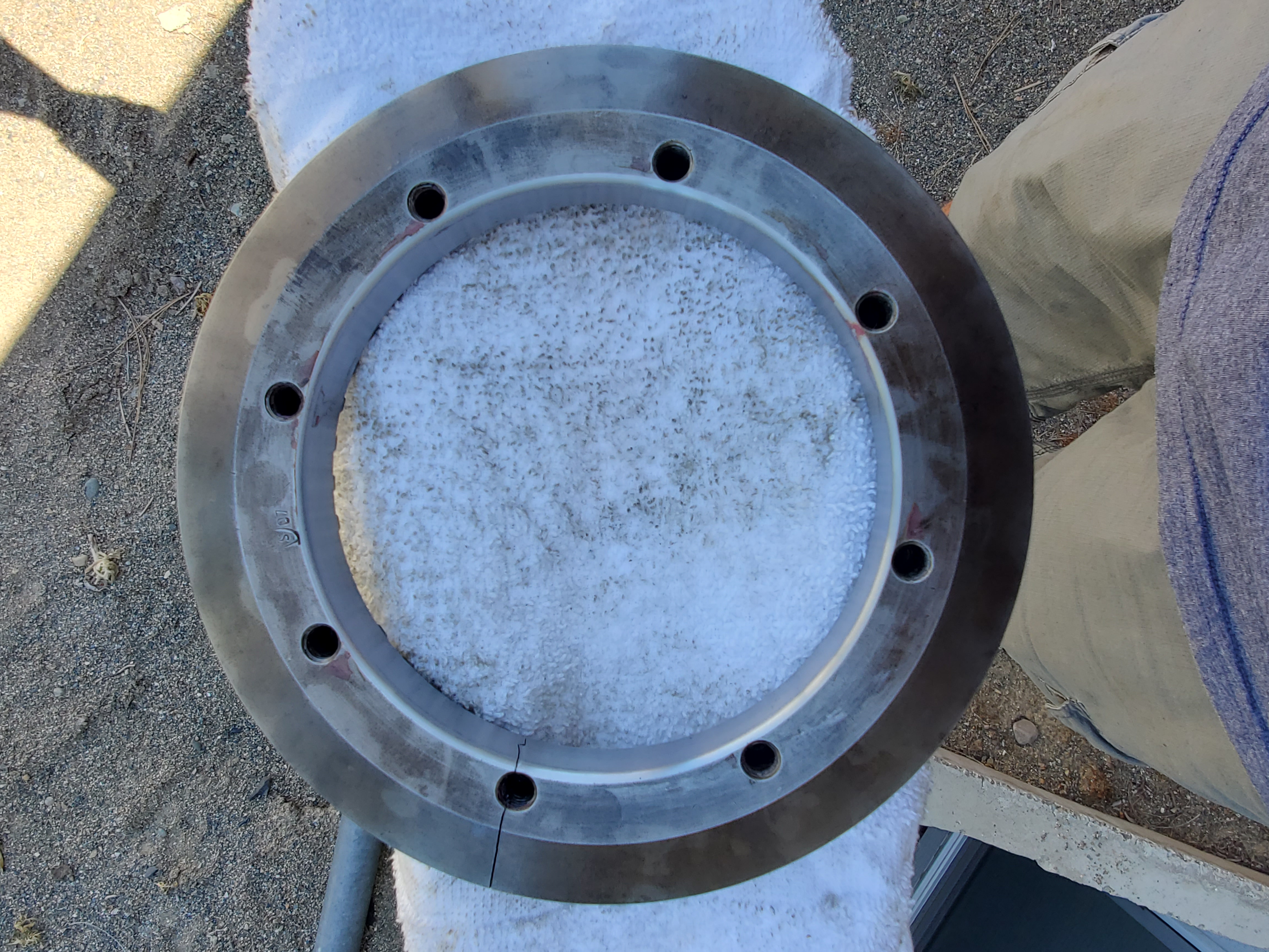

Thanks. I just went for it. Taped them out and got everything out. Now to find parts. It's 43 teeth but it not only had a few broken teeth, it cracked apart too.20200713_121421.jpg20200713_121429.jpg
/ Rear wheels binding #55

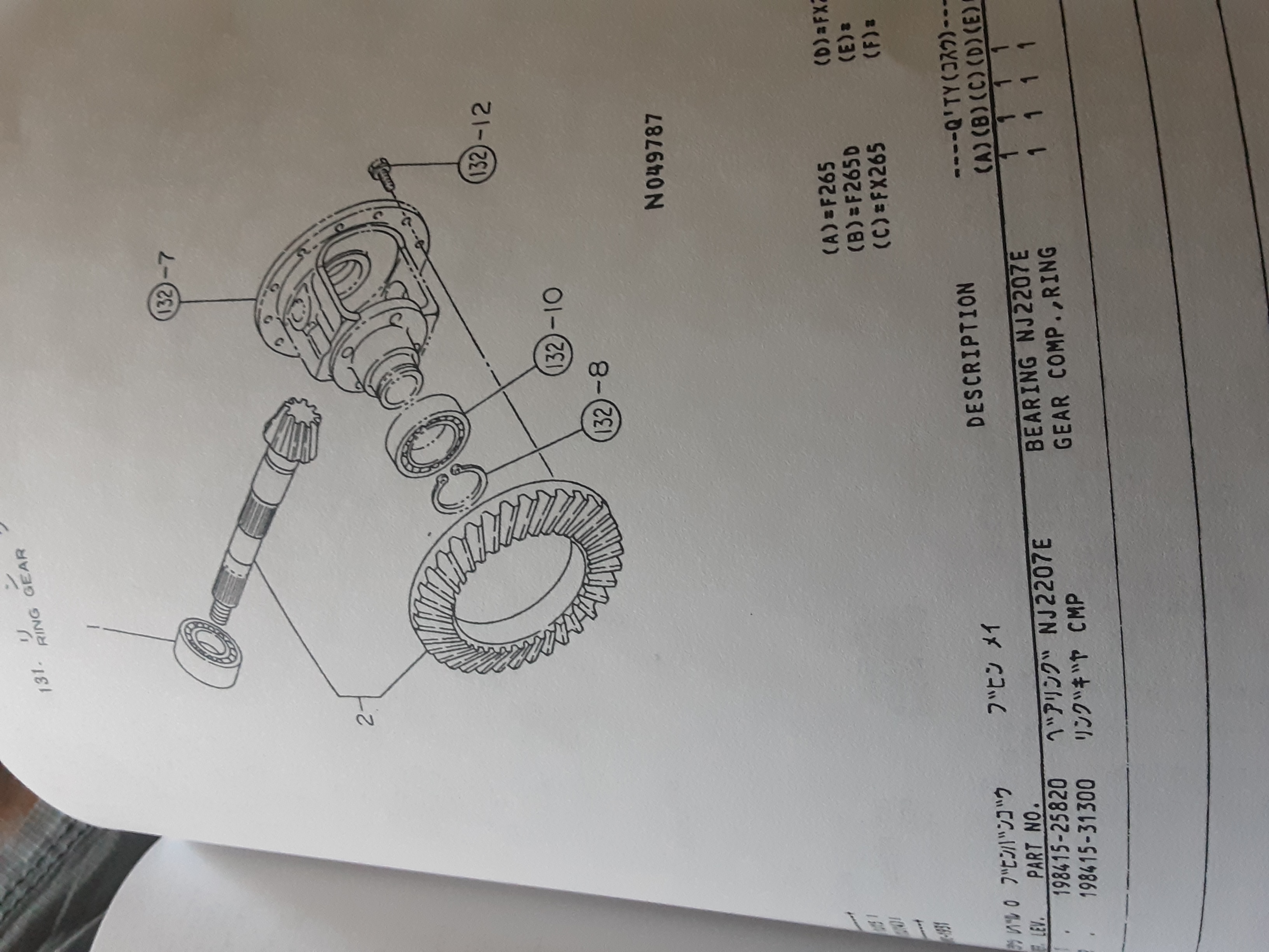

The FX24D had 43 teeth, wonder if it isn't the same gear. part #194555-31300 for ring & pinion, they are available, do you have the part # for yours?
#56

#58
Funny the last set of numbers are the same.
/ Rear wheels binding #59
Post # 54 shows some of the broken teeth are dark, and some shiny. I wonder if this ran a long time with a couple of teeth missing then finally a fragment jammed.
