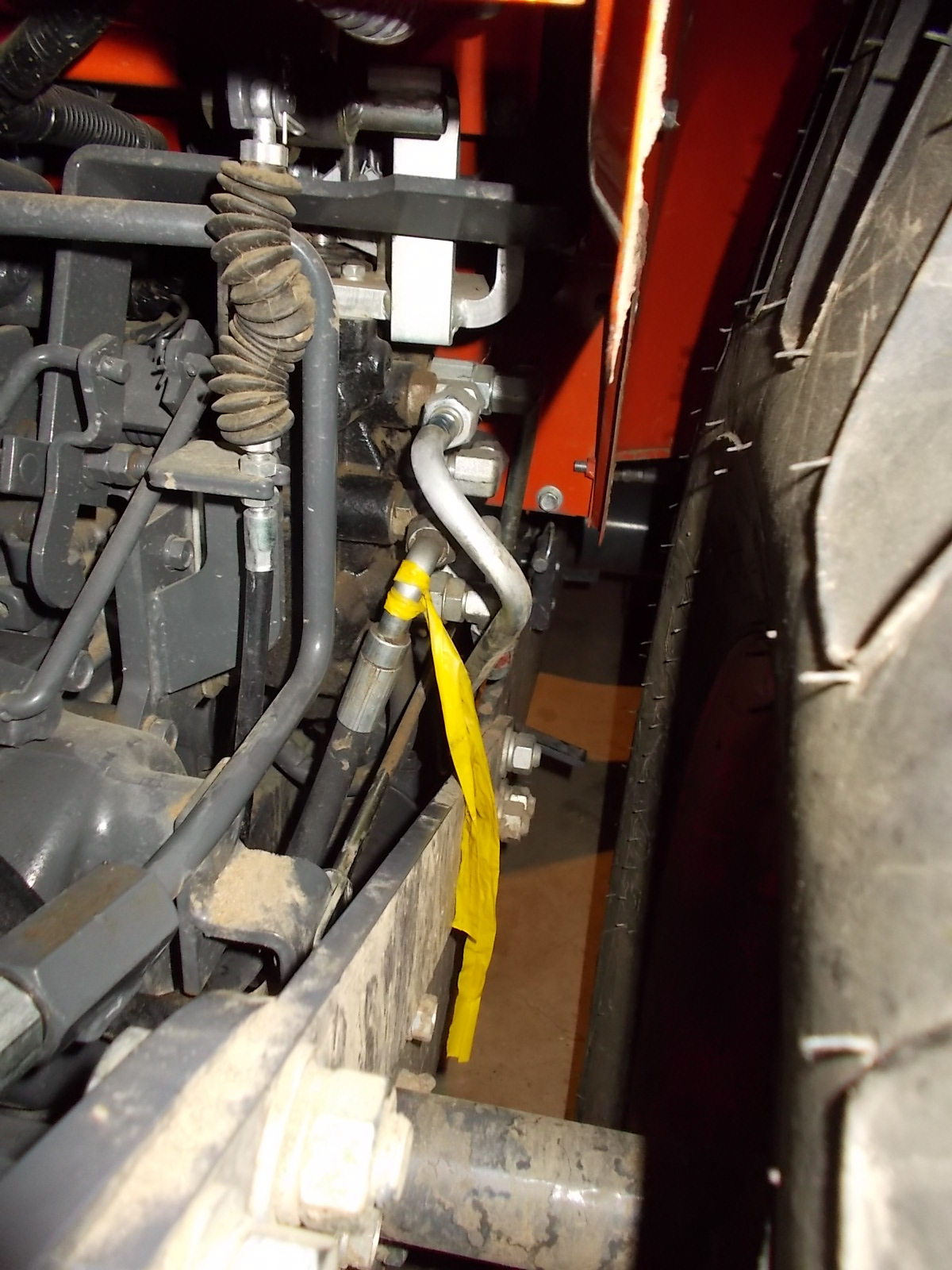

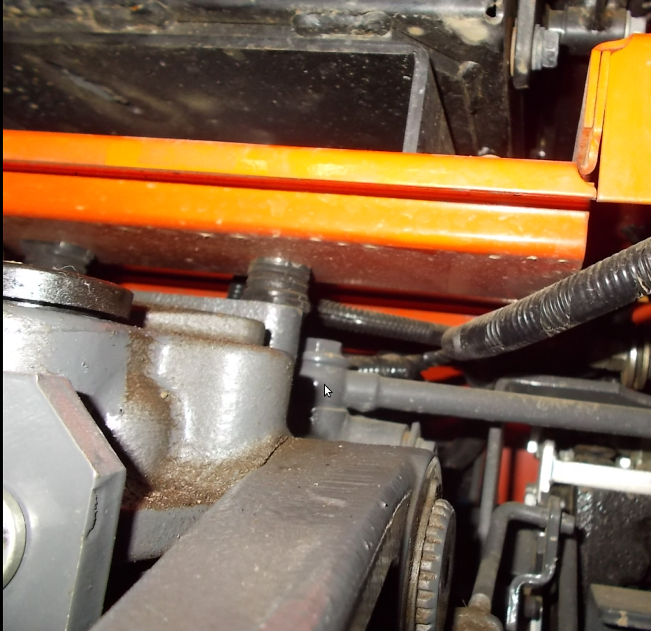

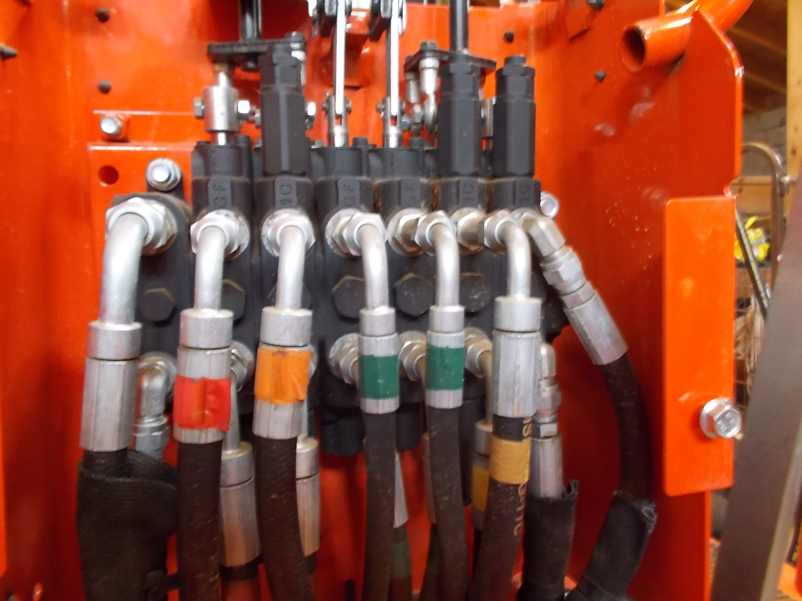

Hey Ripley,
Moved to Colorado from Dexter, ME two years back. Now I have my first Kubota and am messing around with the rear remotes. I have a 2013 B26 TLB and am trying to figure out which hose is return to the reservoir and which hose is the power beyond. On the left-most ports the backhoe spool has the letter D on the top rear remote attachment at the spool and the letter O on the bottom spool attachment point. The D line goes back into the top of the tractor rear end (white arrow) and the O line goes into the side of the tractor rear end (orange tape on line). A lot depends on answering this basic question correctly. Thanks to JJ or whoever can set me straight. I'll edit the pictures as needed. DSCN0861.JPGLine D in.pngDSCN0868.JPG
/ Rear Remotes #4
The D line is probably the PB.
The O is probably the tank/return line.
Some BH will have three lines.
I don't recognize those stamped letters, so that is a best guess.
Can you operate the 3pt with the BH attached?

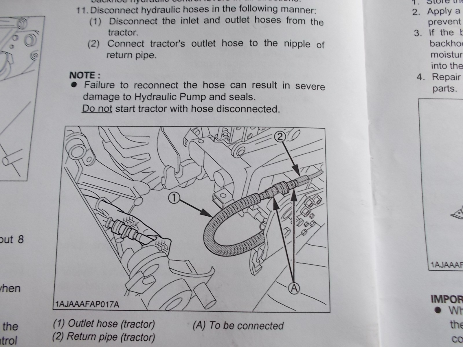

/ Rear Remotes #5
JJ,
Your question "Can you operate the 3pt with the BH attached? " sent me to the owners manual for the BT820 backhoe, because I have the hoses loosened trying out different configurations and don't want to start the tractor. Well, there it was in the owners manual, see photo. DSCN0871.JPG
