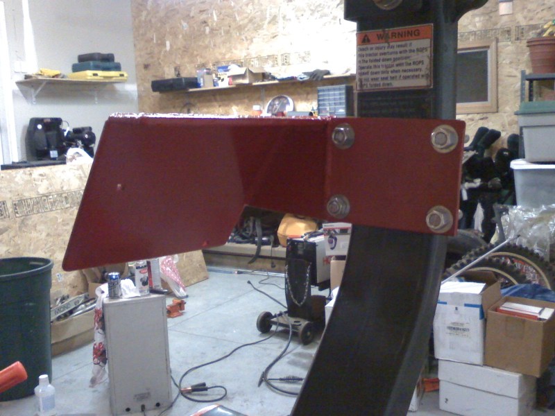

Ok, I am done being PO'ed at TBN for the whole Markham ban thingy and thought it was about time to contribute something.
It took a little longer than expected but I am finally moving forward with the rear remote install on the 273. My plan is still to use the 3 spool valve pictured that will be powered off the original remote set. This hoses powering the new valve will be connected using quick couplers so when I need to use the backhoe I can connect the hoe to the original remote set which allows for the constant flow.
I already made a bracket for the valve that will be secured to the ROPS via 2 u-bolts. The ROPS has a curve right about where I thought the bracket should be so I decided to mount the bracket a bit higher in order to keep the bracket simple in design. It actually works out pretty good and does not block the signal lights on the fender. I made the bracket using 7" 1/4" flat stock using wheel grinding discs for my cuts. 2ft of the 7" stock cost $13 and as it turns out I only needed 1' 6". Tried bending the metal but without a decent torch had no luck. Ended up cutting through about halfway with the grinder, heating the slit then bending then welding the bend closed. Worked ok I guess. The ubolts were 4"W x 3"D and I had to cut nearly an inch out of the width and weld them back together (good stainless fumes!) as the ROPS width is 3 inches. Hopefully it holds.. I was glad (don't like filing square holes) that the new valve only had 2 screw mounting holes because I plan on using carriage bolts to get a flush mount.
Sorry I didn't think of pictures when I started cutting & welding. Here are few pictures and I will post more as I finish it in a couple of days.

Finally got it finished. Had trouble with two NPT fittings leaking. Not sure if I overtightened or if something wasn't right from the start. Anyway here are some pictures.
