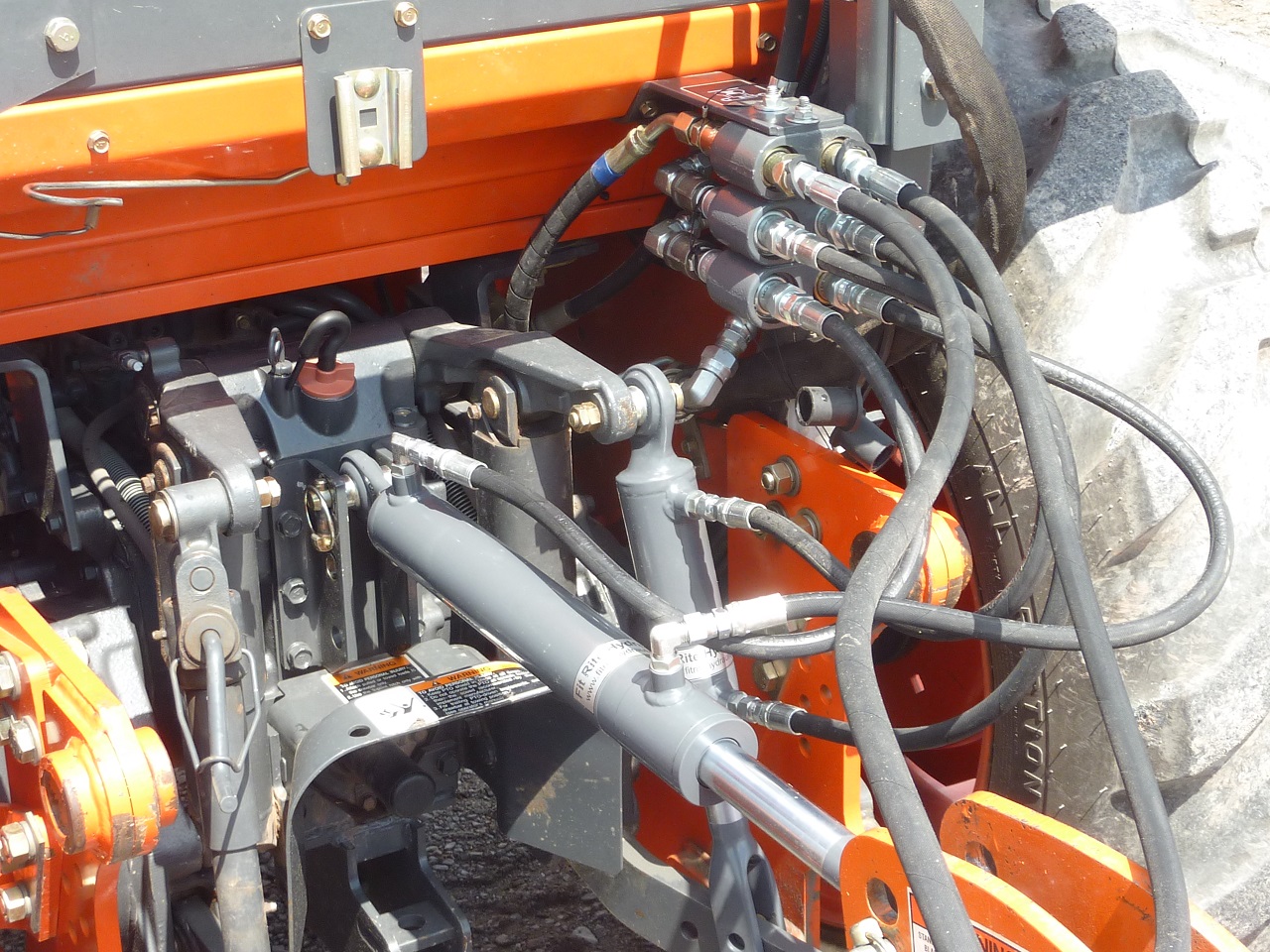

Hey guys I'm getting ready to add a bunch of hydraulic remotes to my tractor and i was curious if there are special couplings that are needed to mount the rear remote connections into a plate, unless i just need to find couplers with male threads and lock them down with nuts into a plate I make, or do they make nuce clean blank plates also, I hope to be getting my mahindra backhoe for my 2538 this week and then I'm sure I'll have more questions since I plan on plumbing in backhoe feed and a 2 spool rear valve and maybe even a 3rd function, thanks

Kubota supplied these with my L4330 "kit". Nice solid cast iron "sockets" with a heavy steel mount bracket that mounts to the rear up under the toolbox. Pioneer quick connects inside with a big snap ring in the back to secure them.
Nice and neat, but pricey!

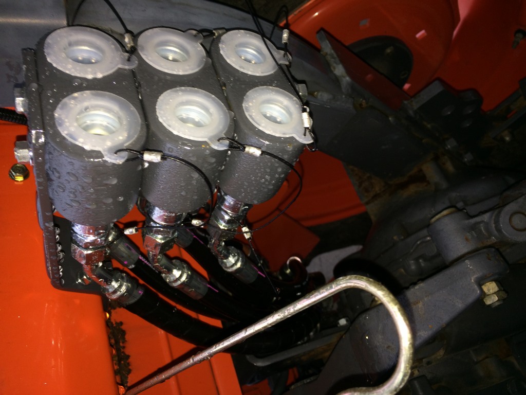

/ Rear remote coupling plate #6
As JRobyn posted, Kubota makes rugged cast iron coupler housings stackable against a plate which could be mounted in several locations.
The are indeed pricey.
It is recommended you use "break away" type couplers for rear remotes in case you forget to uncouple a hose when removing an implement.
