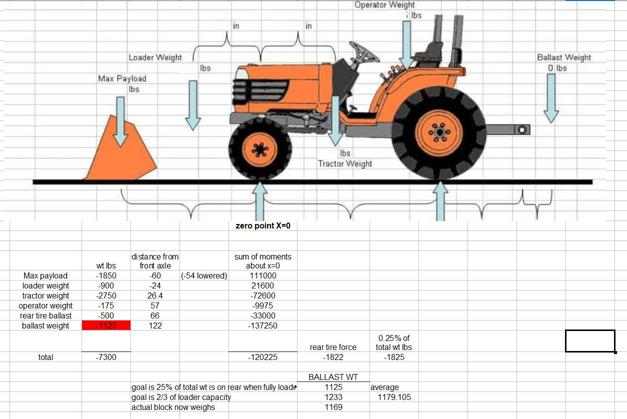

You’re right but how much ballast would you have to add to reduce the front axel load at max lift capacity to less than the front axel weight with no ballast at all? The answer is an unreasonable amount. Much more than a simple 800 pounds ballast box.

/ Rear Counter Weight #47
In the interim here's an excellent video that discusses in great detail the conversation we're having about the physics of 1) rear ballast, 2) rear wheel ballast (weights or Rim Guard), and 3) FEL payload.
It's a simple engineering discussion known as a "beam analysis."
The video starts with him using his tractor to identify the forces. At 6:30 he goes to the computer and at 10:30 he presents the formula which is central to the discussion.
At 19:10 he goes over some examples.
He doesn't address the scenario where the rear axle is lifted off the ground or the scenario where the rear wheels are barely on the ground but that can be extrapolated by those with good algebra skills and a bit of time on their hands.
