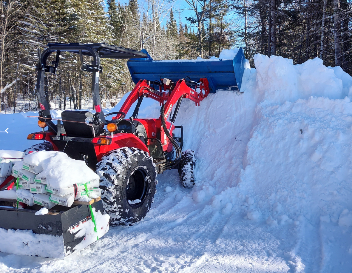

Here are some real world (northern) results. The rear box blade is about 500lbs and sand bags are about 1000lbs, for 1500lbs total. The setup has worked very well all winter and it has not felt front-heavy at all, even with a large 8ft pusher full of snow.
Hey, I'm interested in that 8 foot pusher and not having chains on the back.
I was of the mindset that I should get chains for the little 6 foot pusher I want to add to my snow weapons.
Do you find yourself alright with traction with just the added weight?
For the most part the traction is OK, but could definitely be better. Before next winter I plan to fill the tires, which should help. I also looked at chains but had no idea they were so expensive for large tires. The only reason I have an 8ft pusher is that I got a very good deal from an auction, otherwise I would have selected 7ft - or possibly 6ft if you need to push lots of deep or heavy snow.
The other thing to keep in mind is that a pusher only works well for short runs. If you have a long road or driveway you need to plow, a blade that can push snow to the side would be a better option. I have both a wide flat area and a long driveway and it's a bit of a pain to have to stop, turn off, and dump the pusher multiple times to clear the long driveway.
