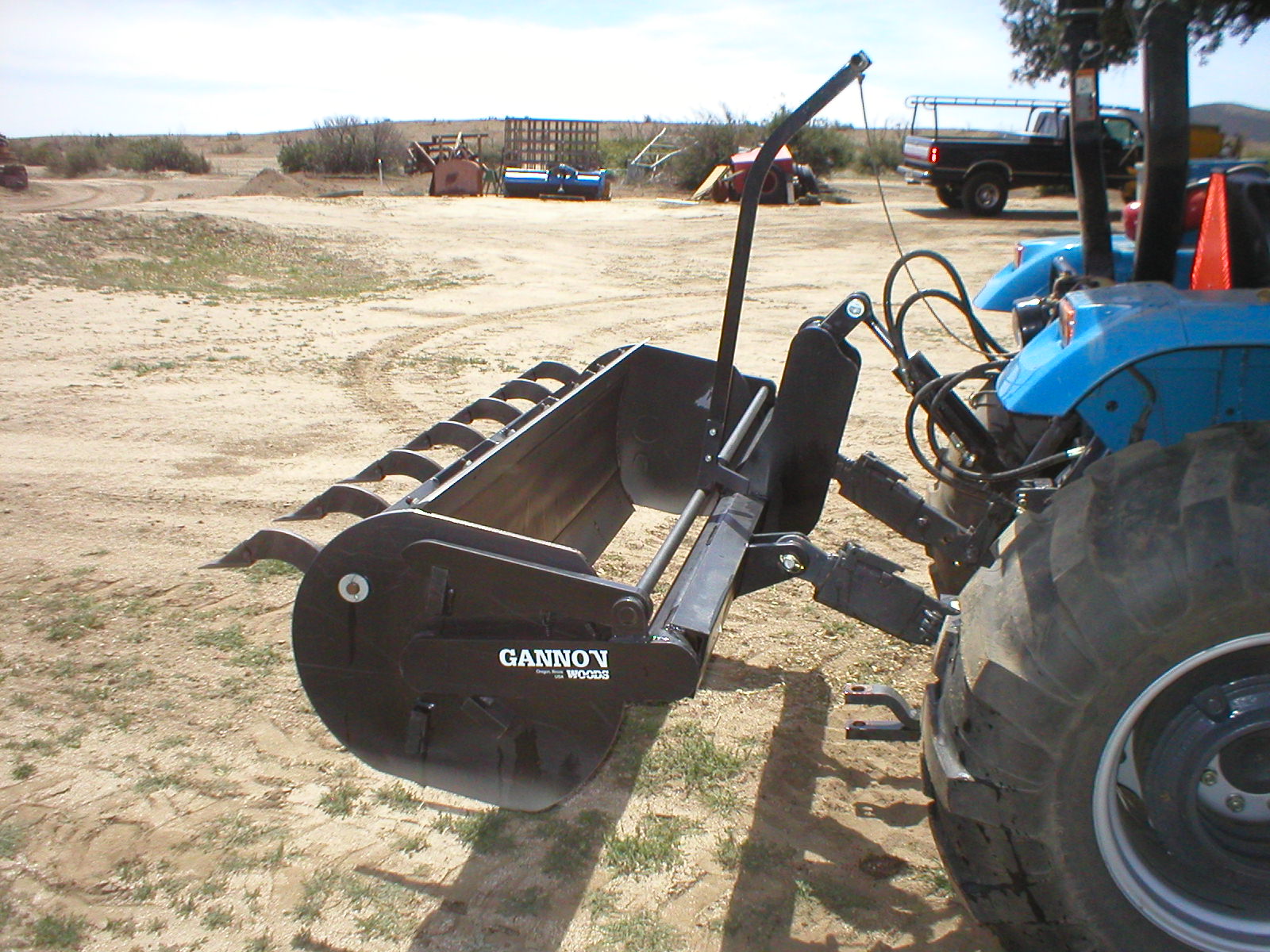

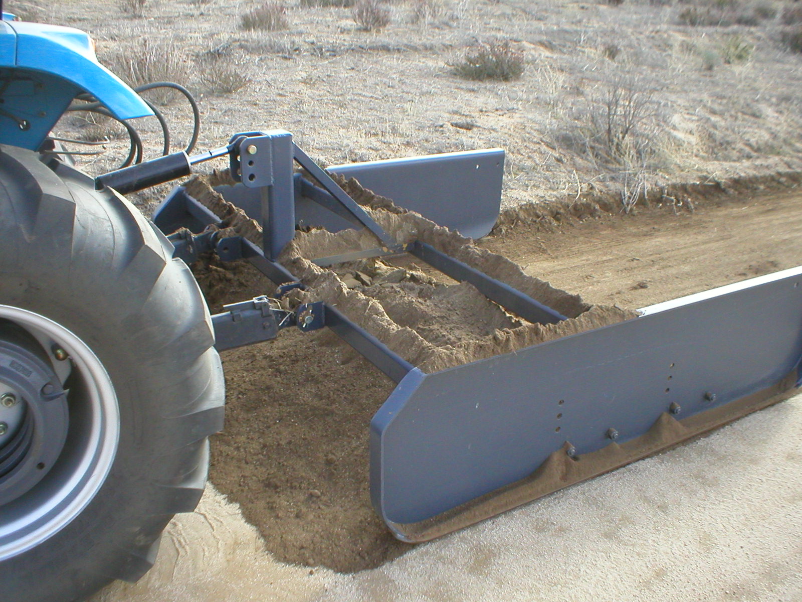

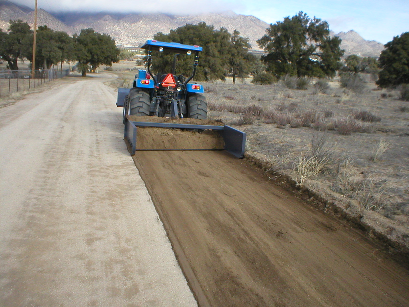

IMO, the BEST implement to maintain a drive is one of these. Rear blades have their place just as box blades and landscape rakes do. But none of those compare to a grading scraper when it comes to maintenance. Trust me, I have them all. ;)
One last thing, if you get a rear blade, you will be happier with a 7 footer. I hope to get a Land Pride RBT3584 one of these days for my Mahindra 3215. :drool: Don't forget the skid shoes for whatever rear blade you get if you go that way. ;)

I have a Land Pride RB 3596 rear blade. Its used mainly for snow plowing since I got the Land Pride GS 2584 (grading scraper). There is simply no comparison - the grading scraper does such a better job on the driveway. There is no way I can control the rear blade and produce the results the scraper gives.

You can, as in it is possible, and it most likely depends on how long it would take with the type of material that you are working with. IMO it is best to maintain a road with a LPGS, but if you need to get that crown, it is best to use a rear blade. I shape my roads using my box blade and rear blade. Maintenance is done with the LPGS. ;)
