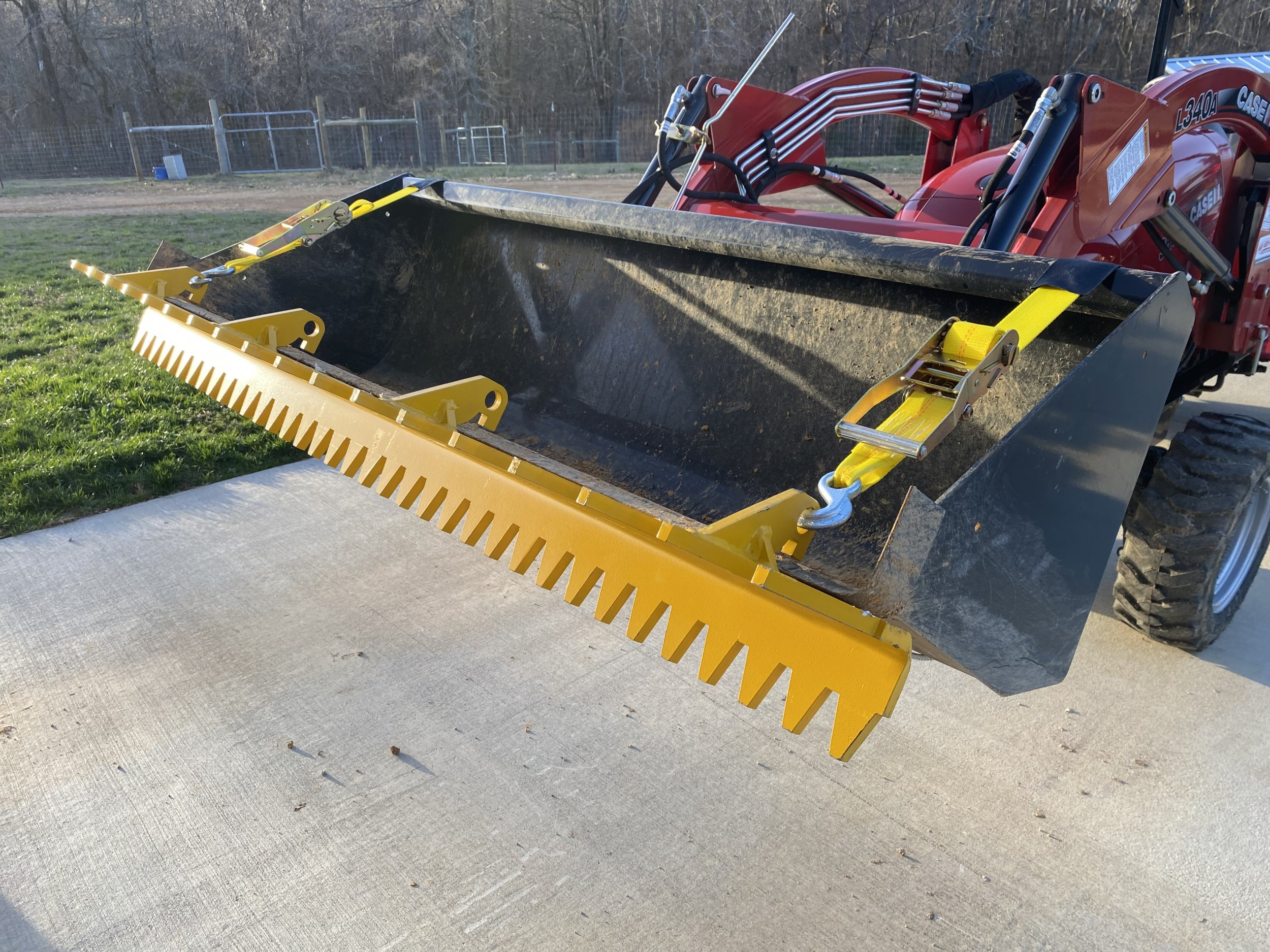

I just bought a Ratchet Rake to help in some brush cleanup projects but it will also serve as a driveway rake. This might solve your problem by breaking up the driveway and then re-grade with your rear blade. I purchased a 72" Ratchet Rake. You would need to measure your bucket for the right size. I paid $479.99 delivered to my door.

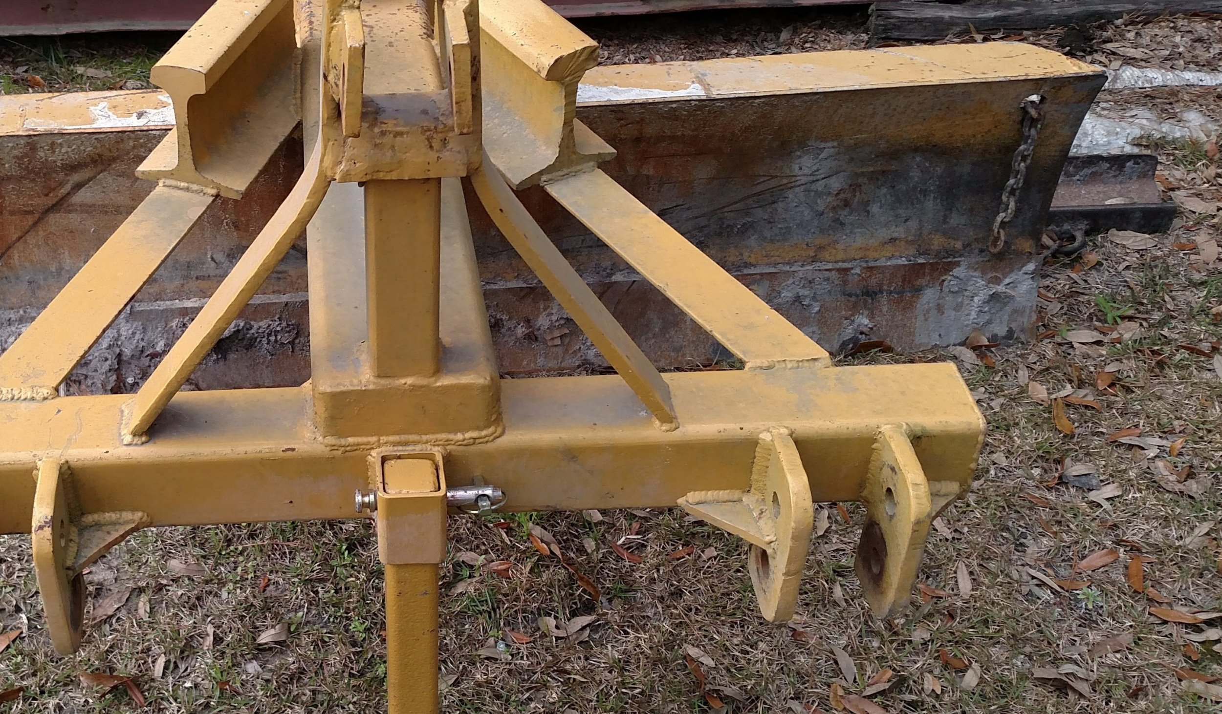

Nice blade, I'd for sure be adding hydraulic tilt and angle to it, especially for cleaning out ditches and pulling gravel back into the driveway.
/ Rear blade weight #23

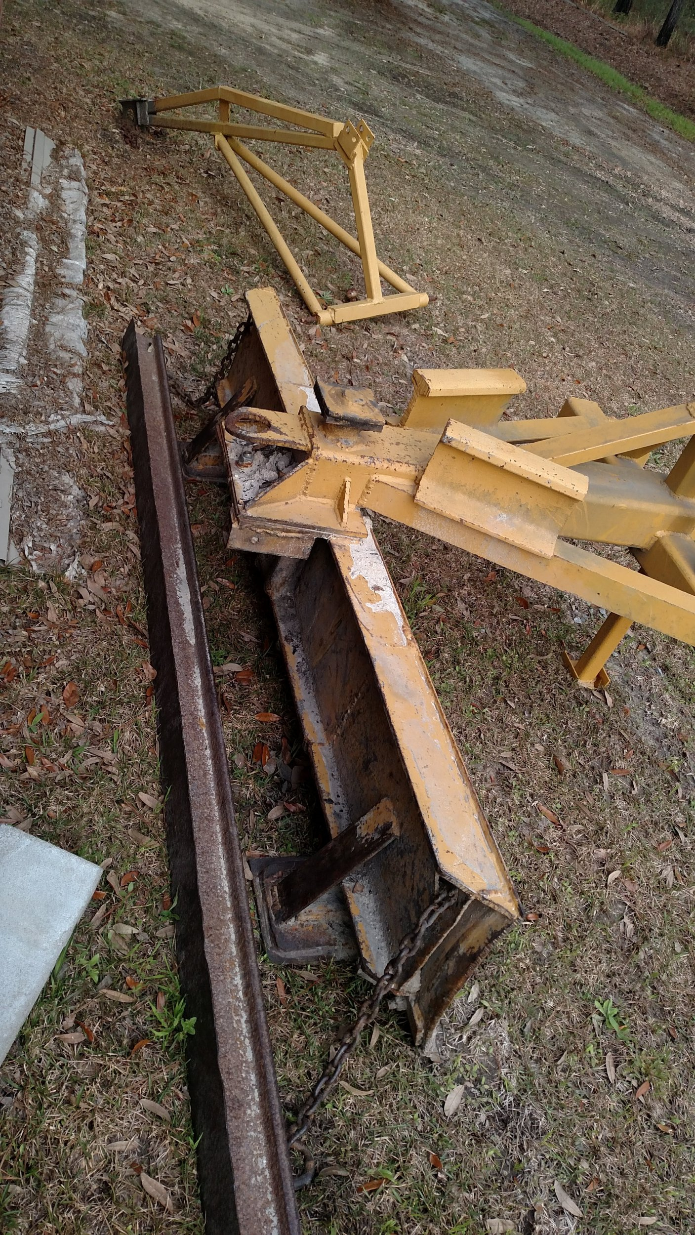

There's no blade on the market IMO.. BUILT as HEAVY or as sound as they need to be ...
When in doubt fabricate....

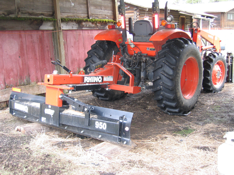

I currently have a Land Pride RB3596 @ 566# on the 3-point of my M6040. It does great for plowing snow but will do little to nothing on my concrete hard driveway in the summer. Even with the hydraulic top link extended - i.e. max cutting angle for the rear blade - it just, more or less, bounces along.
My thought - I NEED MORE WEIGHT. Sooo.... what's your suggestion for the max weight I can add to this blade without causing damage to its structure/attachment points.
I'm also considering a new - and much heavier - rear blade. Rhino 950, 8 foot, at around 1000#, after the manual kits are installed.
The reason for this query is obvious - I can add XX amount of weight to my existing blade for almost nothing - the new Rhino blade will set me back around $3500.
Your suggestions and experiences will be greatly appreciated. Oosik
I’ve been very impressed with this blade. It’s heavy and cuts hard road surfaces and doesn’t bounce and chatter. With Cat2 pins and set up for hydraulics if you decide to do that. I paid $2600 a little over a year ago:

Entire reasoning behind fabbing my own blade.... Yeah it may not have as many pleasure points as the rest on the market . But no matter how hard I beat it up or what I put it through... It will constantly dig and throw dirt with a slight adjustment...
And yeah it's heavy enough from the start ..
