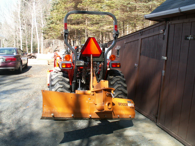

I don't have enough room to swing the blade w/out hiting tire on my Woods RB72...even try at 45 degree angle.
I drop stand leg on RB unhitch,pull pin rotate RB ,repin,rehitch,pull up RB stand leg and good to good..maybe 5mins to do..
Yes it would be nice to rotate 180 w/out rehitching..maybe cut and spice to lenghten frame??

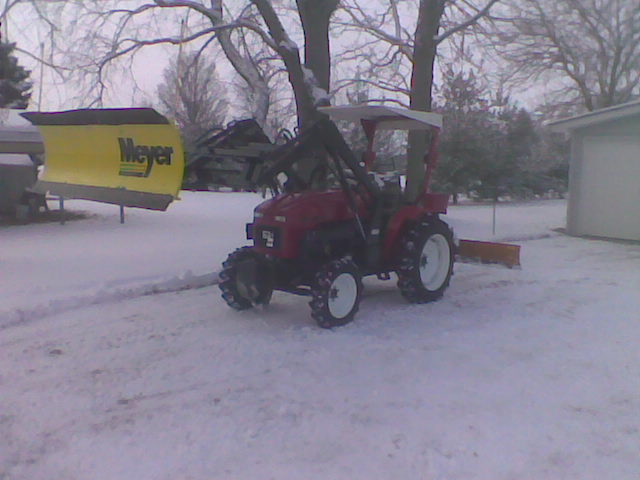

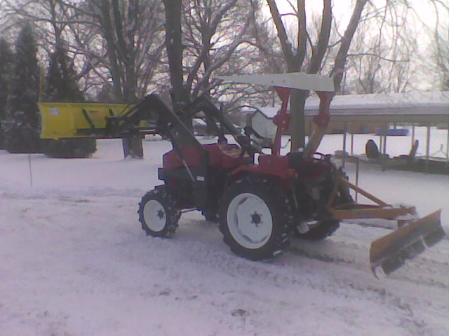

I can swing my RB7 which is a older version of the Woods RB 84 on my Jinma 284 without taking it off. Just pull the pin and swing it.
Sorry but the pic was with my cell.
Chris
