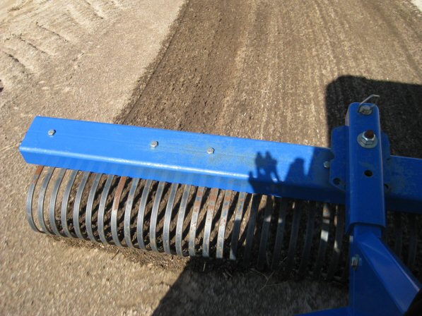

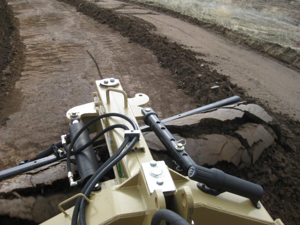

Would someone please show me the box blade that will do this. (first 4 pics)
I have 4 different implements that I use when working on roads.
To build a road I start with my rear blade.
If there are areas that need material cut out or put in, I will use the box blade for that.
To maintain my roads I usually use my land-plane grader blade.
To put a nice final touch on the roads, my landscape rake works well for that.
Don't get me wrong, any one of these implements will work on roads, just some are better at doing certain aspects of road work that others.
JMO with what I have and my conditions that I have to work with. ;)
