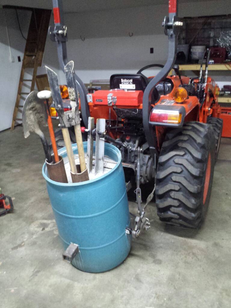

Hi Guys,
Just purchased a XR4040C with the shuttle shift and love it!
I have a question about constructing some rear ballast using a 55 gallon steel drum. Can I just buy a draw bar and poke a hole in a barrel about midway up for the lower lift arms and then fill the barrel with concrete? How many bags do you think it would take to fill it up?
Here is a picture of my new tractor. Of course my wife was the first one to jump in and drive it around.
/ Rear Ballast #3
Yes, you can just poke a draw bar through there, but I would suggest having something to attach the toplink to as well. Otherwise the barrel likes to spin and flop around sometimes.
And given the way a barrel is round and how your lower arms are made, You might want to cheat the drawbar/hitch part a little forward so it hooks up easier and the sides of the barrel dont get in the way of the lower arms.
As to how many bags....a 55 gallon drum filled clear to the top is actually closer to 60 gallons. And 60 gallons is 8 cu ft.
So if you buy 60lb bags, those do 1/2 cu ft each so you would need 16 of them.
IF you buy 80lb bags (2/3 cu ft) you would need 12 bags.
All that should give you ~1200lb counterweight.

Thanks LD1, those are good suggests on moving the draw bar forward a bit so the barrel will not be in the way and adding a top link to keep the barrel steady.
I'm sure glad someone is good at math, I was looking at a barrel and trying to figure out how many bags it would hold with 1 gallon of water per 80lb bag and kept guessing between 10 and 15 and your answer of 12 seems spot on. Thank you! :thumbsup:

I made my 1st ballast the same way. A 55 gallon plastic drum, 10- 80 lb. bags redi mix, 50 lb of steel framing inside. Not sure of exact weight but figure at least 850 lbs.
Then I made a 2nd ballast out of an old safe. That one weighs at least 1200 lbs.

Thanks for all the help guys, between the pictures and the estimated amount of concrete I would need to fill a barrel my rear barrel ballast went very smooth today. I used 11 and a half 80 pound bags of concrete and it filled the barrel up to the rim.

Made the same ballast barrel today using advice gleaned from TBN. Looks the goods lets just hope I reenforced the concrete enough.
TIP: Don't use rapid set, just use general purpose
