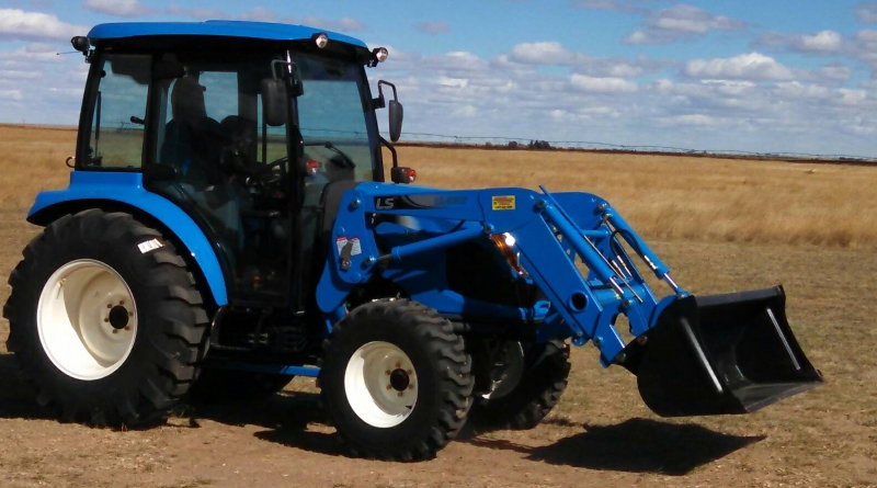

Hi Guys,
Just purchased a XR4040C with the shuttle shift and love it!
I have a question about constructing some rear ballast using a 55 gallon steel drum. Can I just buy a draw bar and poke a hole in a barrel about midway up for the lower lift arms and then fill the barrel with concrete? How many bags do you think it would take to fill it up?
Here is a picture of my new tractor. Of course my wife was the first one to jump in and drive it around.

Great looking Tractor !!! Enjoy yourself sir :thumbsup:

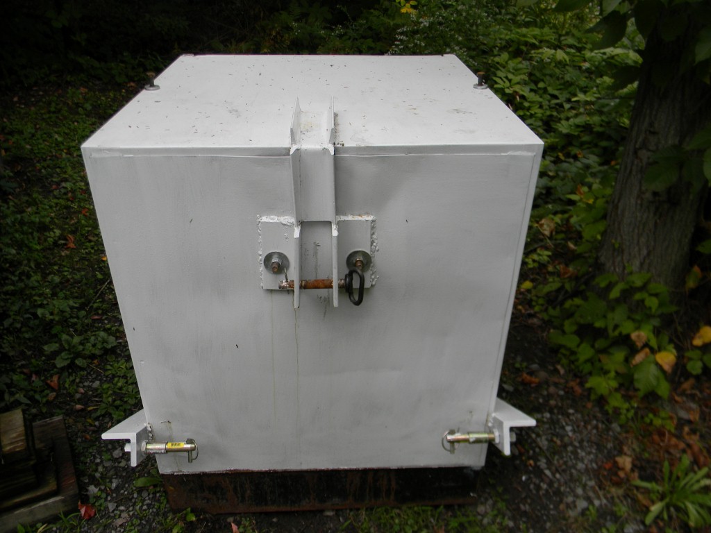

I made my 1st ballast the same way. A 55 gallon plastic drum, 10- 80 lb. bags redi mix, 50 lb of steel framing inside. Not sure of exact weight but figure at least 850 lbs.
Then I made a 2nd ballast out of an old safe. That one weighs at least 1200 lbs.

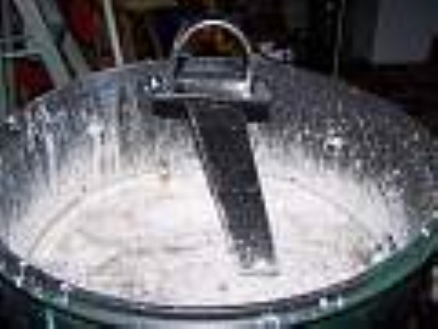

Thanks for all the help guys, between the pictures and the estimated amount of concrete I would need to fill a barrel my rear barrel ballast went very smooth today. I used 11 and a half 80 pound bags of concrete and it filled the barrel up to the rim.

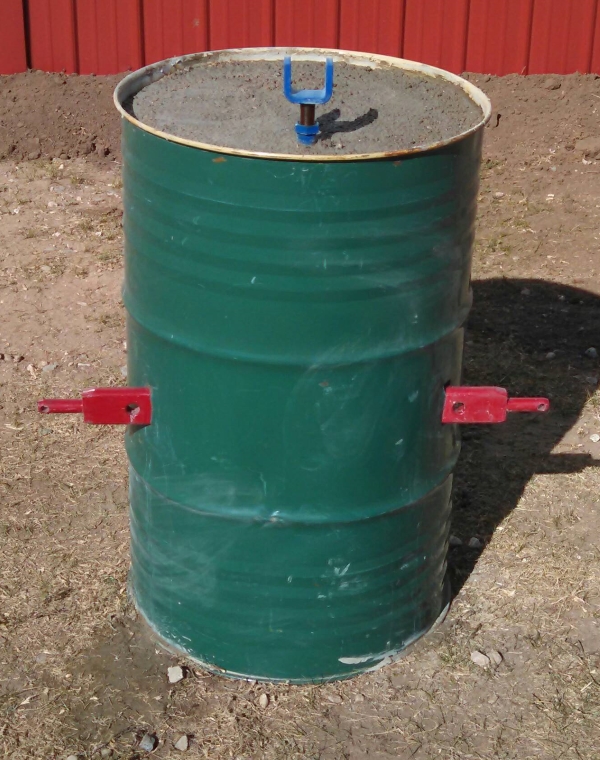

Made the same ballast barrel today using advice gleaned from TBN. Looks the goods lets just hope I reenforced the concrete enough.
TIP: Don't use rapid set, just use general purpose

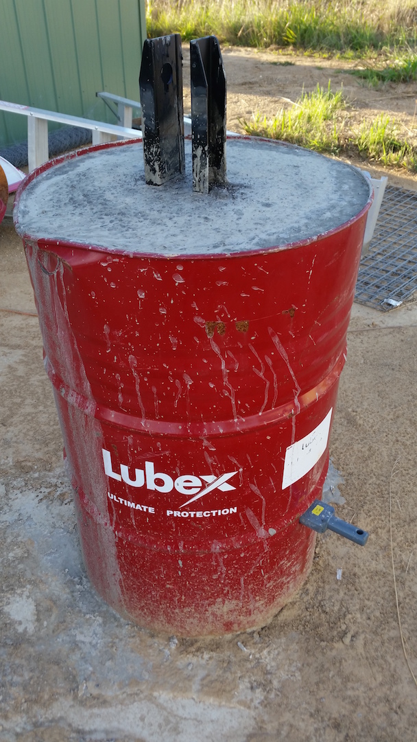

@BarnieTrk I see your point and once it's cured I'll be painting it. The finished barrel:

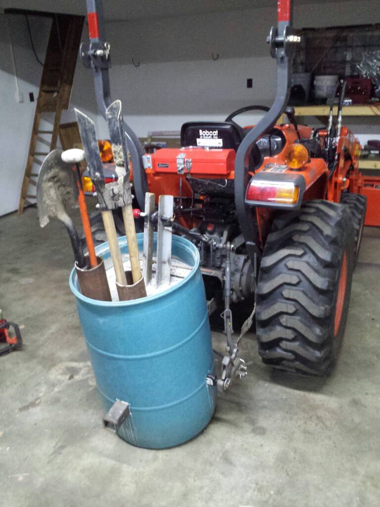

Cheapest ballast you can make here. Barrel of concrete with a drawbar through it. I used to use the tiller as ballast but didn't like the idea of having a $2,000 implement on all the time when going through the woods and possibly hitting a tree with it20190619_221848.jpeg
