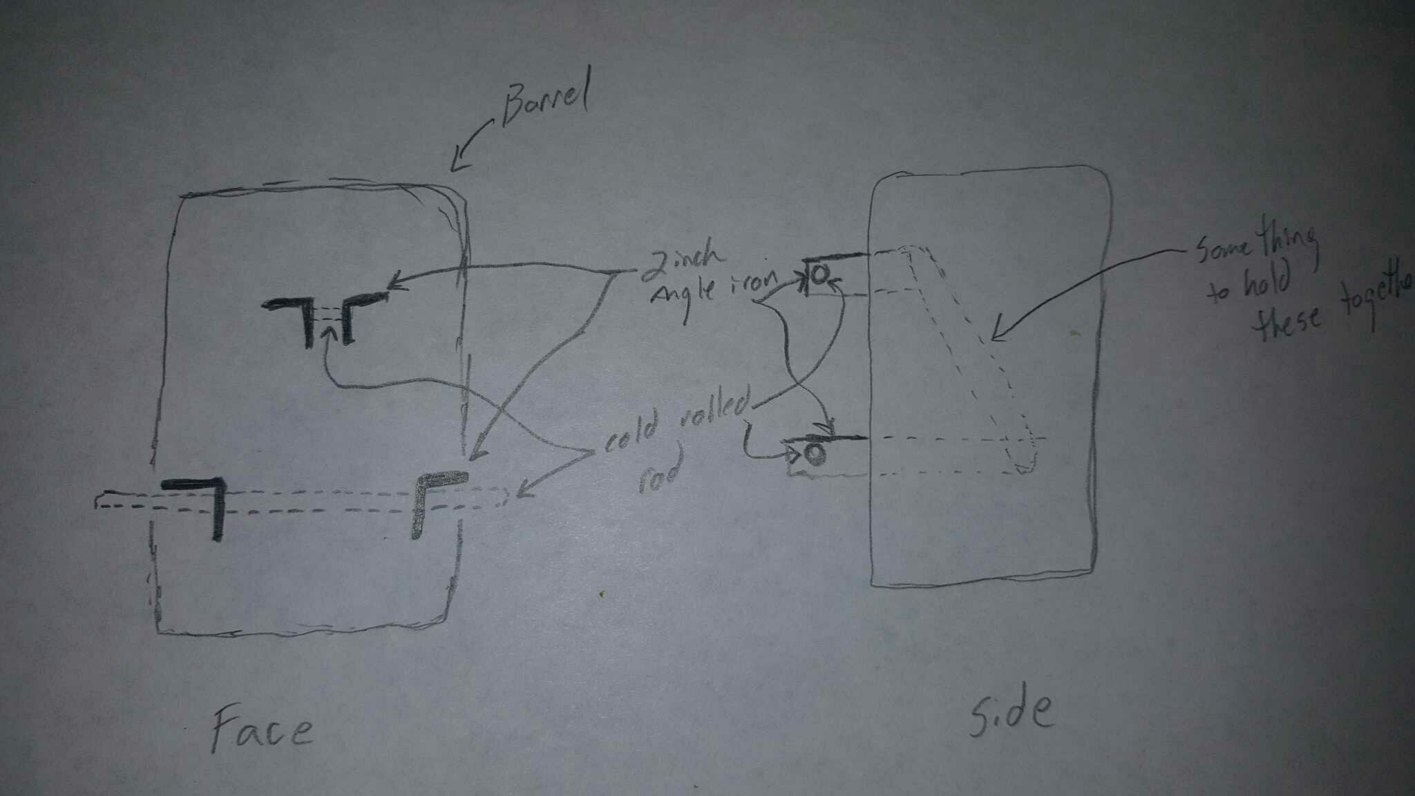

So I finally got what I think is everything to make my own barrel ballast box. This forum has so much on ballast boxes that its great!
I planned to do something like mikes... http://www.tractorbynet.com/forums/build-yourself/347445-ballast-barrel.html
So I got all my parts and I also picked me up a quick hitch along the way. So this has me thinking. Should I keep the barrel close to the tractor and set the drawbar nearly in the middle or create a way to set it so that I can use the quick hitch?
I figure that setting it out would help with the FEL but I need (or i think I need) it more for traction in the snow (crossing fingers). Yes it would be nice to change implements with the quick hitch but being new to this and welding I believe it requires more pieces/parts/time.
So with that said I guess I have a couple questions.
1. Does the 1-2 ft make that much of a difference? (close to the tractor vs offset with the quick hitch)
2. What would be the best way to create something to off set the barrel for a quick hitch? extension pieces I could weld? I'd prefer to go this route but wouldn't mind trying a basic ballast box first.
1. The Tq the ballast box will provide is Force x Distance > Weight of the box x Distance from the FRONT axle centerline (loader ballast I presume). So yes, it will make a difference, but not much of one because it you are not adding a great percentage of length.
2. Take another drawbar, cut a hole in the barrel close to one side so it will slip thru and then for the top link use two pieces of 2" angle iron (1/4" thick) to make that connection, inserted thru a single hole nearer the top. You can add rebar between by metal ties or welding to make it more secure.

If I were you, I'd think about multi-functional counterweight. Example, heavy attachment, or a box, which could be used either loaded with rocks or a piece(s) of concrete, or with water barrel(s) inside. The closer to a tractor you'll make it, the less 3pt hitch lifting force will be needed. It means, the heavier it could be. That box you'd be able to use for the other purposes.
Best solution might be, that you could have a possibility to adjust it's weight.
With a quick hitch I recommend something with square sides rather than a barrel. And with a 1025R it does not need to be too big, maximum of 600 lbs should do it. A standard ballast box or a heavy box blade, rear blade, land plane will all work better than a barrel.
A barrel (42 gallons) of concrete weighs about 842 lbs. for the concrete only
A drum (55 gallons) of concrete weighs about 1100 lbs. for the concrete only.
Both are too heavy for a 1025 or 1026R.
