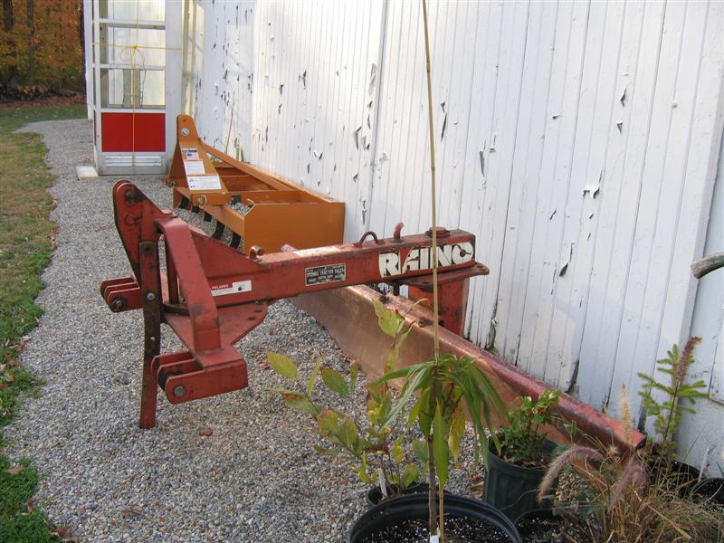

Atobuk, Not sure there is a correct size, it all depends on what your going to do with the implement. I can tell you that the 7' Rhino that I use weigh's about 400# and works well with a 60hp tractor. More it weighs, the deeper it can cut when needed. JMHO :)

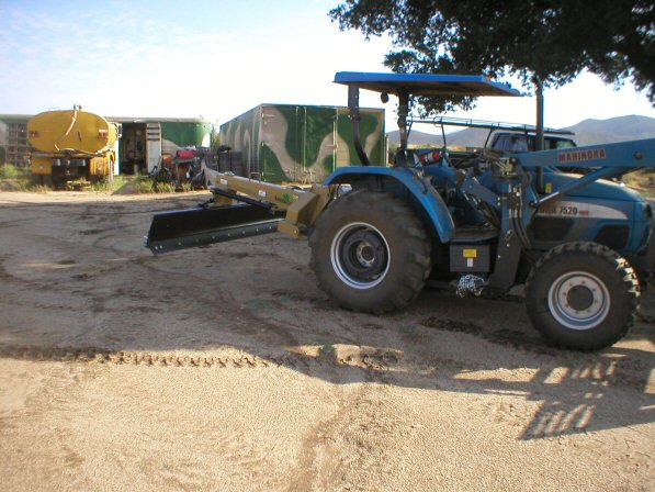

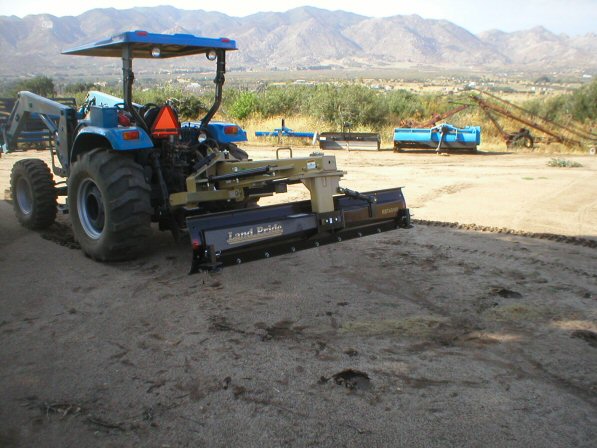

That is the same thing that I do, but I still want a little more height. I feel that the boom should be parallel to the ground when working.
Just my opinion
Just my opinion
Brian, are you saying when working your blade, the boom is not parallel to the ground?
You should be able to lower the drag links and lengthen or shorten the top link until the boom is parallel to the ground. A combination of adjustments I would think?

Rob, while working, the boom is close to parallel, but when raised up the blade is only 6-8" off the ground. Then shorten the top link and it is ok to transport. Just would like it to be higher without always needing to shorten the top link. As you know, it is a lot of work to pull that lever to retract the hydraulic.:rolleyes:
