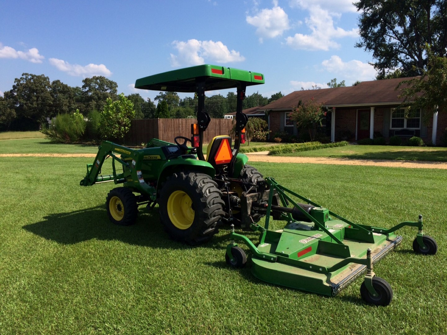

I have a 2015 Frontier GM1084R & it has a Woods gearbox so I am assuming the mower is made by Woods, it is a good mower cuts good and yard looks good after mowing. That is a 3038R pulling it and does a good job. IMG_2010 (Large).JPG

I have a 2015 Frontier GM1084R & it has a Woods gearbox so I am assuming the mower is made by Woods, it is a good mower cuts good and yard looks good after mowing. That is a 3038R pulling it and does a good job.View attachment 556276
deere36, can you lift the GM1084R with 3PH without the loader? I'm concerned about lifting 830 lbs of weight on the rear w/o front ballast.

I've been running an 84" rear discharge finish mower (First Choice GM 35-84) for 12 years or so now on my DK 35 no problem running or lifting it with no loader on the front. (815 lb mower)
I take the loader off to mow.
Vince, good info to know. Was concerned about the weight on the rear.
