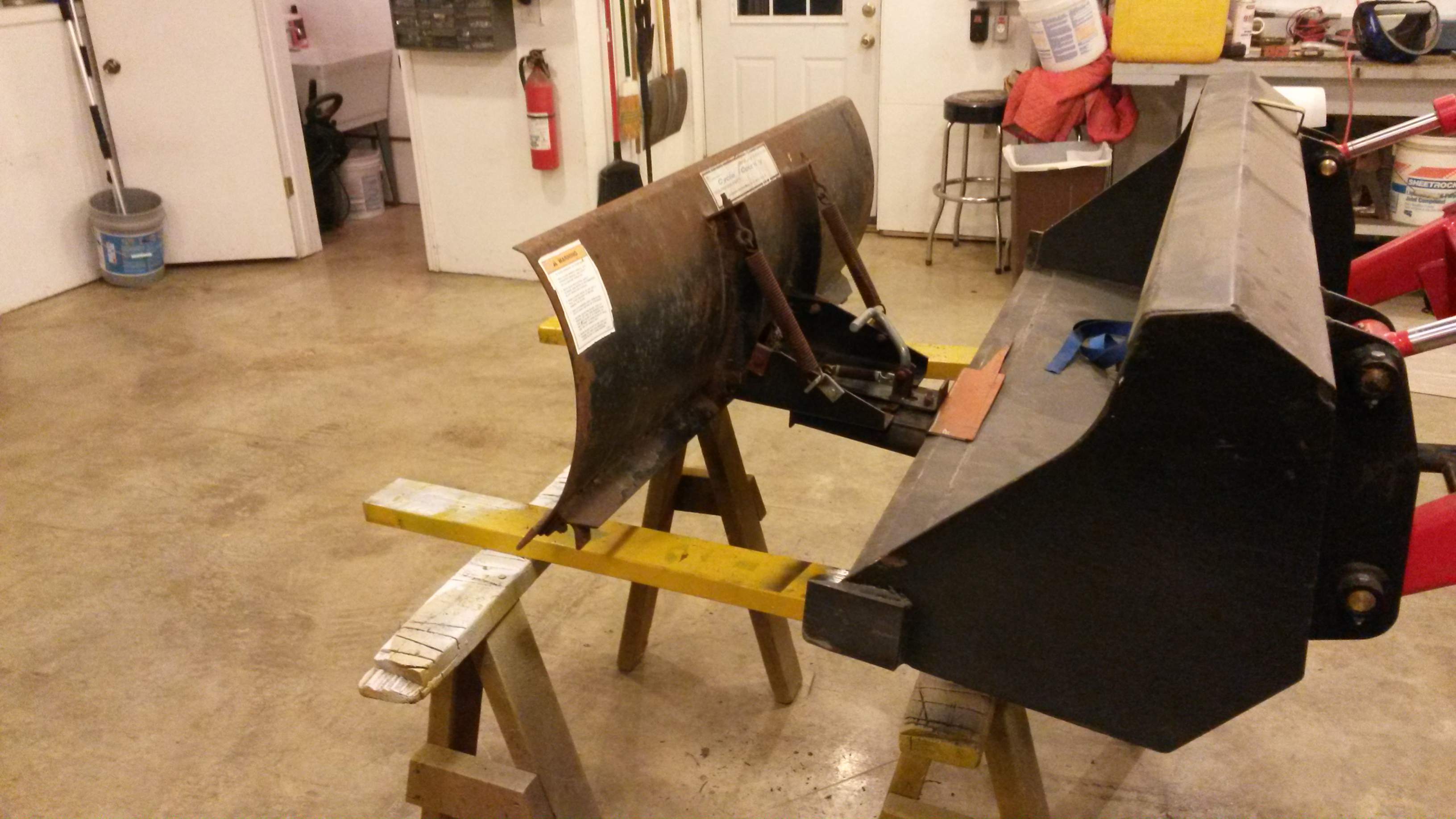

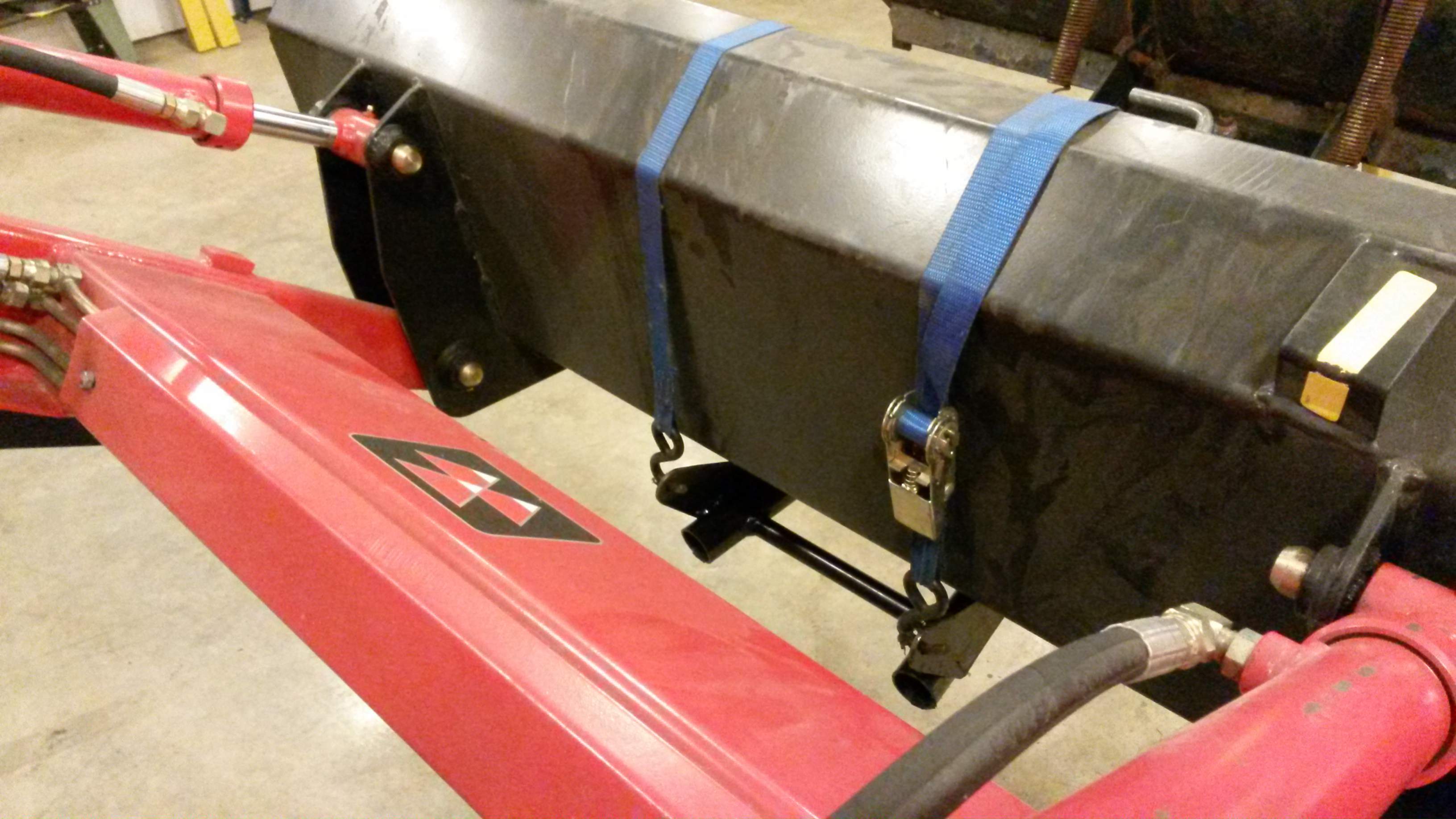

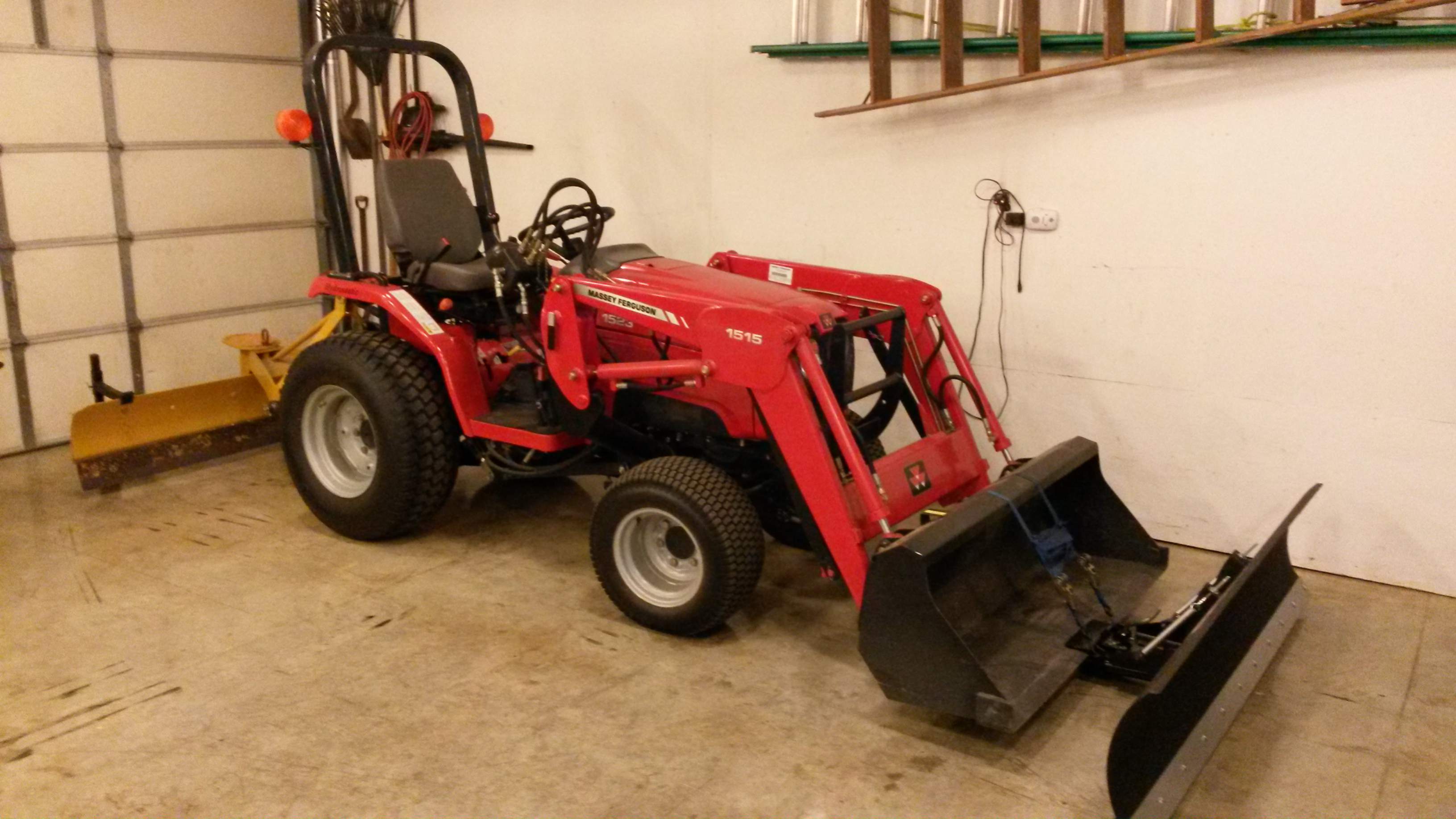

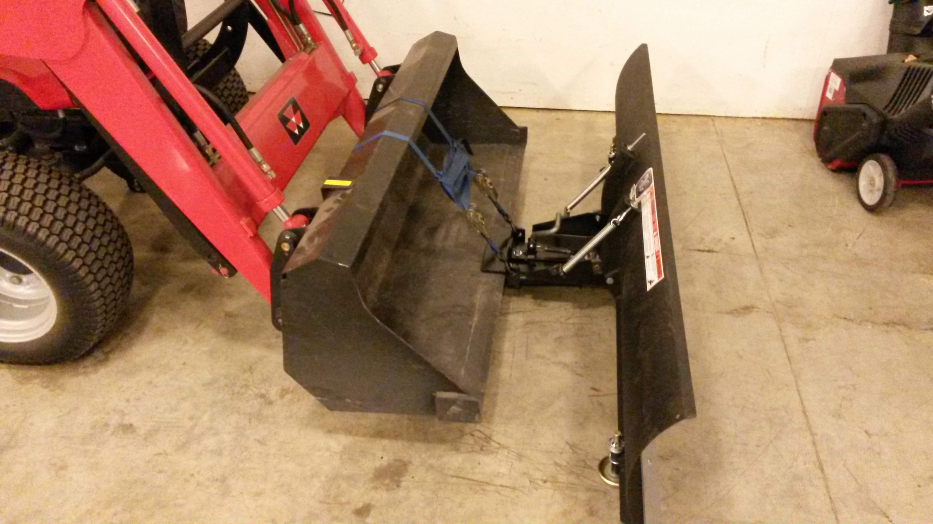

With 300' of private drive to take care of and plow the snow I have used the bucket and 6' back blade for the last 8 years but when there is a foot of snow or better and it sets up I need to push through the bucket first than work on it with the back blade. So I took a ATV snow plow mount with a 6' blade and fitted it to the front bucket.
Now this should keep the snow away this year.

Yes everything is set up so the blade can be removed in the time it takes to remove the ratchet straps. I went with the ATV plow for its light weight total weight is less than 100lbs and easy to slide on and off.

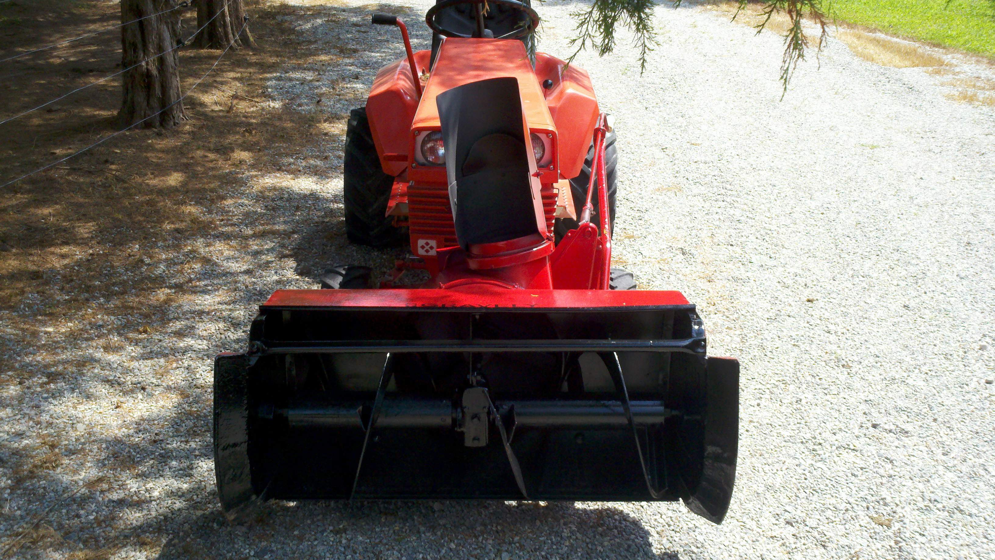

Never heard of a SNOWBLOWER
Nothing beats that when snow is involved...either front mount or 3 point hitch :thumbsup:
/ Ready for snow #8
Depends on the snow and how much. Plows are faster, but have limitations.

Just curious, what's going to keep it from pivoting when one side is loaded more than the other or you catch an edge?

I have used and owned a SNOWBLOWER but we usually don't have more than 6" at a time so the blade works great and I have adjustable dolly wheel's on it to keep it out of the rock. Besides Massy didn't make a front mount blower and a three point is out of the question to much looking back all the time.
The mount is locked to the bucket with the brackets and straps I don't think it is going to pivot but if is does I'll need to come up with a remedy.
I don't plan on running it on the ground but I will have to watch as I agree that the tractor has a lot more power-force available than a ATV.

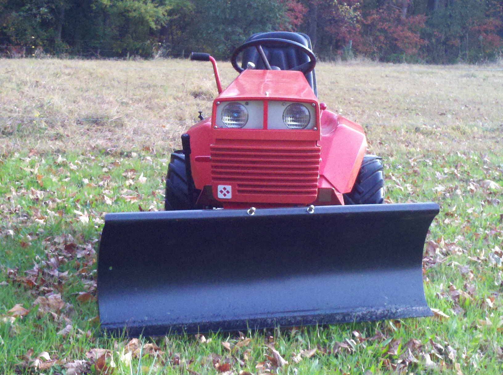

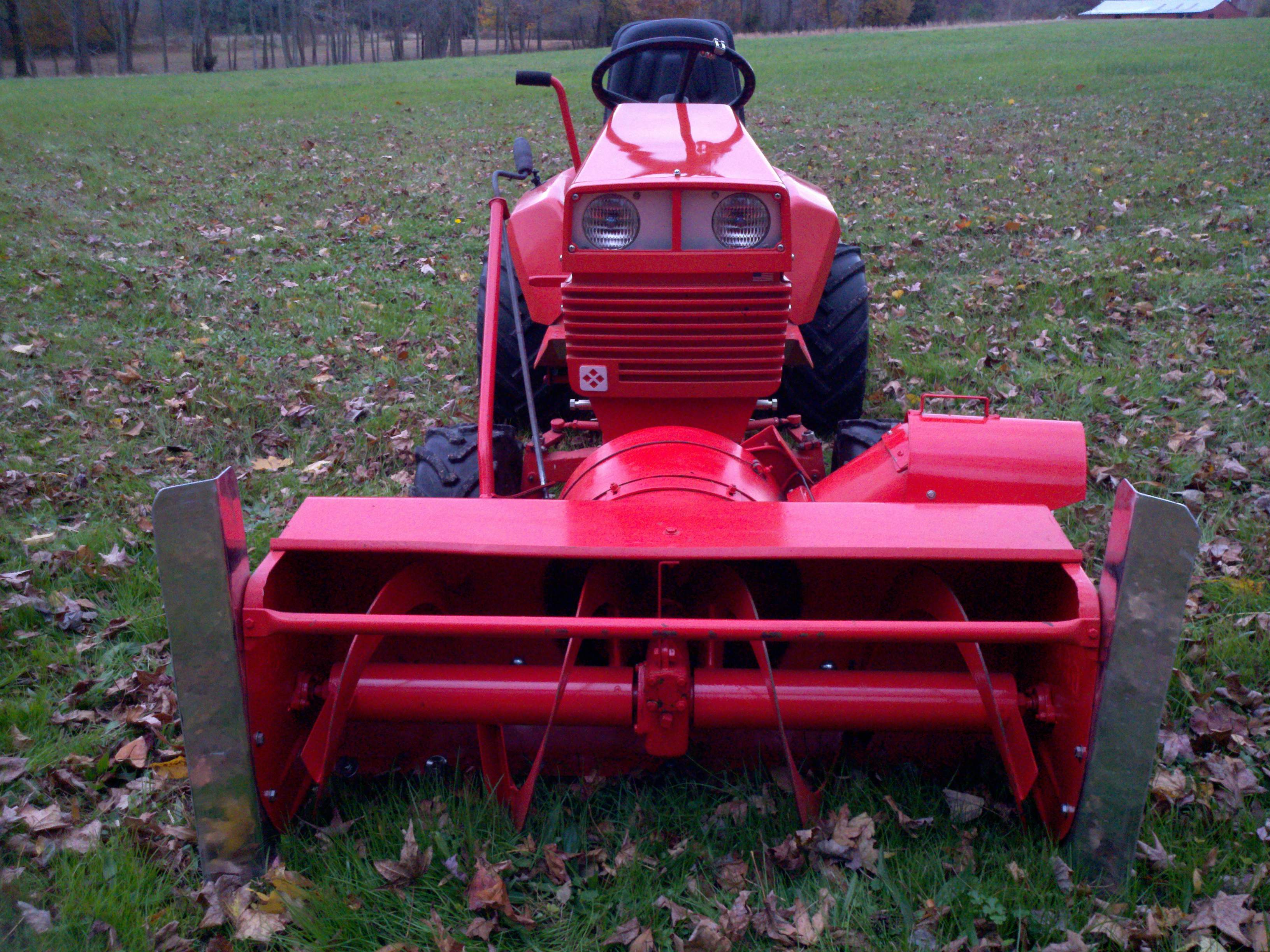

I'm just waiting for the snow.015.jpgGRAVELY Snow Cannon 113.jpg2014-07-31_14-37-41_169.jpg

Time for a update.
Well with the low snow amount this year I have had the chance to use the plow 3 times.
First time we had 5" of dry fluff and it worked great.
Second time it was a very wet heavy 6"+ dumping that I could not get to until the next day, temps fell and the snow froze up. It worked fairly good but would trip easy in the frozen snow. I had to remove the plow and use the bucket and back blade to finish up.
Last snow was dry and drifted, Worked great again.
Removing and re- installing the blade took less time than getting off and back on the tractor.
It stayed centered on the bucket and I don't think I will need to do anything to keep it centered on the bucket.
Think Spring..
