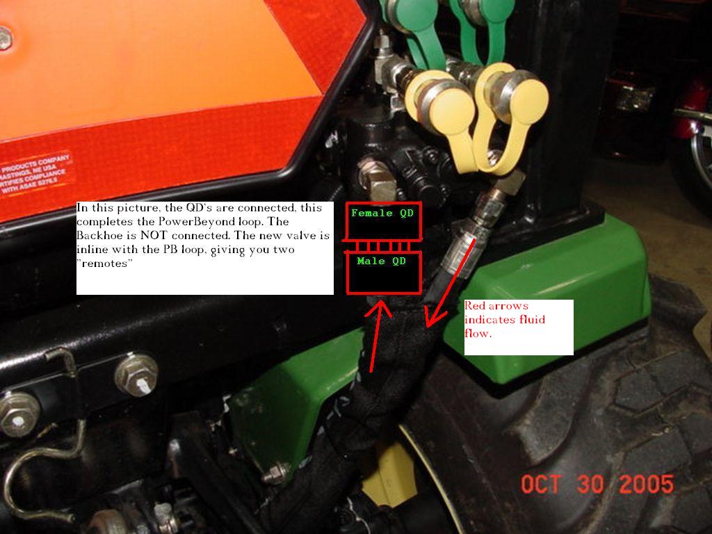

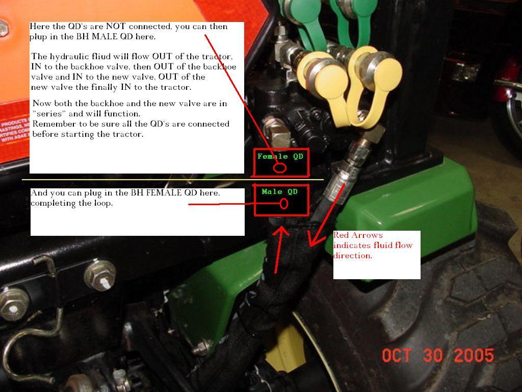

I guess what's getting me confused is/was my thinking that a 'second' inline valve must be fed from a PB outlet from the first valve ?
Here is the way I look at it...Does your backhoe valve have a PB port? How many hoses are connected to it?
The main problem on the JD's is that the FEL valve is mounted directly to the transmission case (unlike most other makes) and does not have ports like a regular valve...The PB kit that you have is really all we have to work with.
IF you can find a "tank" port on your machine, then you can use a PB equipped valve with the PB port feeding the backhoe and/or the 3PH.
Attached are two pictures from my album that I marked up for another user. Basically there are QD's on the IN side of the new valve where you would plug in the backhoe. I am thinking of changing my setup over the winter like this so I can add a 3PH logsplitter., and I have the QD's from the original PB kit that I never used.

Kenny, this quote from the other thread clears up a lot, thanks.
Since the functions would be mostly used one-at-time, just putting them in series without PB is perfectly fine.
