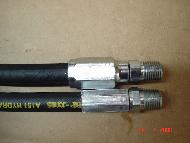

Here is the completed fitting. The stem should NOT be tightened to the collar-but rather a small gap left.
A very informative tutorial. One question... Why should the stem not be snugged to the collar? Years ago I bought a dozen short hoses with reusable fittings from a military surplus outlet associated with the Air Force in San Antonio. [This was a cheaper way to get the fittings.] The assemblys bear Mil Spec collars captured on the hose between the fittings. All the stems are snugged to the collars.
larry
larry
Larry, I wish I could answer your question with authority, but I was just following verbal instructions That I received from DHH when I called them. Maybe HHG can give us the reason.
/ Re-Usable Hydraulic Hose Fitting Tutorial #29
The nut-nipple of the fitting (female end) should not be snugged tight but just loose enough to allow the nut to be turned for installation and correct alignment of the hose without binding.
Jim
Thanks. Makes sense for fittings without a built in swivel function. The JIC females allow for that swivel inherently during installation and the nipple is also fitted with a hex to hold the nipple still in correct alignment while installing the finished hose, which explains why mine were snugged up.
larry
Jim
This doesn't make sense unless I'm missing something. A crimped fitting doesn't allow for this, why should a reusable?
Andy
Larry,
We are using instructions from one of our fitting manufacturers that recommend a gap 1/32" to 1/16" of an inch between the collar and the stem.
The reason for this gap is to avoid overtightening which may put additional stress on the stem. Some people, if told to tighten a bolt until it's snug, will continue to tighten it "just to make sure" it's snug. If this happens, you may stretch the stem, putting stress on the fitting that is not only unnecessary, but could possibly compromise the integrity of the stem. Theoretically, overtightening it dramatically could create enough stress that might at some date lead to the stem snapping off in the hose.
The gap eliminates this possibilty, so the gap is a good thing.
Ken Hutchinson

Thanks Ken... Sad... I was afraid that might be it so I used snug rather than :eek:tighten. Degrade the assembly by leaving a gap to protect against overtightening by the clueless. It is difficult to explain how to know when to stop, so stop before they even touch. I will go ahead and snug mine to unify the assembly as it should be.

I checked the Weatherhead instructions and they say to assemble them until the 2 halves touch. I guess either way would be acceptable as long as you don't overtighten as Ken says.
/ Re-Usable Hydraulic Hose Fitting Tutorial #38
Not trying to be a smart guy here, just want it to be right when some noobie searches. Once the fitting has been removed, the hose should have the end cut off before a fitting is installed again.
