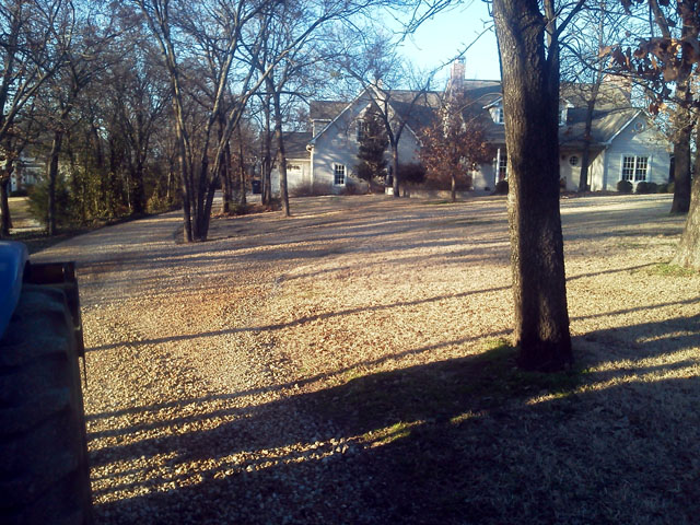

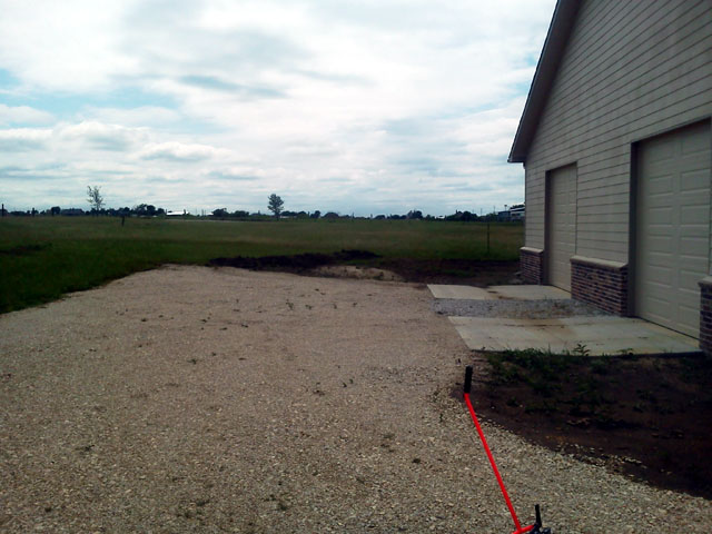

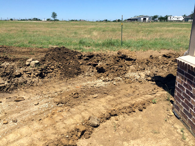

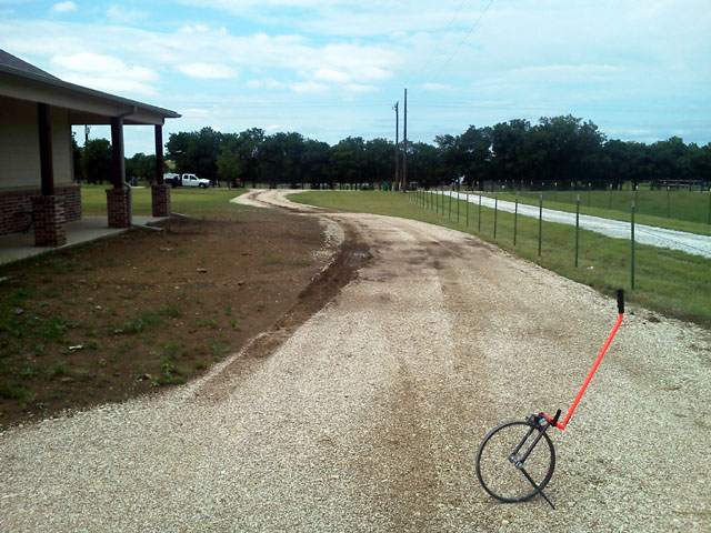

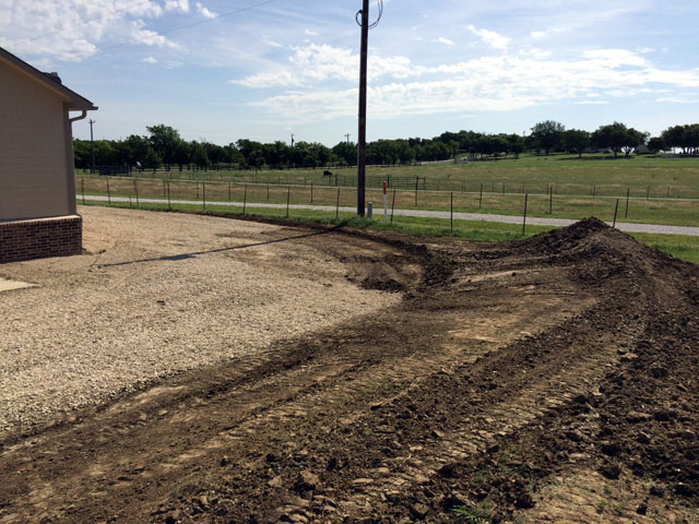

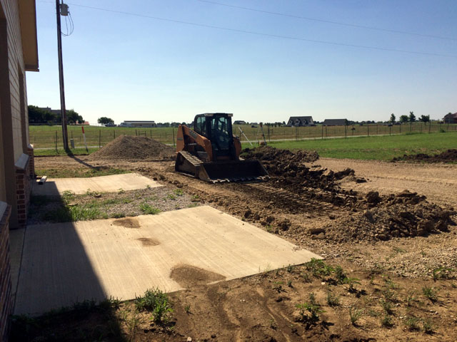

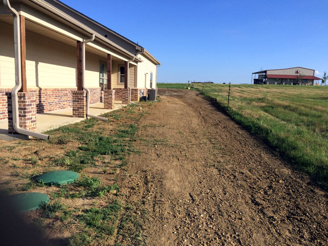

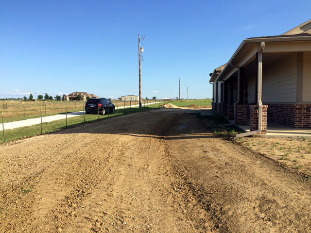

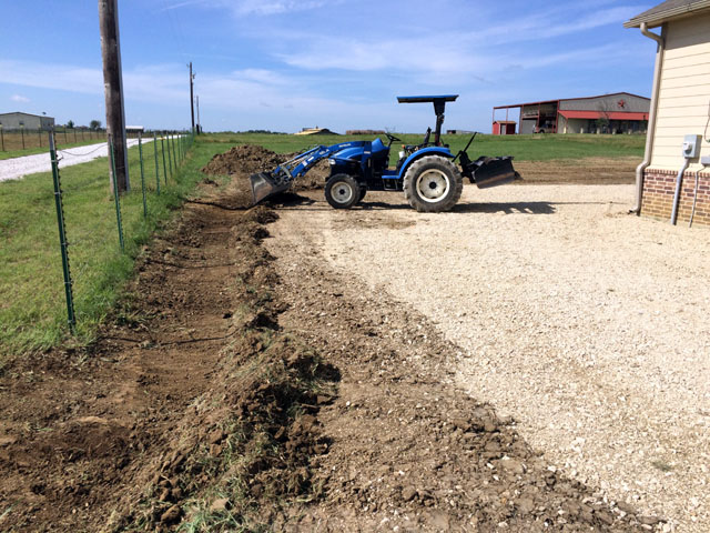

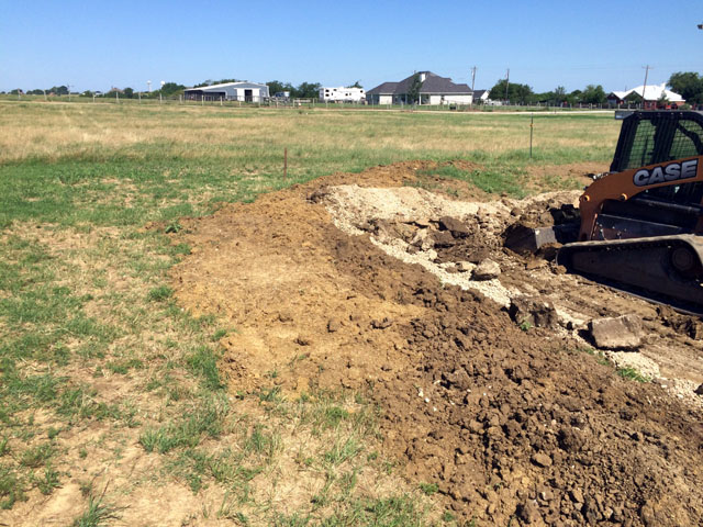

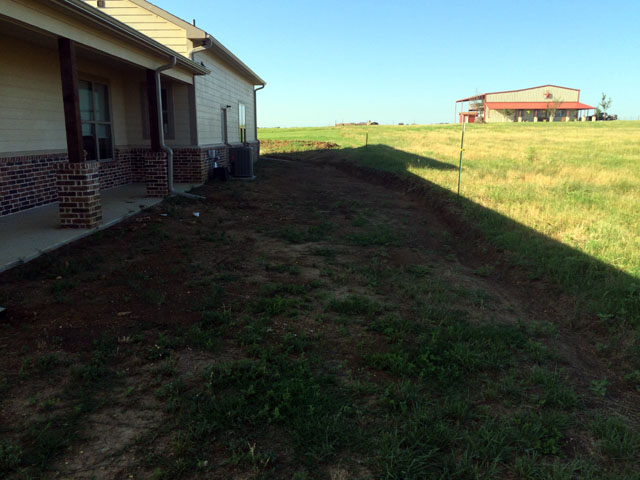

In the meantime, here's a few more pics from another job. I originally placed a culvert pipes and precast ends for this customer quite awhile ago. Their builder included the grading and gravel driveway into the price of the build. During the heavy rains this Spring the homeowner found out quickly that the builder's guys didn't do a very good job at getting the runoff away from the home, let alone getting it to the barditch at the front of the property. They had set it up with 12" of fall in less than 30' toward the garage and then directed the flow across the peagravel driveway. That, and they didn't provide any direction for the runoff from above the property or down the sides of the home. They came back to "fix" it on three separate occasions and it still ended up like this.
I stripped the peagravel off and started hogging out dirt to use for building up the driveway. There was so much loose peagravel that I ended up mixing it in with the soil to get rid of it.
In the middle of grading out the slope behind the garage, the tracks on my Case started popping pretty bad. I didn't want to break a track, and since I had new sprockets scheduled to arrive in the next few days, I took the Case home and picked up the blue wonder machine to finish up the job.
/ RDrancher's Photo Thread
#864
A few more...

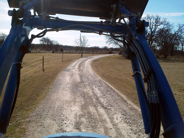

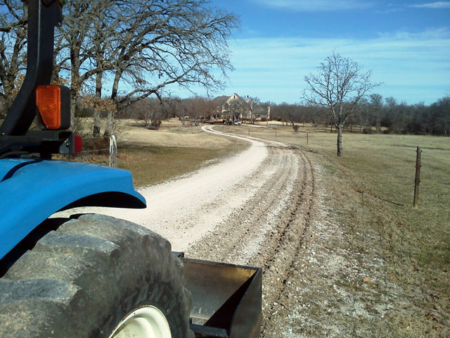

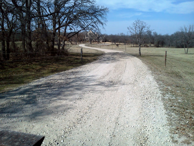

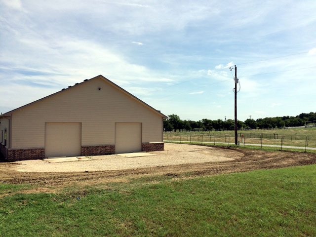

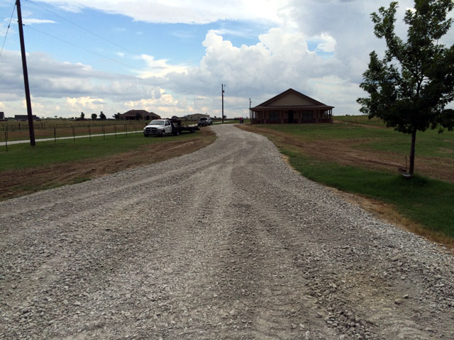

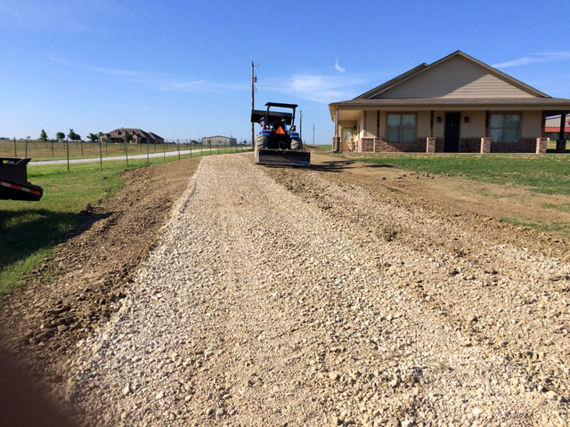

After getting everything fixed up, I spread five semi-loads of roadbase on the driveway. The larger stone and fines will hold up a lot better than peagravel. I only snapped a couple quick "finished" photos. Hard to see in the pics, but (yet another) storm was blowing in fast and it was starting to hail.

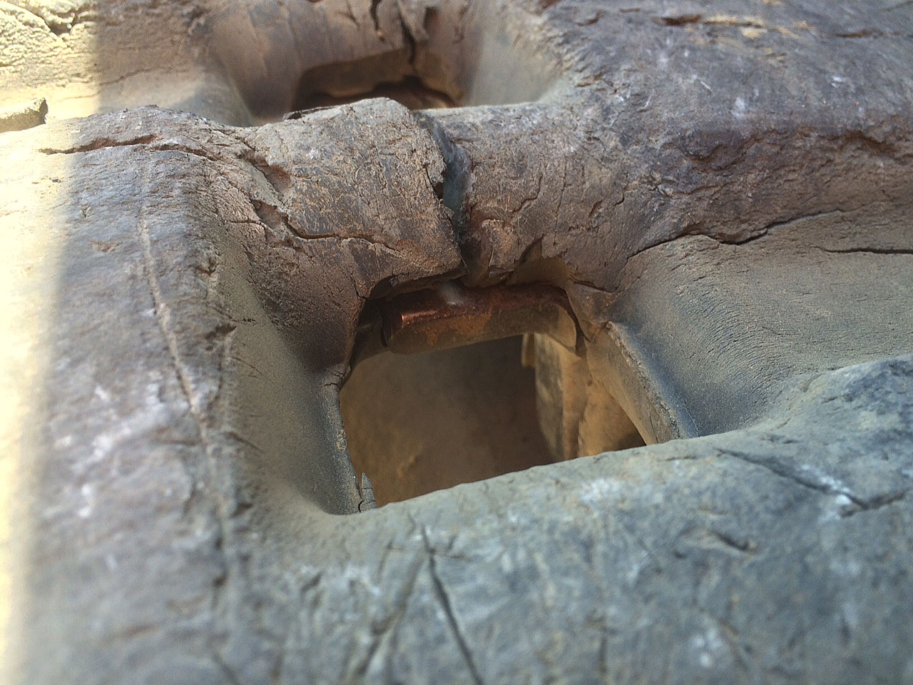

How many hours on your tracks? Seems kind of soon to be having to replace your sprockets
#866
As of today the OEM Bridgestone tracks are at 1230 hours. The tread is doing ok, even with a few deep cuts, but the insides are getting pretty bad, including the sprocket contact points. There's no rubber left there at all. I'll most likely run them until they die, which could be tomorrow or later this summer. The sprockets went past the point of functioning properly at 1205. I think the sprockets got a bunch of excess wear running in mud and wet sand this Spring. I'd post some photos of the old and new sprockets, but Verizon isn't cooperating. Basically, they were worn to points. Since I actually use reverse instead of spinning around at every opportunity, there was no "hooking" of the sprockets at all.
When I change out the tracks my plan is to get new sprockets and keep the semi-worn ones for later on.

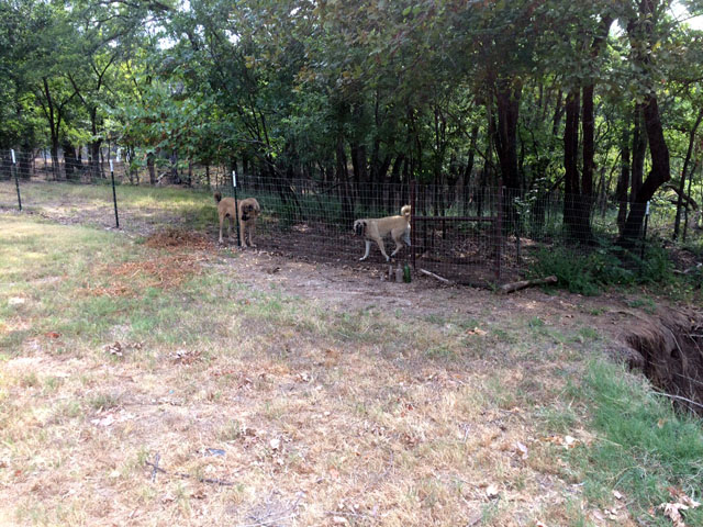

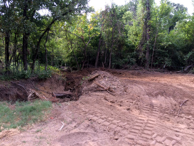

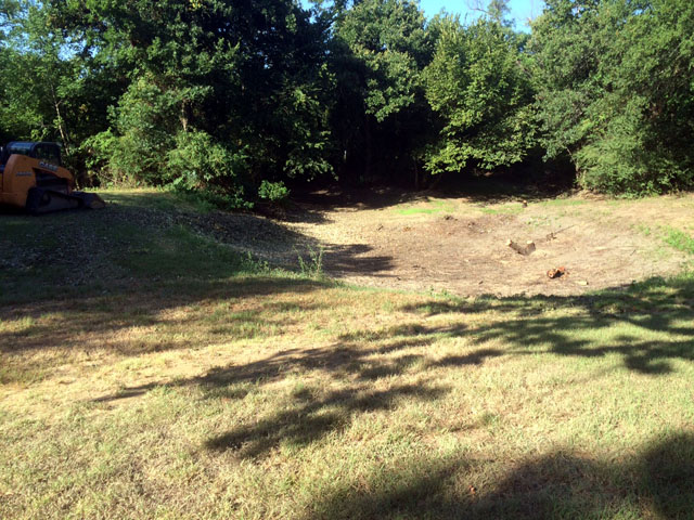

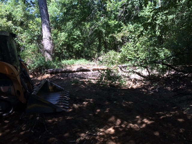

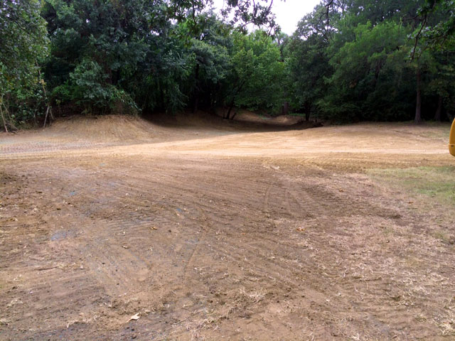

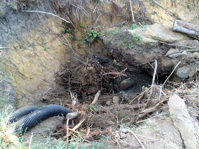

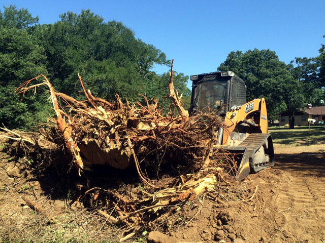

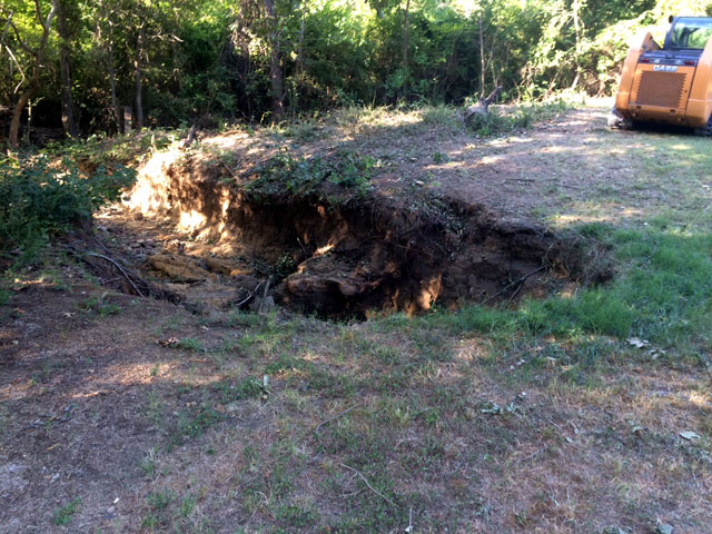

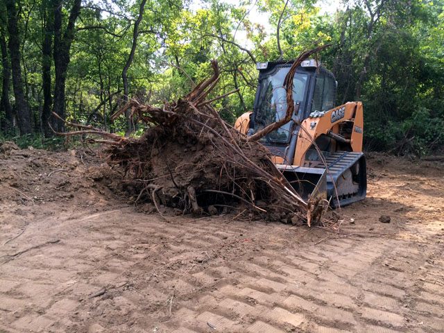

I've been busy and haven't posted any updates lately. Here's a few from the current job I'm on, filing in a pond and doing a bit of land sculpting. The pond was built to collect runoff from the subdivision, but the soil is too sandy and it became more of an eyesore and debris collector than a pond. The excavated dirt has been there for over twenty years and was covered with trees. The homeowners tree guys came in and cut off most of the trees at ground level, making them a pain to remove.
The hole behind the Case is over ten feet deep. I sure don't want to accidentally back into that one!

I had to pull off the pond job since one of the tracks was just begging to break. There are now two split steel lugs pulling through the rubber. I'll have new tracks and rear sprockets by Wednesday. Looking forward to a better ride and more traction.

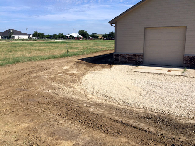

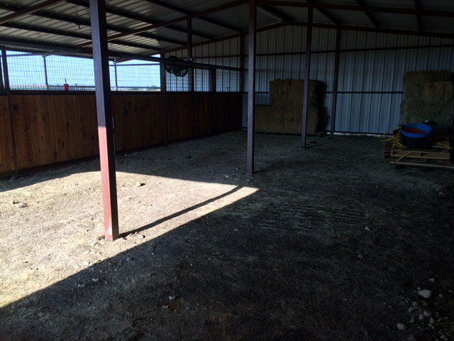

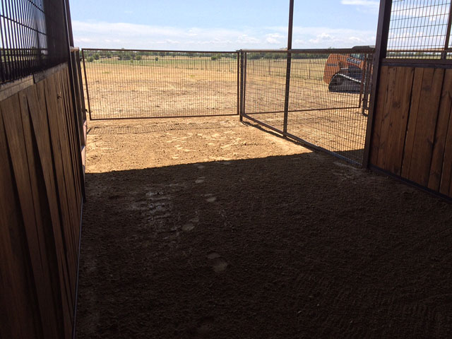

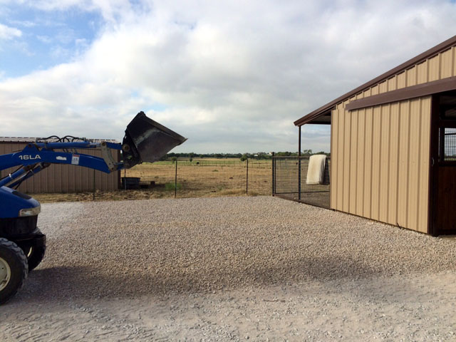

I finished this job early today, so I figured I'd update the thread. I put in this driveway a few years back. It still looked fine, but the new owners just had a barn built and wanted to get some additional work done.

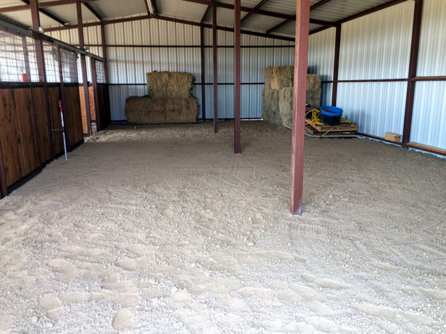

Two triaxle loads of clay based sand in the barn, stalls and turnouts. The customer didn't want to move the bales of hay. Says he'll always have pallets there anyway.

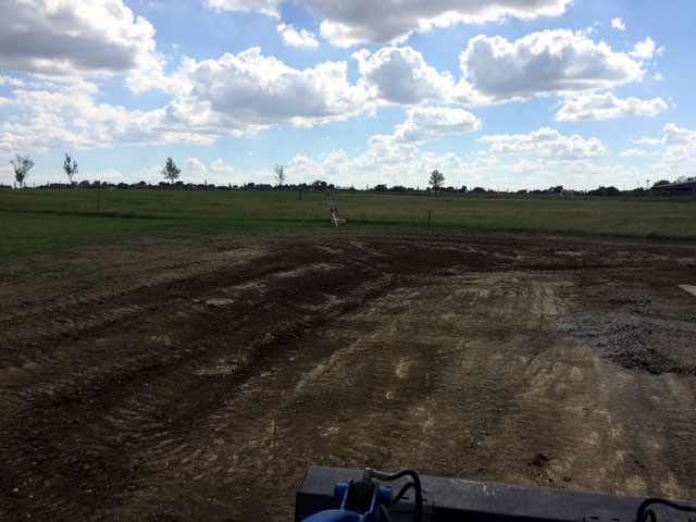

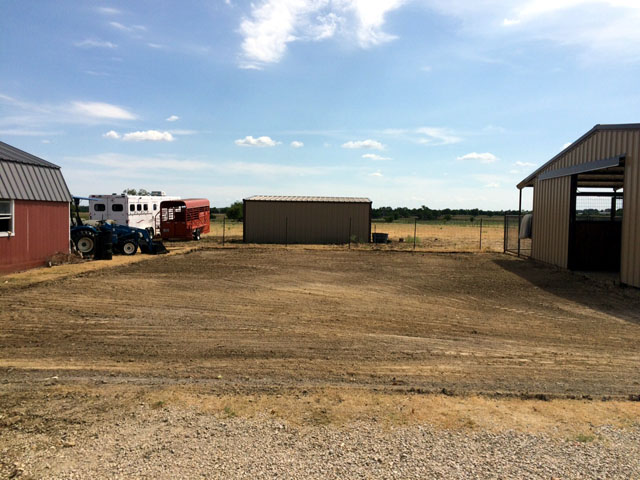

Graded the new trailer parking area and compacted the water and electrical ditches.
#873

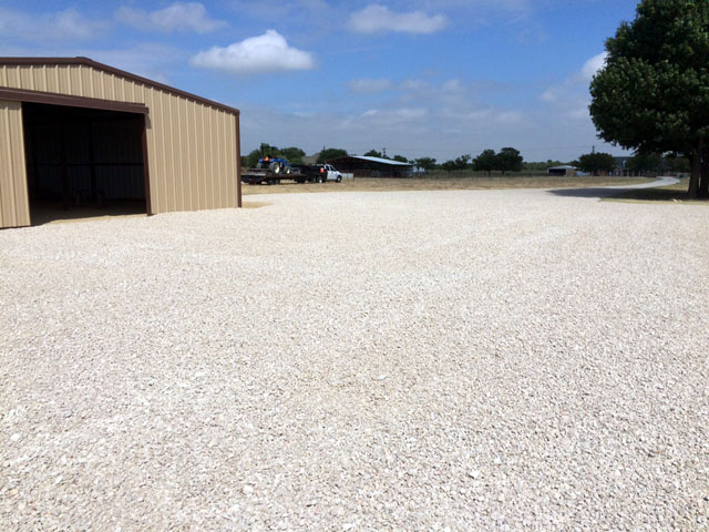

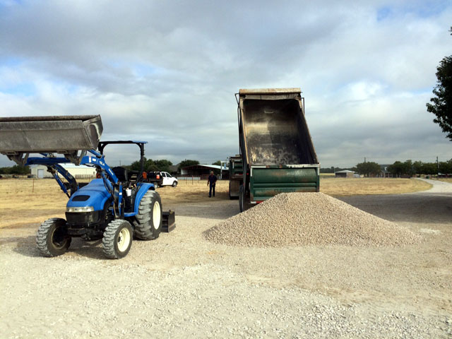

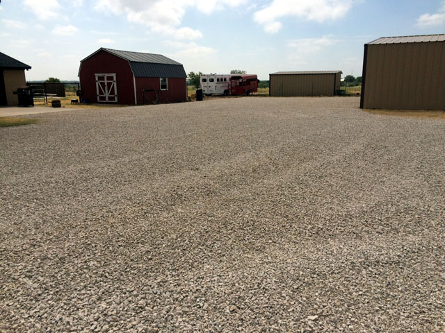

Placed and wheel-roll compacted 48 tons of roadbase and topped it with 24 tons of 3/4" minus crushed limestone. The turnaround area also had trenches through it, so I fixed them and spread the leftover stone.
You'll notice the customer's tractor sitting next to the shed in the first photos. I needed it moved, but he said it wouldn't start. I traced it down to the neutral safety switch. A little tweaking of the mount and it fired right up.

Looks as flat as a pool table. Sign me up for video lessons too! Good idea Pix.

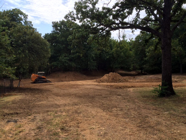

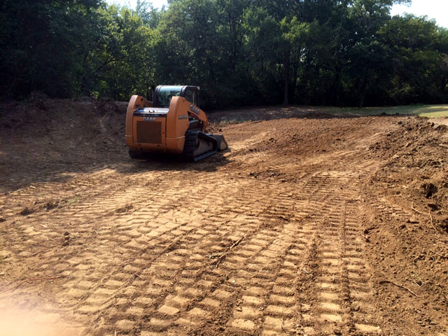

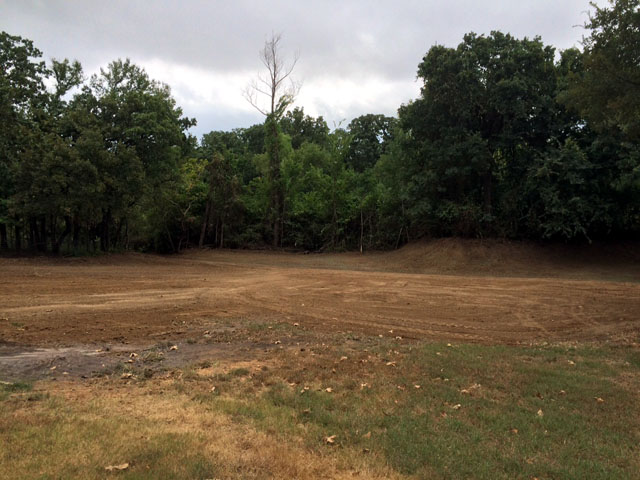

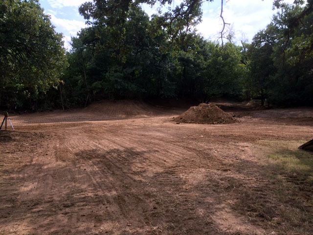

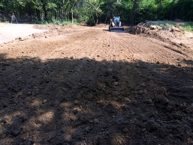

Here are the pics from the pond fill in I had to pull off of to put on new tracks.
#878

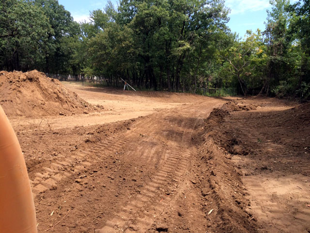

Cutting the new drainage path.

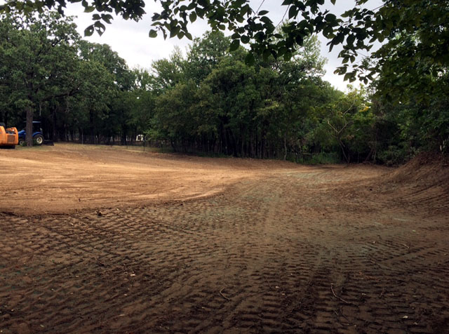

With less than 20 yards of dirt left to spread, the Case blew a quick attach hydraulic hose. The little blue wonder comes to the rescue again!
There was a lot of separating soil types on this one. Clay was saved for the drainage area, and sandy soil was mixed with topsoil and spread over the top of the filled pond.

Beautiful work. You make dirt look like art!!!!
