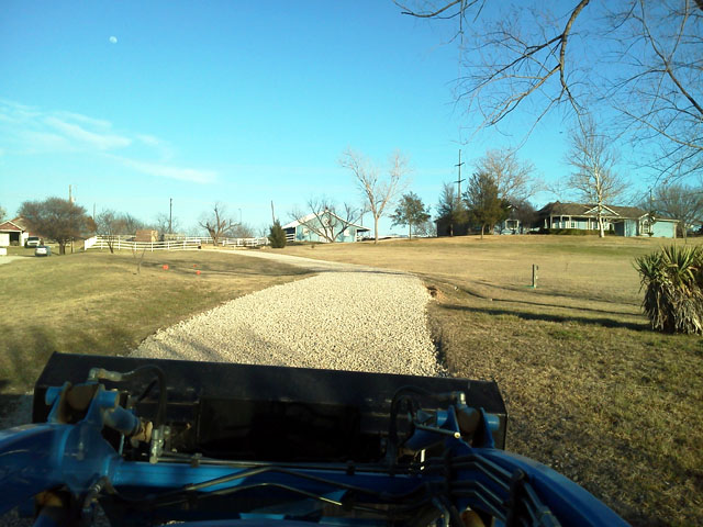

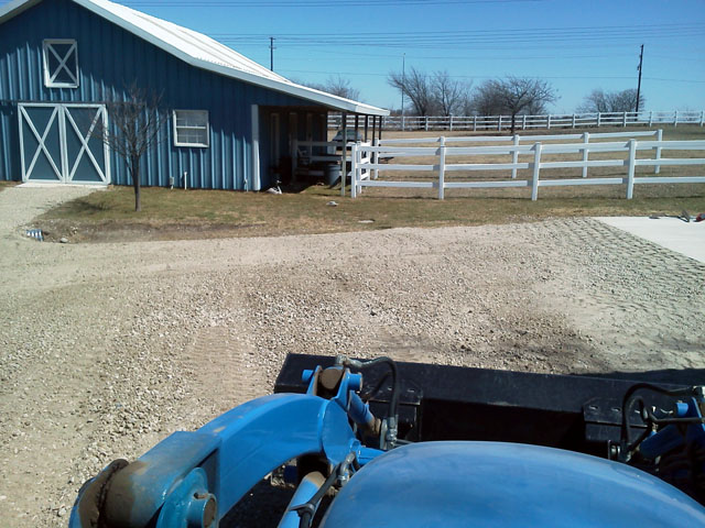

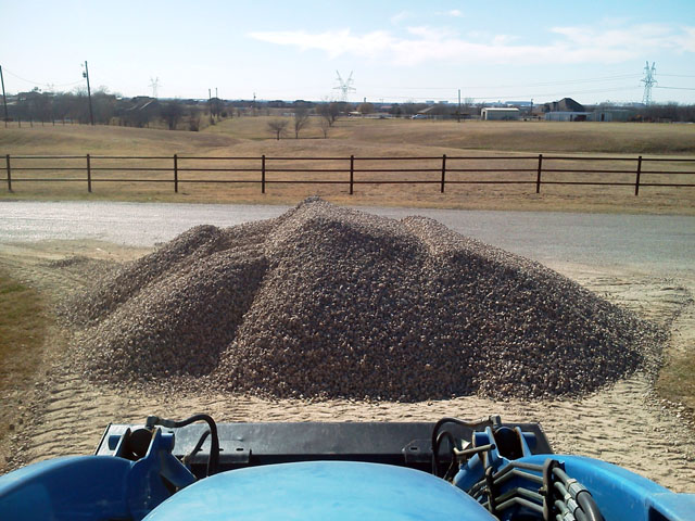

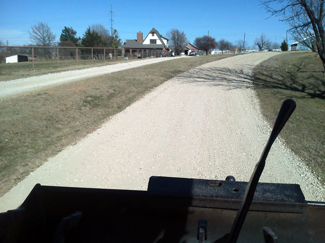

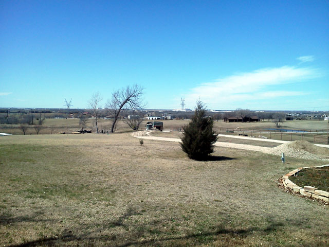

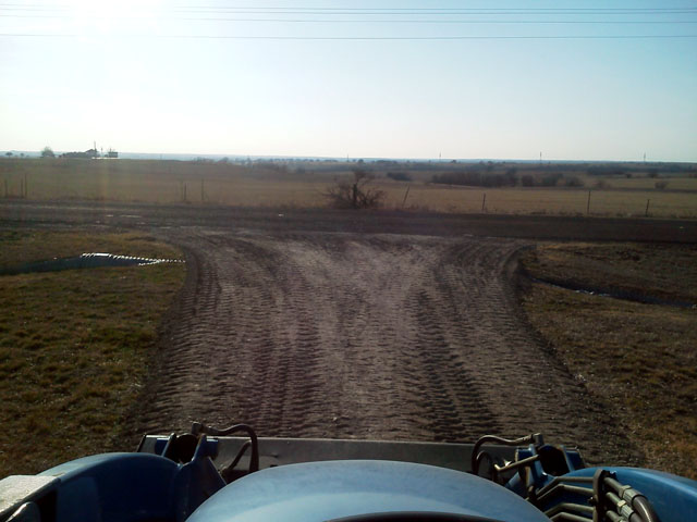

Placed and wheel-roll compacted 48 tons of roadbase and topped it with 24 tons of 3/4" minus crushed limestone. The turnaround area also had trenches through it, so I fixed them and spread the leftover stone.
View attachment 440791 View attachment 440790 View attachment 440792 View attachment 440793 View attachment 440794 View attachment 440795
You'll notice the customer's tractor sitting next to the shed in the first photos. I needed it moved, but he said it wouldn't start. I traced it down to the neutral safety switch. A little tweaking of the mount and it fired right up.
