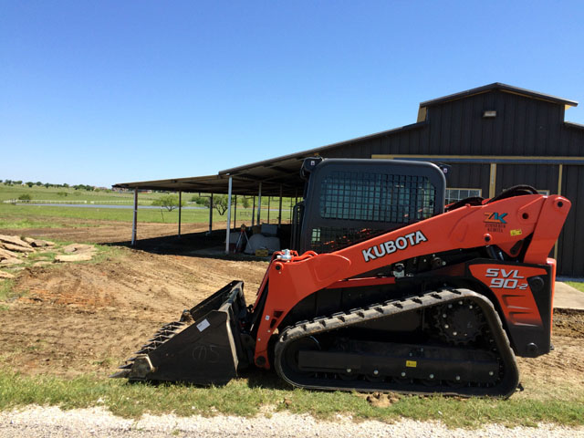

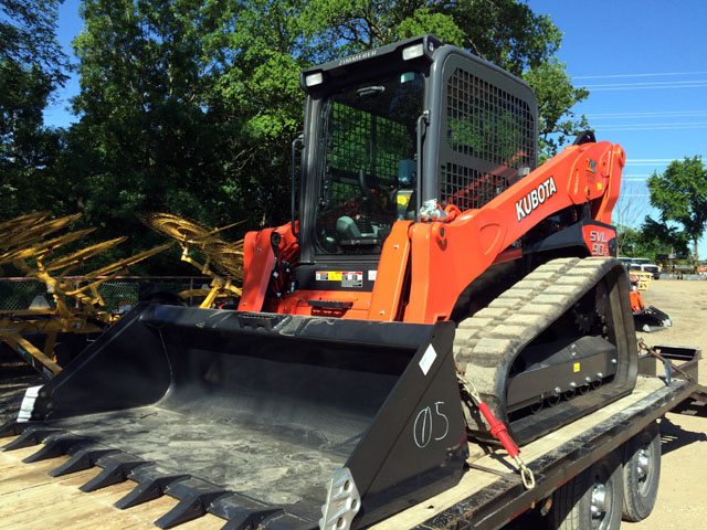

For a long time I've been on pins and needles waiting for the Case to break something else BIG. Well, I decided to beat it at its own game. Here's a few photos of my new SVL90.
Picking her up from the dealer.
First day on the job.
I feel truly blessed!

/ RDrancher's Photo Thread #910
That is a nice looking machine. The artist has a new brush. ...enjoy!
/ RDrancher's Photo Thread #911
That SVL90 looks like a tank. Hope it givess you thousands of hours of trouble free use, does ol blue still get used much?
#912
Neat :thumbsup:
Oooh that looks like fun!:thumbsup:
Very nice. Let us know how it compares to your Case.
Congratulations! :thumbsup:
Thanks guys!
Thanks GP! I pretty much only use the old NH for spreading gravel and I seem to be using it less and less for that too. My wife actually uses it more than I do, running a brush hog here at our place and straightening up her horsey stuff.
