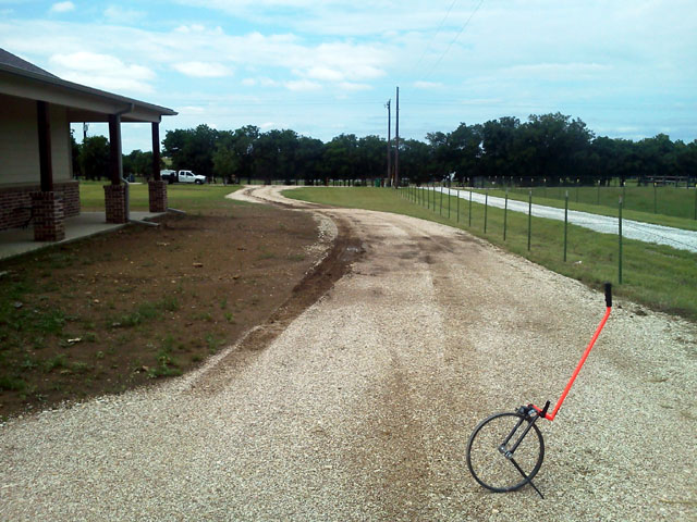

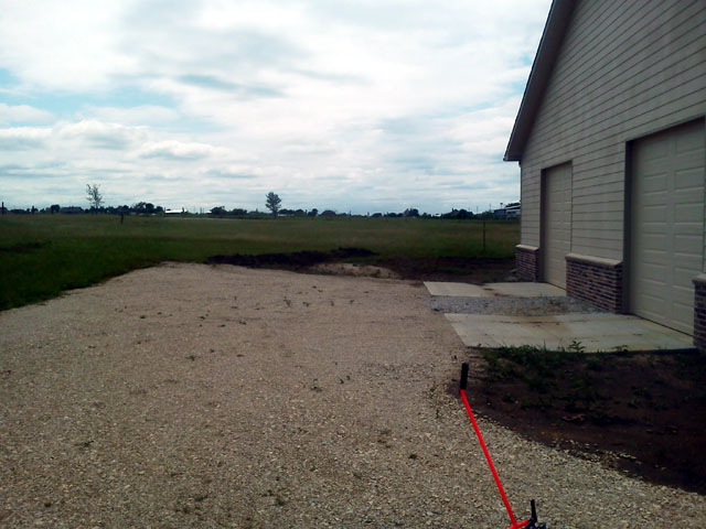

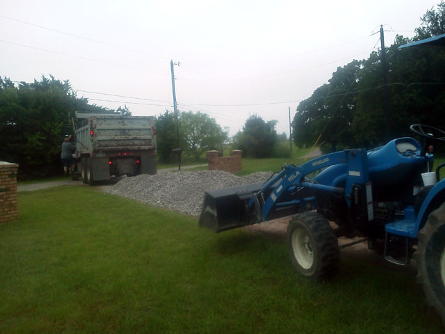

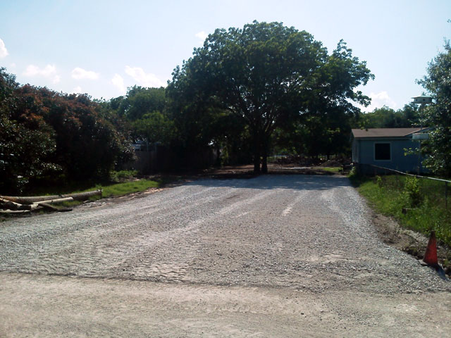

Week after week of rain, flooding, hail and tornadoes...I'm sure not getting a lot done this spring!
I did get the surge rock and driveway covered in gravel at the tree guy's place, so at least they have somewhere to park. Lot's of work to do there still, but the ground is too soft to get it done.

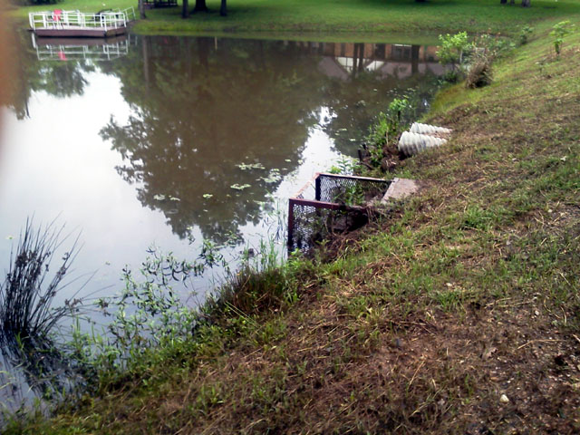

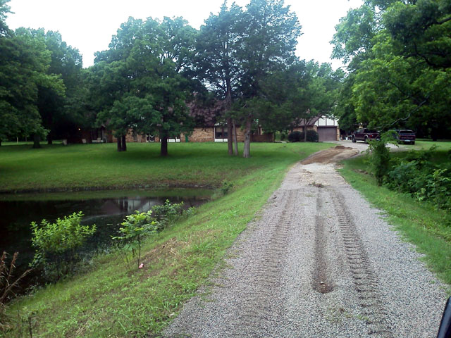

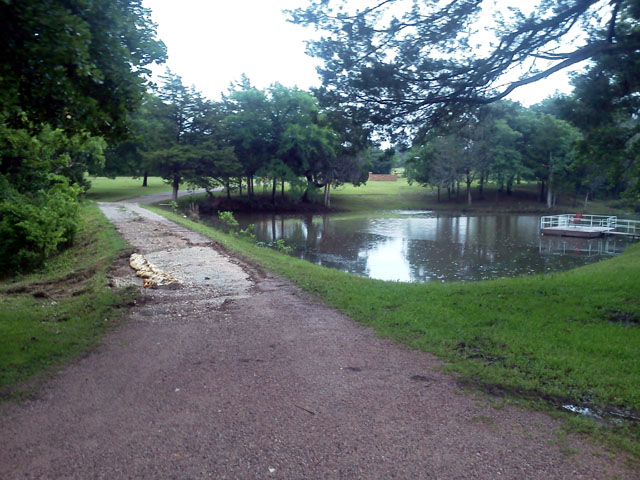

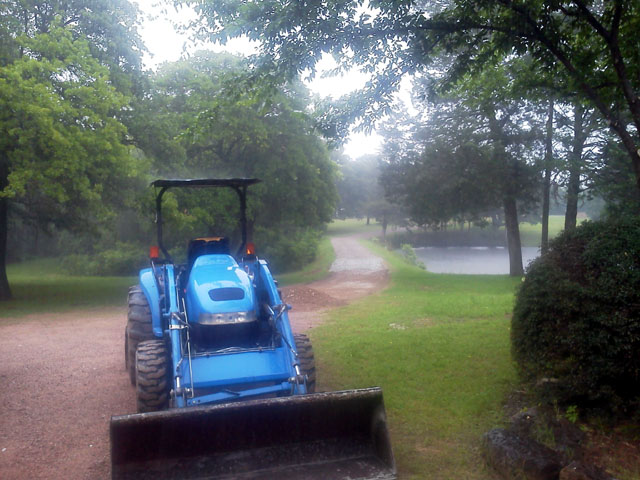

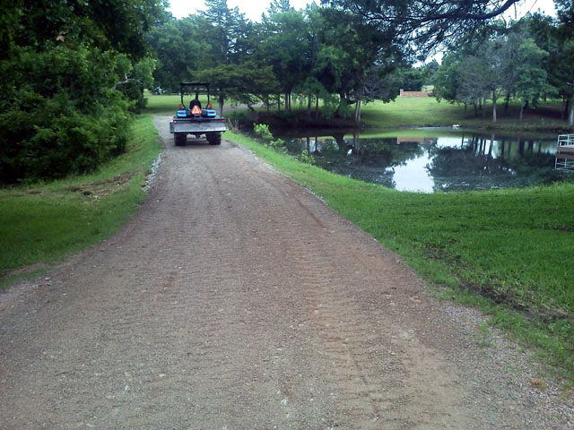

This pond is the last in a series of ponds. The outlet pipes dump into a stream bed. At some time in the past the original pipe was filled with concrete and two 15" pipes added. With so much flooding going on around here the two pipes couldn't handle the flow, so the water not only went over the designed overflow, but also took out the driveway closer to the home. There aren't any seep collars on the original or added pipes, so the dam has begun to leak next to the pipes as well. I have a plan to fix the problem later this spring, but the homeowner is hosting a wedding here in the next week and wanted to repair the damaged driveway for now.

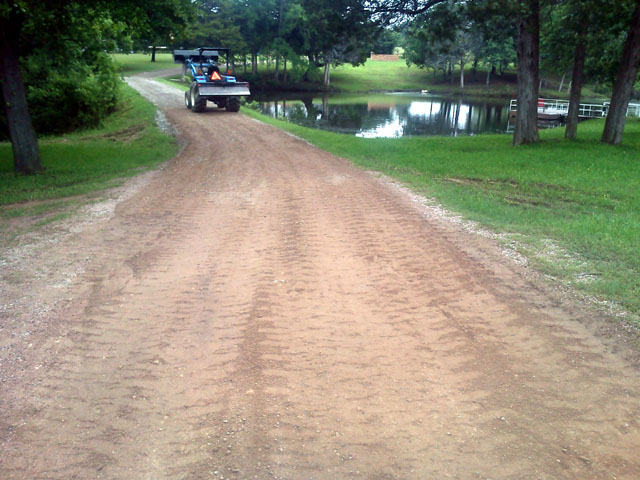

The existing base material here is a brownish 3/4" minus with a topping of useless granite peagravel. The base works in some areas, but it doesn't pack very well if it's laid down too thick. I pulled the peagravel and base back, then used 1.5" roadbase for the repair. After compacting the roadbase and spreading the existing materials back over the top, the driveway should be fine for the wedding. It rained pretty hard for about twenty minutes, so I sat it out in the garage.

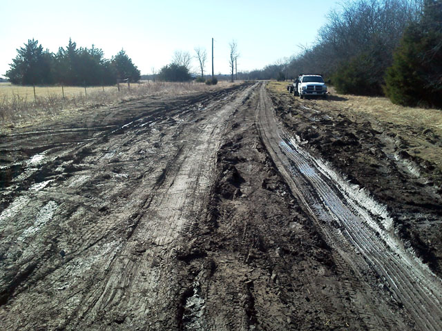

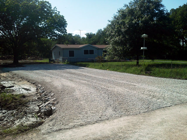

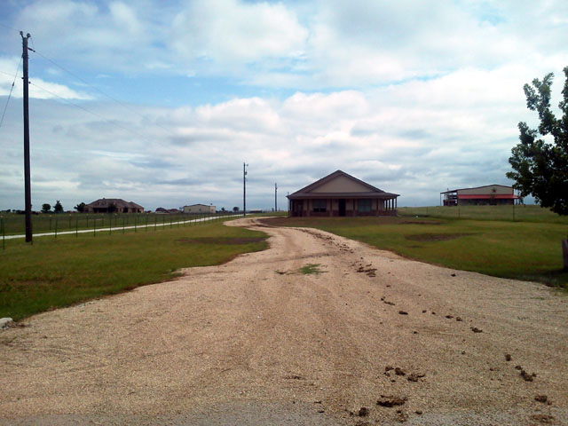

I would like to publicly thank my competitors for selecting unsuitable (cheap) material and showing a complete disregard for proper drainage (as usual.) I set a culvert pipe and precast concrete ends for this customer last year. Their builder included the grading and a gravel driveway in the price of the build. They used a couple inches of uncrushed river stone as a base with a few inches of uncrushed peagravel as a topping. Hard to see, but in the third photo the driveway is sloped more than 12" to the right.

Do you think they used the river rock because it's cheaper? I'm always amazed how often people spend thousands of dollars on the wrong materials when it would have just added a few hundred bucks to get the right material the first time. I see this in homes all the time when they use lumber too small for the span. The next size up is just a couple bucks times the number of boards they needed for grand total of less then $100 they could have done it right the first time. But now they have to spend thousands for me to tear it all out and redo it. Just crazy.
Eddie
/ RDrancher's Photo Thread
#837
The material is local and cheaper, and the trucking is cheaper too. I see this with a lot of rural home builders since by this time in the project they're trying to get the keys handed to the homeowner, get paid and get out. They include the driveway in the price of the home and then use the same cheapy guys that built the pad out of onsite expansive soil...with a little topsoil mixed in for good measure.
The only materials I purchase from the local pit are sand and small rip rap if it's suitable for the job.

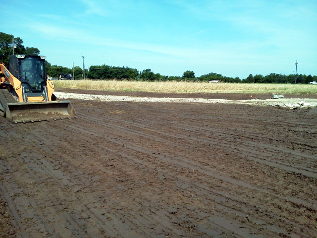

It finally quit raining, but the first job this week got off to a rocky start. This customer has an easement around a small plot that a local farmer works. I built a new road through the easement a couple of years ago and included a culvert [pipe across the road. Every time the farmer plows the drainage changes a bit, so we decided to grade out a larger swale, install a second pipe and also lengthen the original pipe by two feet. I also touched up the road while I was onsite. The job is only seven miles from my culvert supplier, but with several major water crossings closed near Lake Ray Roberts, it took a seventy mile round-trip to pickup the pipe. That, and the little issue of sinking the tractor the first day turned a simple one day job into two.

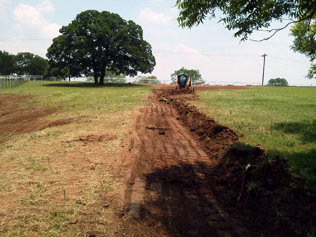

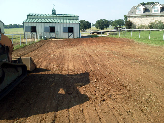

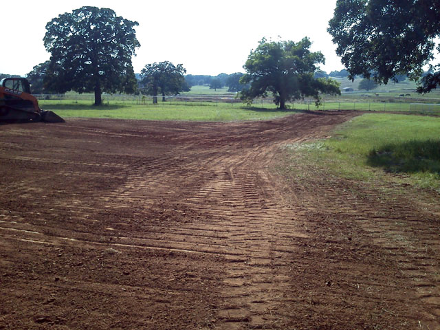

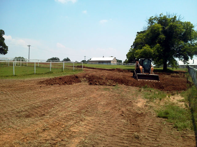

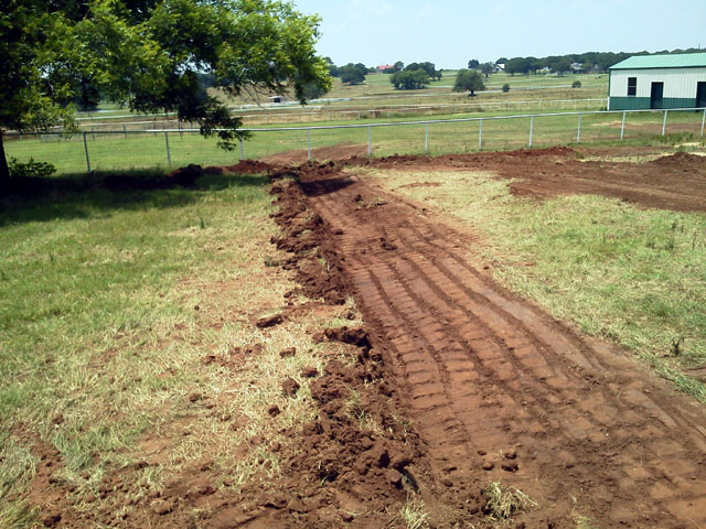

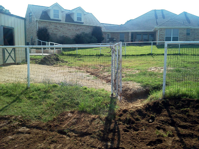

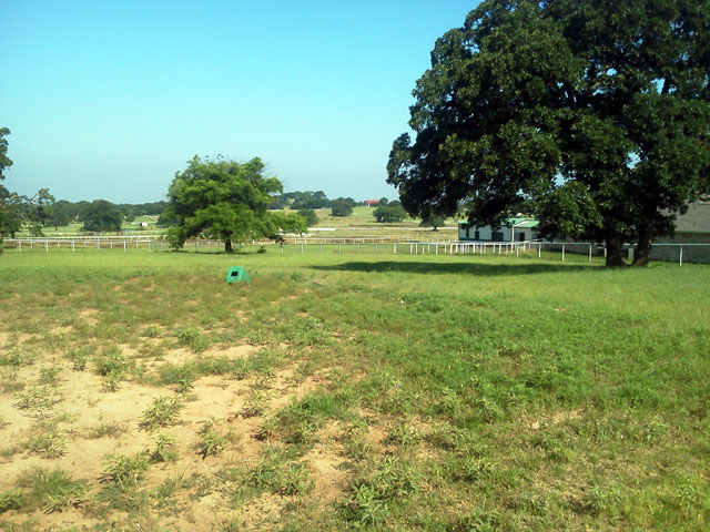

With most of my jobsites still a tad too wet, I headed for this one in sandier soil on top of a hill. The county resurfaced the road and basically eliminated the bar-ditch along the frontage. The change assisted in washing out the customers arena and diverted the flow away from the natural drainage doing damage to the area between their home and barn. Here are the photos of the bar-ditch and graded area. I also regraded the arena and the area above it. I'll post those photos after I place sand.
