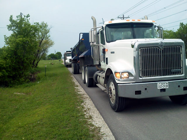

Strange week indeed. The sun finally came out, but the pits didn't start crushing material until Tuesday evening. The material was still too wet for my liking on Wednesday, so I hustled to get a couple of jobs done yesterday and today.
First one...graded and cut a small swale followed by three semi loads of concrete washout and a topping of 3/4 minus.
Second one...Graded, cut swales and used the excess dirt to repair all the damage done by the concrete truck and crew when they poured the shop slab/footing. Topped it off with two truck & pup loads of crushed limestone road base. No way was I going to back the trucks over the homeowners already cracked concrete, so I shuttled from the street.

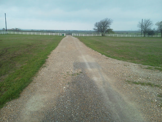

I knocked out a few one day jobs this week to catch up a bit.

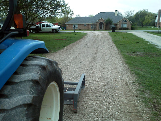

I broke out my LPGS this week to give it another try. First job with the landplane was to re-grade this gravel driveway. I think I'll have to modify my landplane to make it work the way I want it to. First thing is to cut off the annoying skids so I can get a nicer edge.

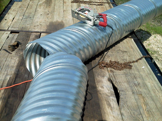

Cut and installed a couple of culvert extensions to widen a driveway entrance for a customer with a new travel trailer. Removed rip-rap, installed the pipe ends and bands, backfilled with some roadbase and re-stacked the rip-rap. Sorry, only took one exciting photo.

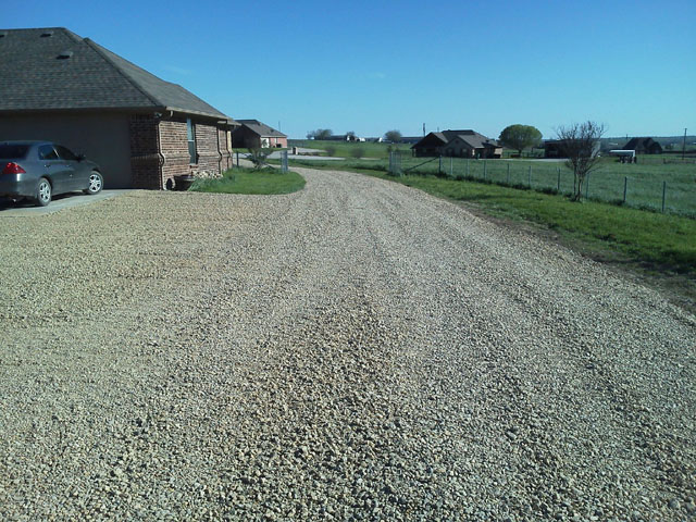

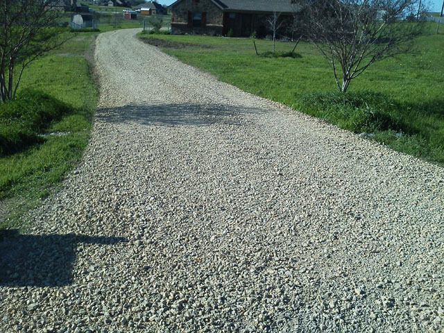

Here's another driveway regraded and topped using the landplane. I also cut better drainage heading toward the front yard from the concrete apron. I also re-graded the neighbor's driveway while I waited for my load of rock.

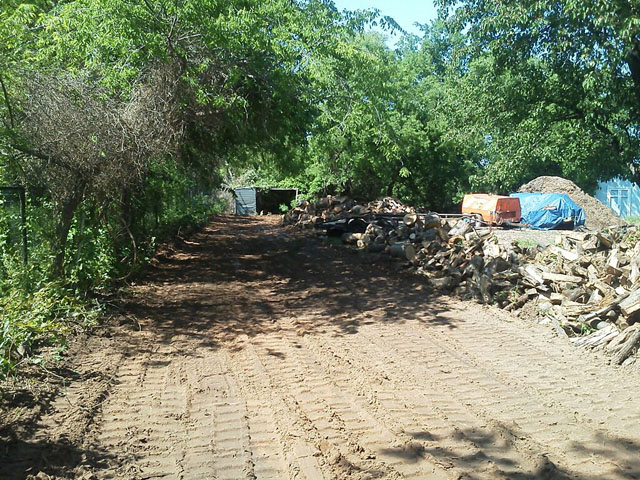

After getting 3" of rain Saturday night I started on the mudbog today. This job is right behind the campground I mulched and built last summer. It's at the lowest elevation in the neighborhood. A tree company processes all of their firewood here and at somewhere along the line they thought that a wood chip driveway to the back would be a good idea. The uploader loaded the photos in random order this time....... :confused2:
