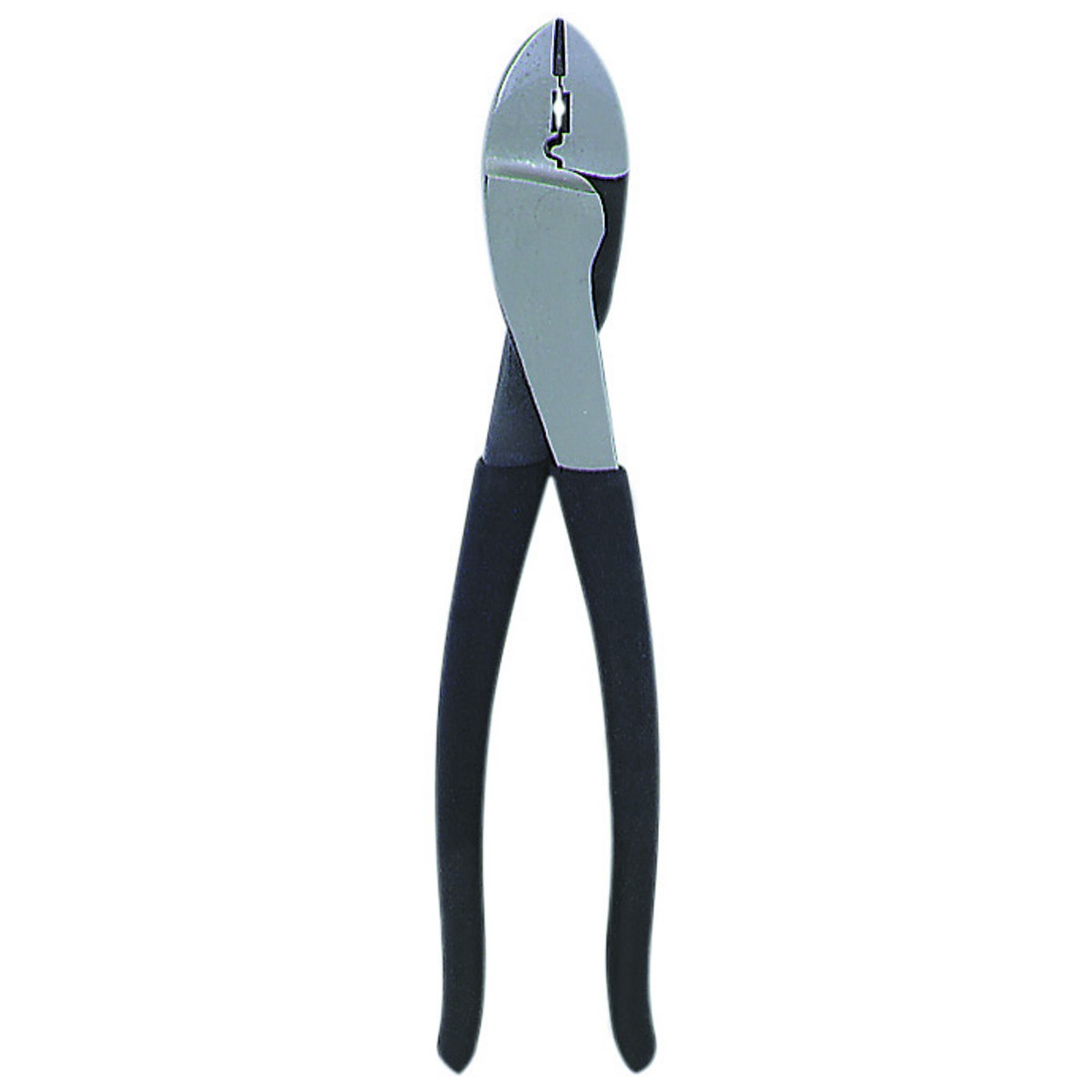

Butt connectors were my last choice but you can get an okay job done with them if you take your time. Use the black handled style as mentioned above and after crimping each side of each connector do a "tug test" on the wire before you move to the next crimp. Hold the butt connector and the wire in separate hands and tug it back and forth. If you feel ANY movement, you have a bad crimp and it could cause you problems. Re-do each of those. The other problem, is that you will have a huge knot of connectors at the chew spot. Try to stagger them if you can. Good Luck !!
/ Rat Disaster. Need Electrical Help. #24
Good advice given above. I might heat shrink and solder.. but I have soldered for decades.. The butt splices can work and work well. I have an antenna that in one part of its span about 86 feet, is put back together with them.. with 2 bricks for weight on the dacron rope ends over the tree branch.. Has been good for at least 2 years now, survived many a wind story..
Key is getting the proper size for the proper wires.. red (small) blue (med.) and yellow (large). And making a proper crimp with a proper tool.. Yes get the good one not the stamped out piece of sheet metal one.
Stagger the butt splices, with proper wire in between, so two splices for each wire. Strain test each one before moving on to the next. Or if you practice a bit, you can use solder and heat shrink.. I recommend the heat gun to shrink it. Other things can work, but the heat gun is best.

You guys are great. To answer a few questions: It looks difficult to get the dash end of the harness out of the dash unit. There is a rubber seal that feels like it will come apart if I pull on it too much. Possibly with some TLC I could get all that loose and it would make it much easier to solder etc. As far as the crimp tool, I have one like the black one in the picture; actually nicer than that. As far as butt connectors, I used a different type on our RC race trucks but a lot of guys used the heat shrink wrapped ones in their trucks. They held and believe me those trucks took a beating.
I honestly wish I could solder better and if so I'd definitely go that route but given my lack of skills I think I'll go with the butt connectors. Yes, they will take up more space but there is plenty of space behind the dash. Too much really.......that's why the mouse was in there. I will stagger them.
