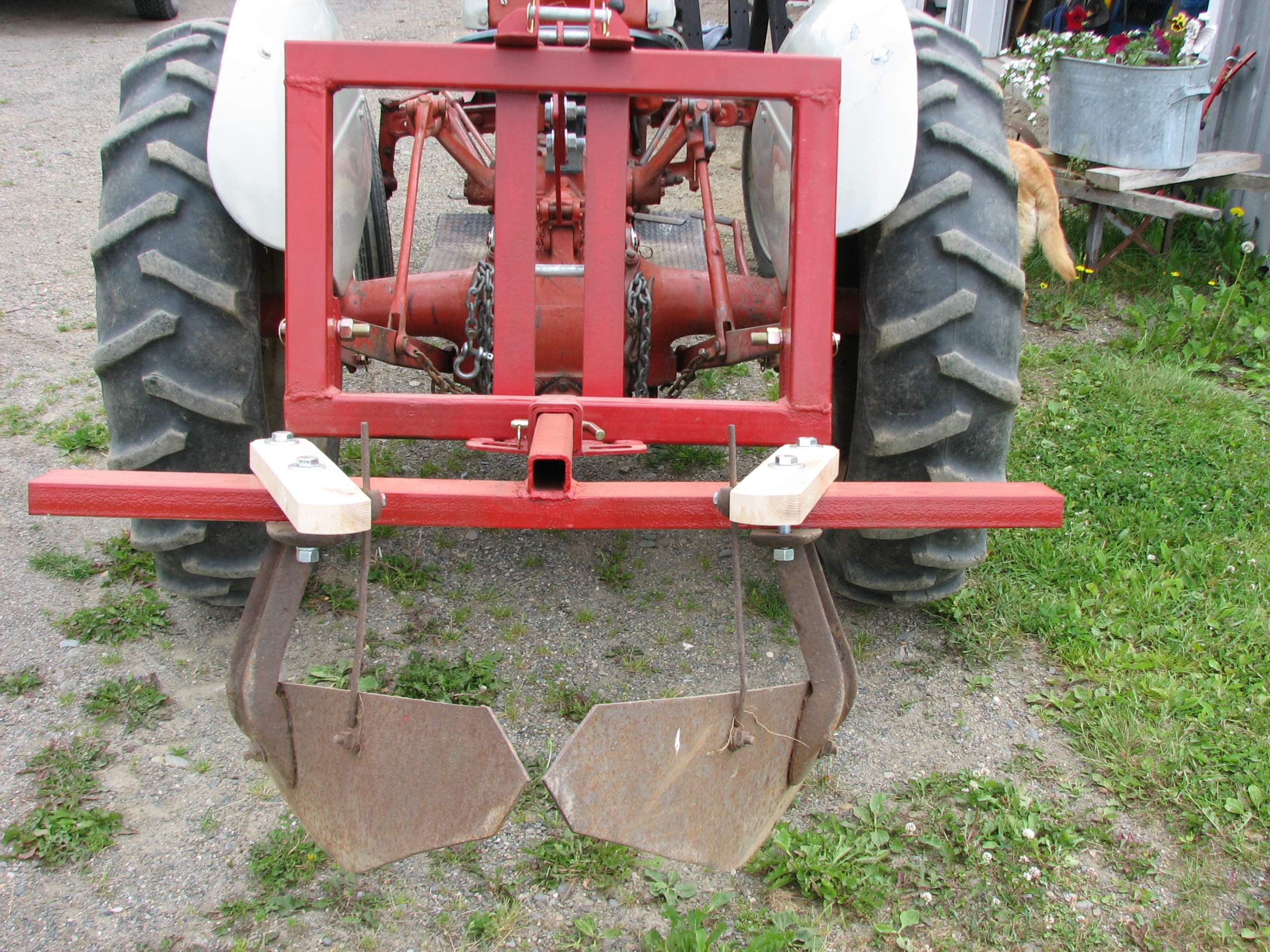

This is what I built to hold shanks on a 5' universal tool bar...
Works OK.
Good luck

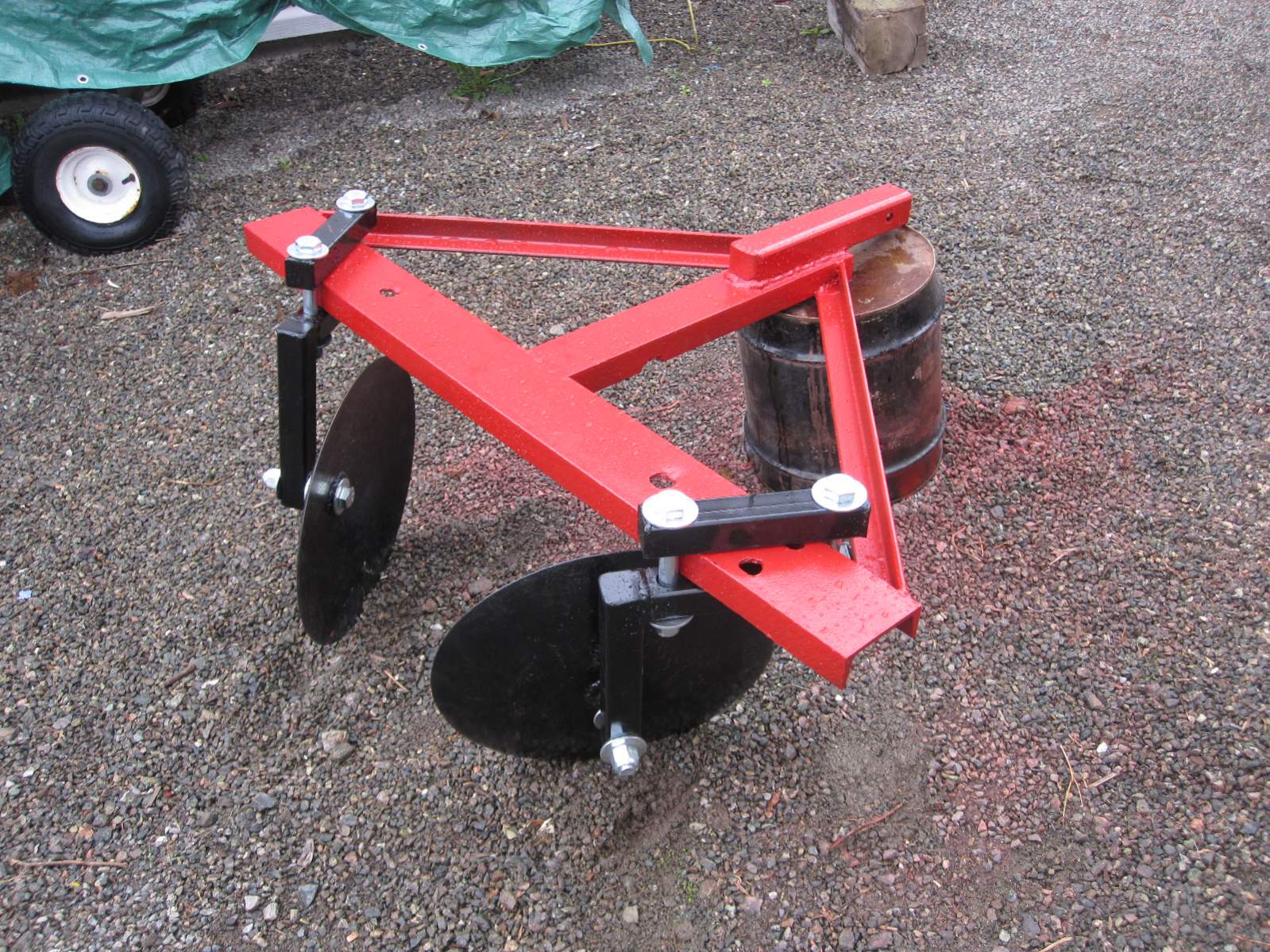

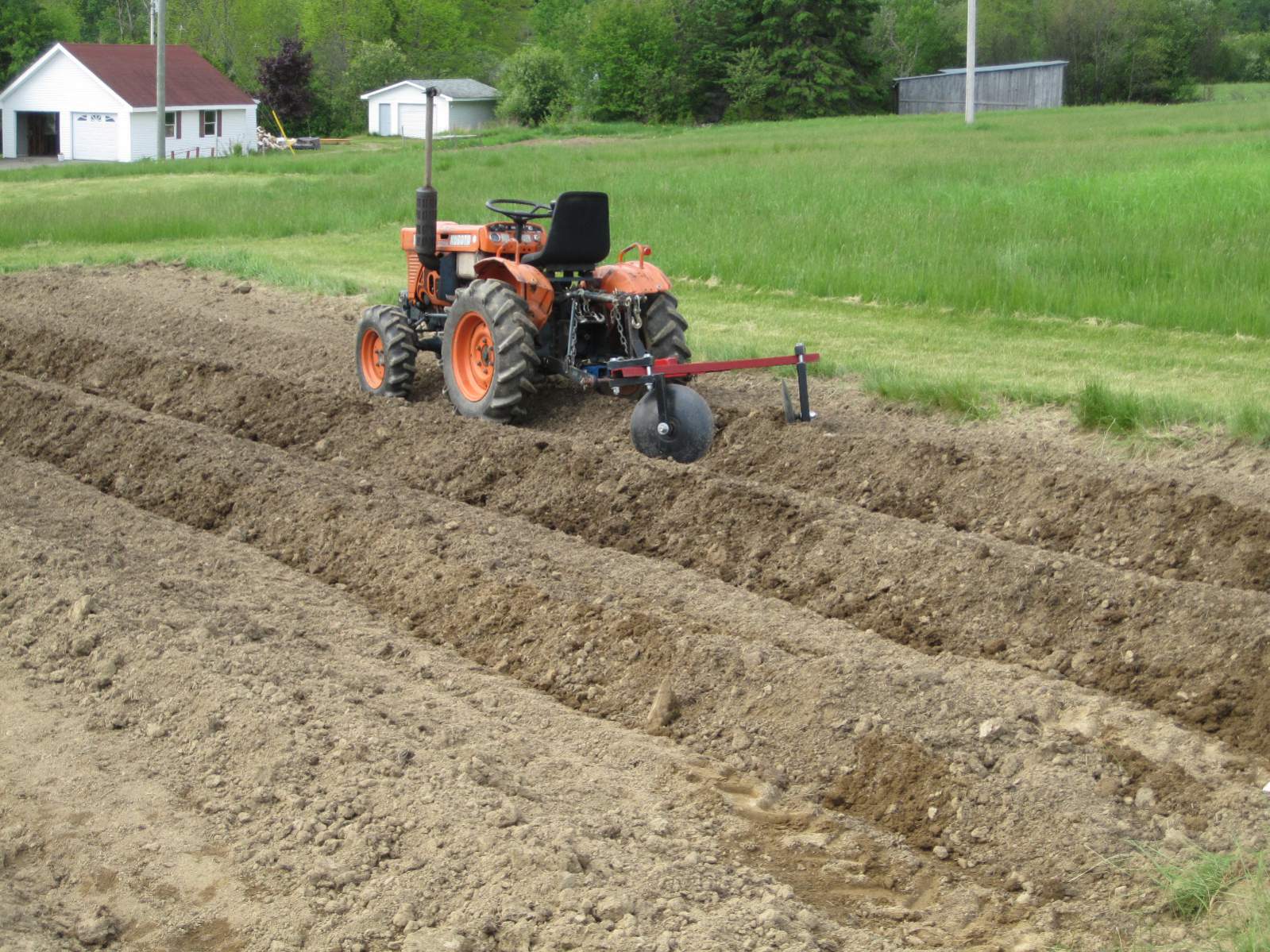

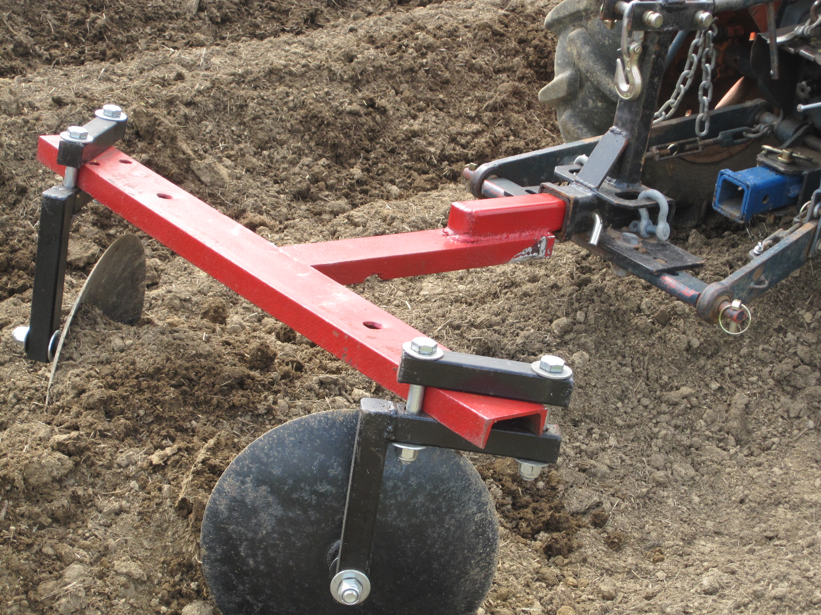

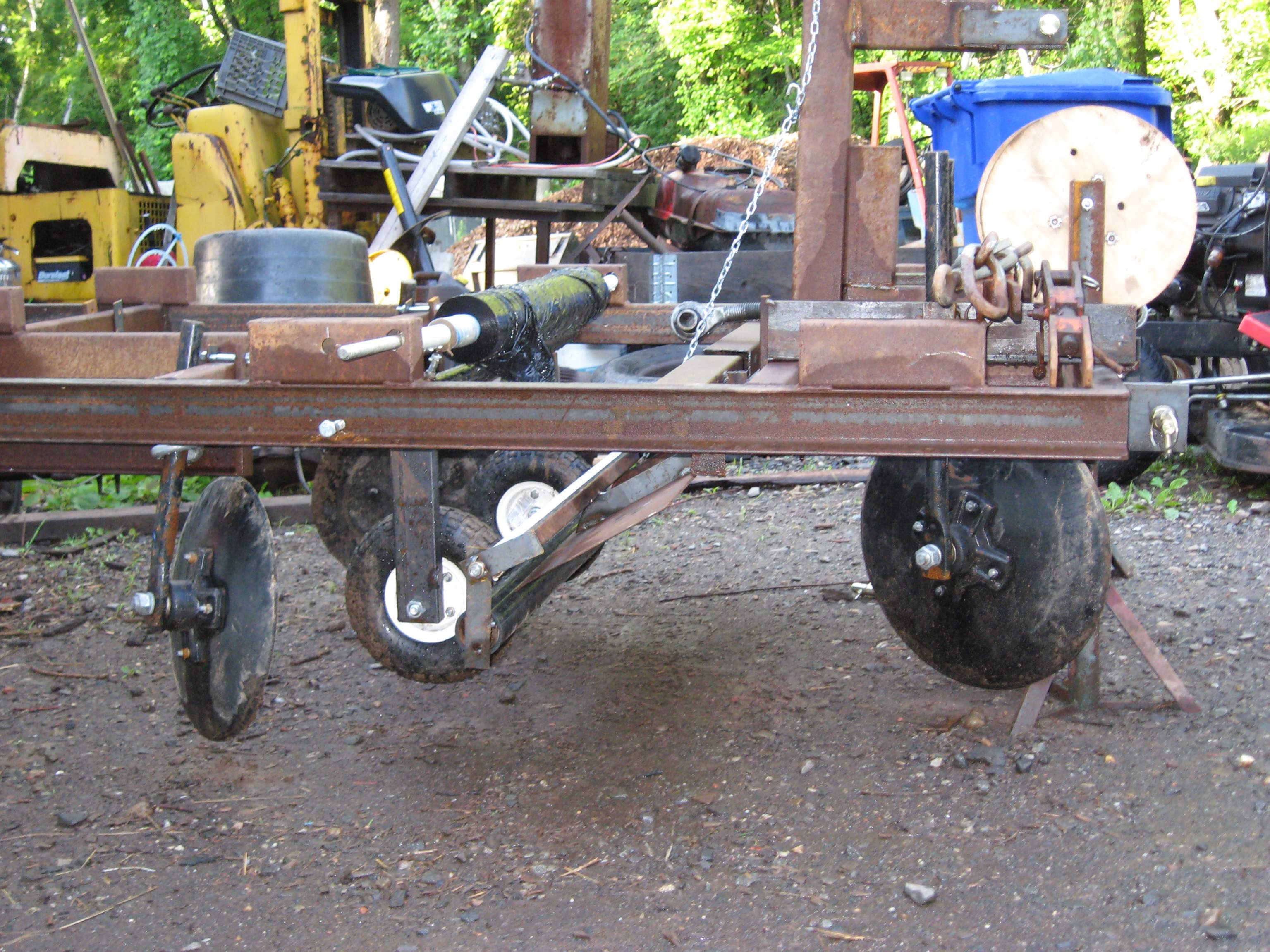

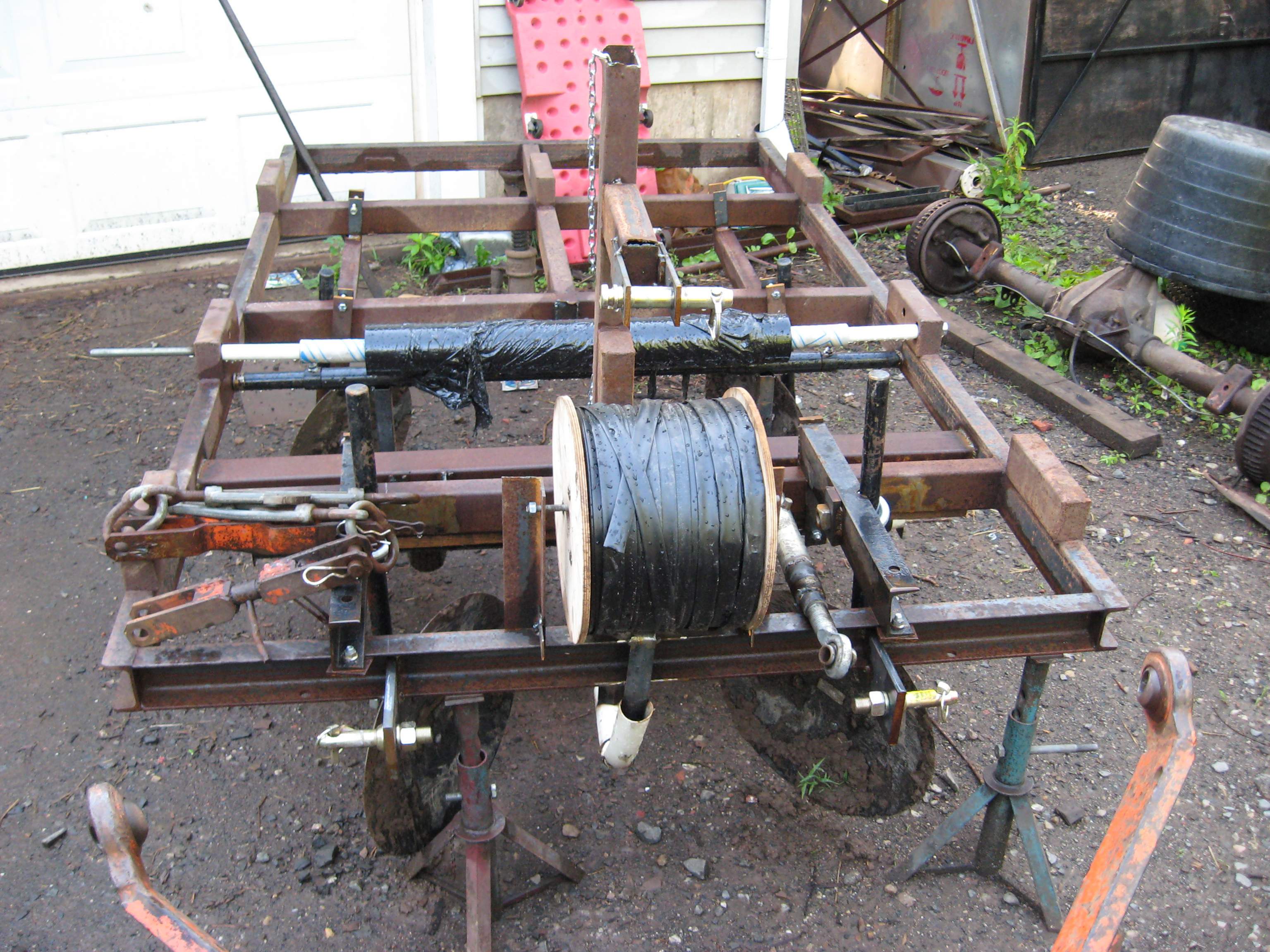

We build this outta a machine crate, and some assorted scrap we found. Only purchased items were the disk harrows from TSC. Worked OK, needed to use heavier gauge plastic to cover the hill,stuff we had was like saran-wrap. The irrigation tubing needed to be pinned in place before starting each row, then cut at the end of each row, kinda a pain/hassle. But the overall results were a almost weed-free garden, with limited water useage, and a booming crop.
