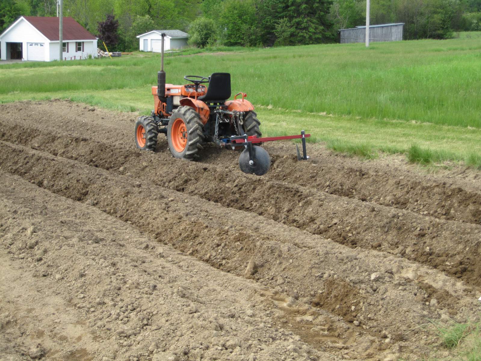

Anyone ever see, make, or know about any home made tractor mounted bed raisers for a garden? My shovels are to old to keep making them do it.

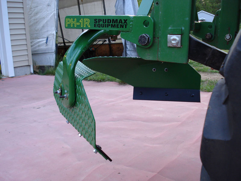

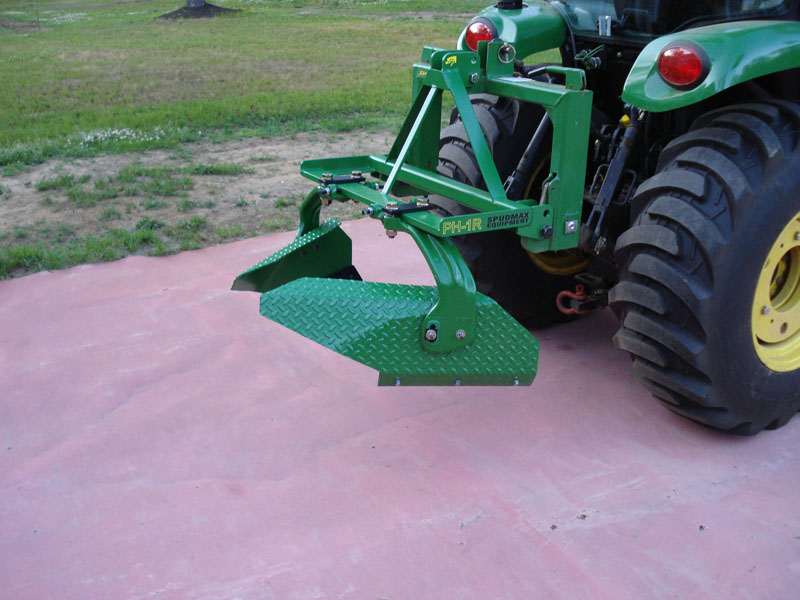

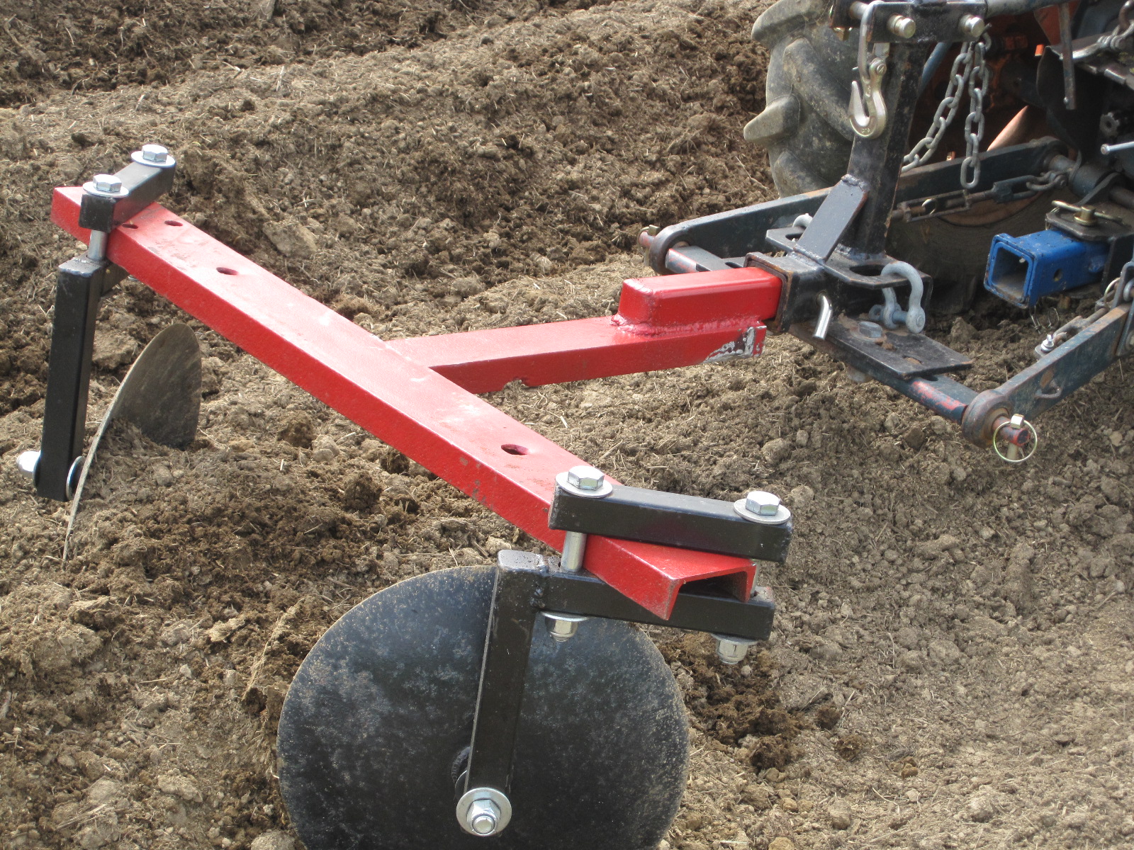

Heres one I made...
Last year I fabbed up a toolbar and Disc Hillers...was not impressed...

/ Raised Bed Maker #3
Last year I fabbed up a toolbar and Disc Hillers...was not impressed...[/QUOTE]
What do you mean? Doesn't work as you expected?
Man OH Man that's one nice looking piece of equipment and it's a shame it is disappointing. I'd love trying to design one similar but I don't have a tractor the correct size.

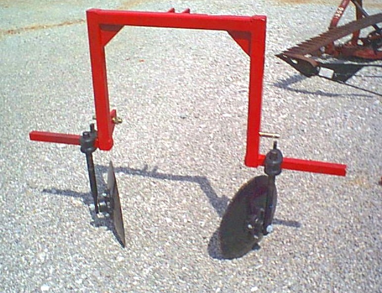

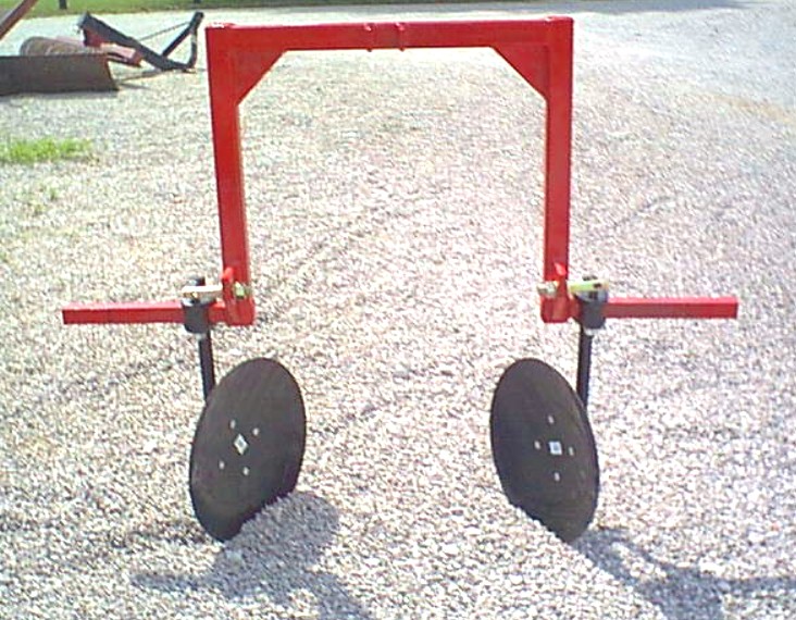

Everything attachments makes a disk type that looks to work good. Would be easy to adapt spuland_dave's bar up to take a set of disks. Disks have always pulled easier for me. Check out the video to see if it looks like it would do what you want. There are several other manufacturers of the disc type hillers.

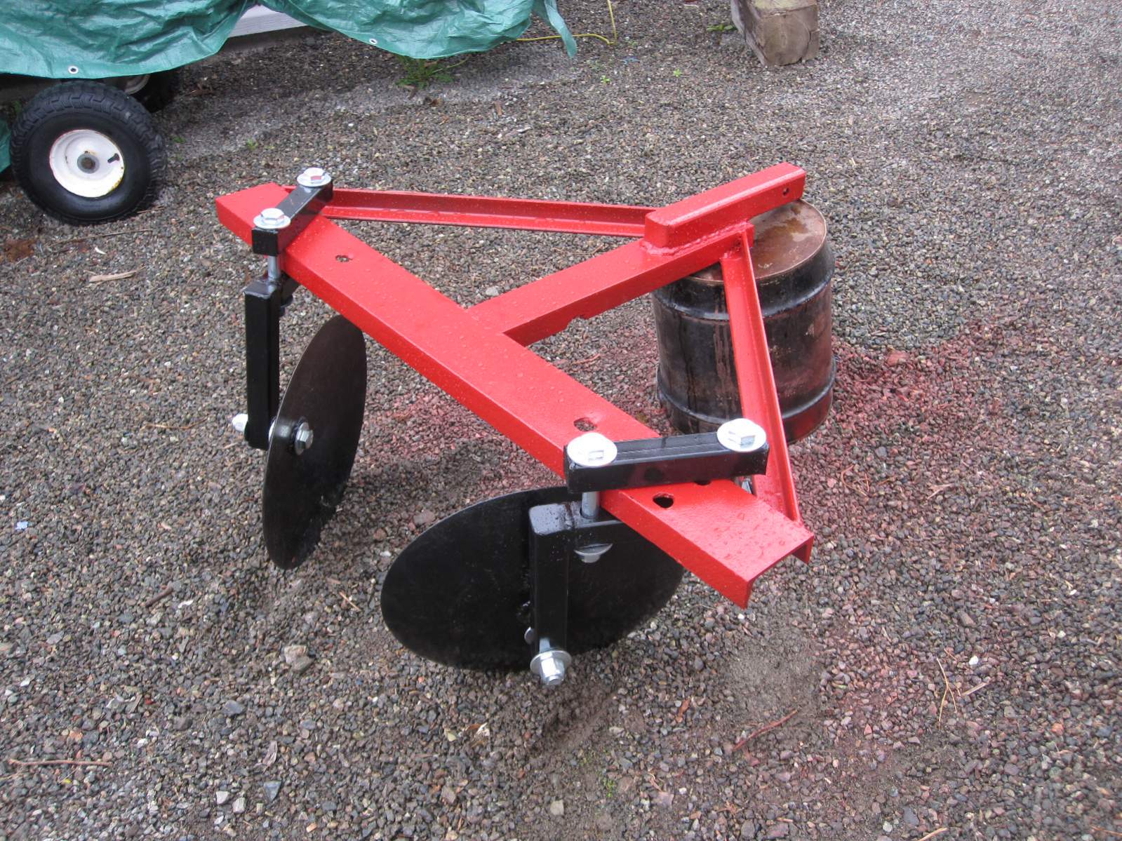

/ Raised Bed Maker #6
Here is a simple setup that can be easily fabricated. Ken Sweet

/ Raised Bed Maker #7
Bingo...I think I may have confused some of you...the one pictured I built this spring...THIS version works like a charm.
Last year I had a set of discs like Ken posted (toolbar was a little different) and I didnt think they moved enough dirt to make a nice row.

Looks like something I need to build this winter. Ken, was that something you built? Wondering how it worked.
/ Raised Bed Maker #14
The run $545 and I am sure you can pickup similar designed machines about anywhere. They are not rocket science. Most anyone could fab one up. No complaints from users. Ken Sweet

/ Raised Bed Maker #17

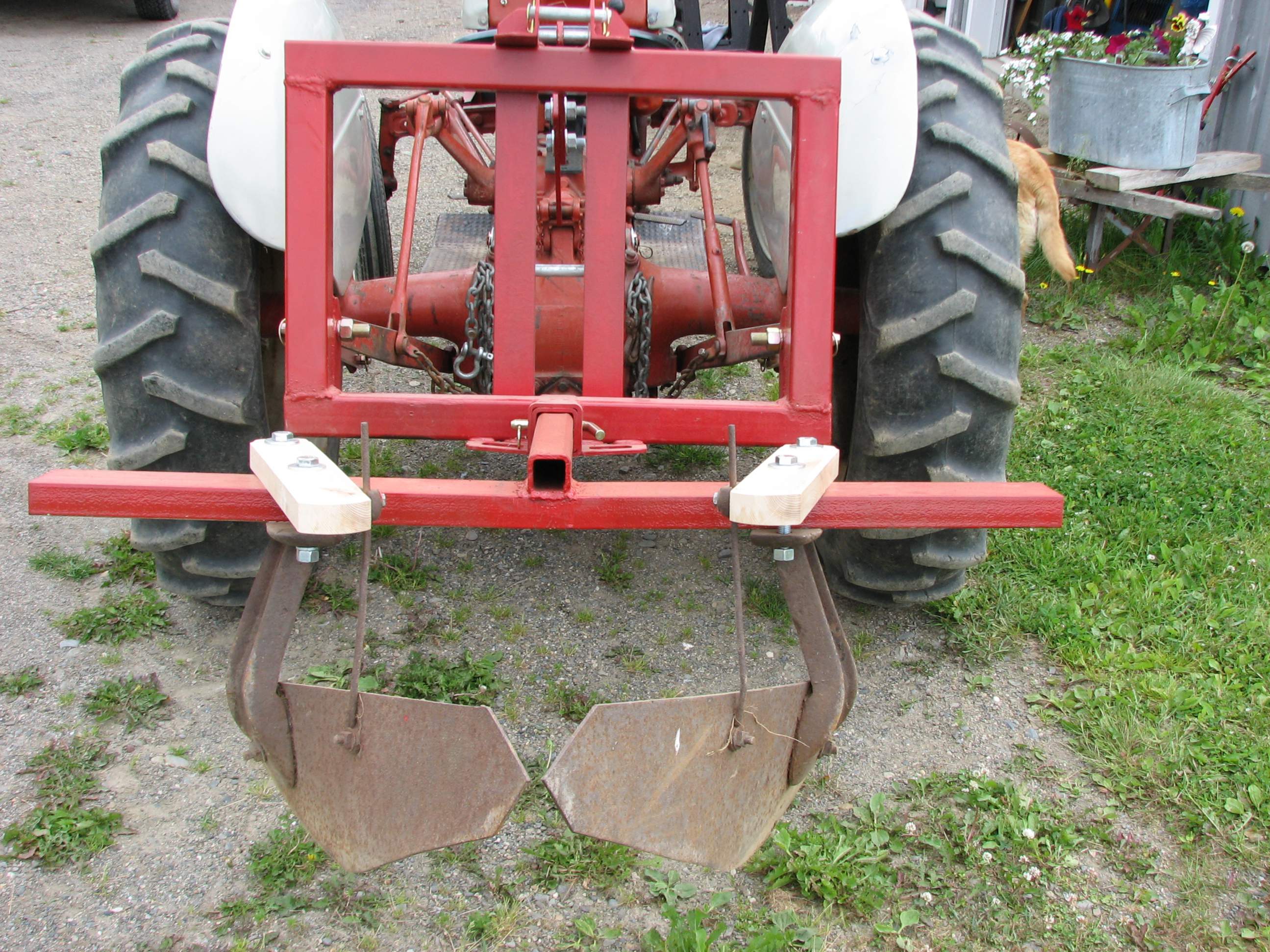

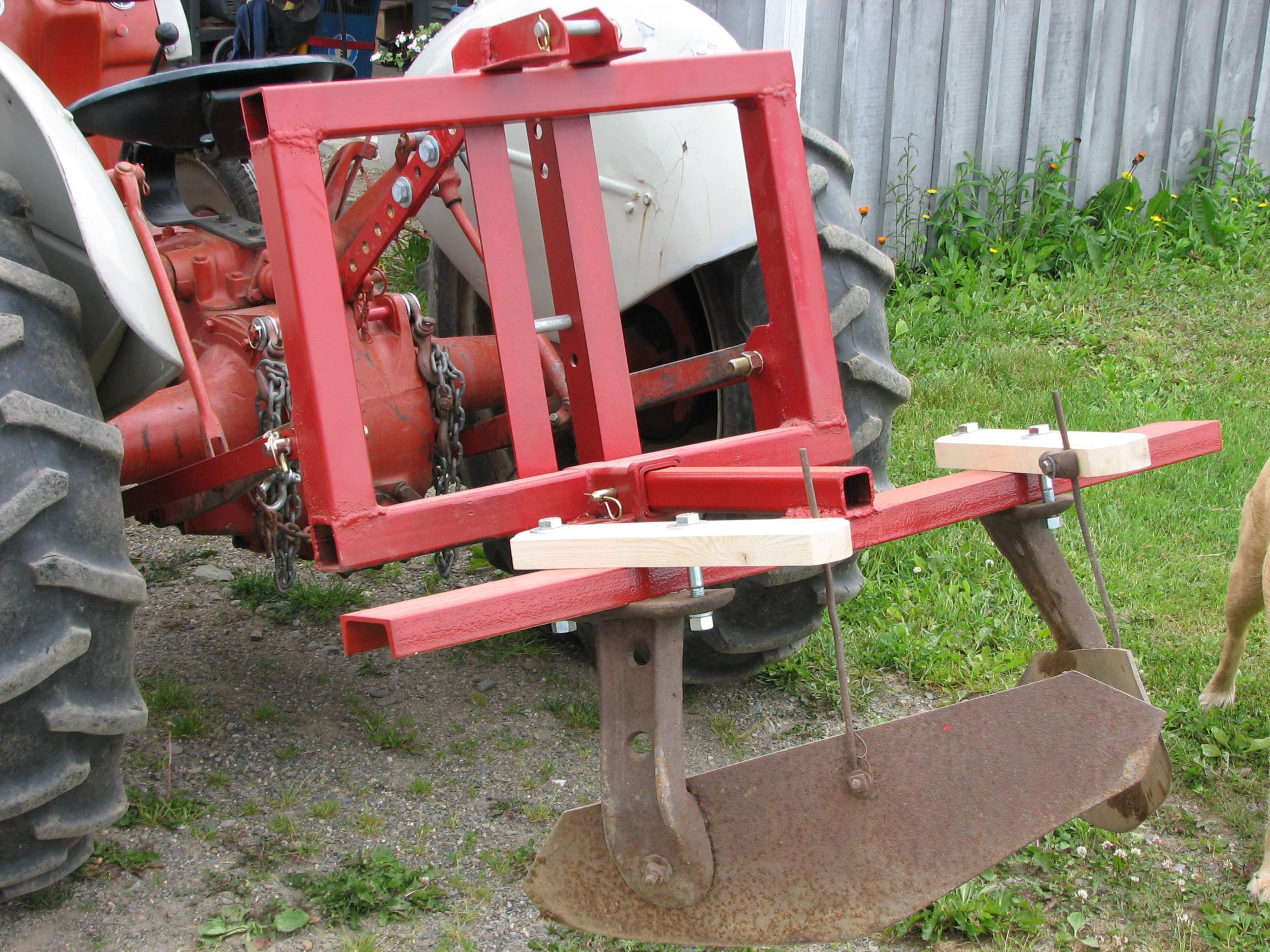

Here are 2 sets I have made for behind my '47 Ford 8N & my 1980 Kubota B7100. Conventional one was made using metal parts from an old horse drawn set I found at the dump. Other set was made using discs from an old disc harrow. Both work excellent.

/ Raised Bed Maker #18
Nice job on the bed formers, Ken. What crops are you planting?

Big Barn, I plant a couple rows of potatoes (to feed the potato bugs), cucumbers (to feed the cucumber bugs), tomatoes, yellow beans, peas (bush & sugar snap), swiss chard, zucchini (to leave on all neighbours steps) & a whole row of rhubarb. This is at our summer cottage where we live from May thru October.

Those are nice, good looking beds also! LUTT
