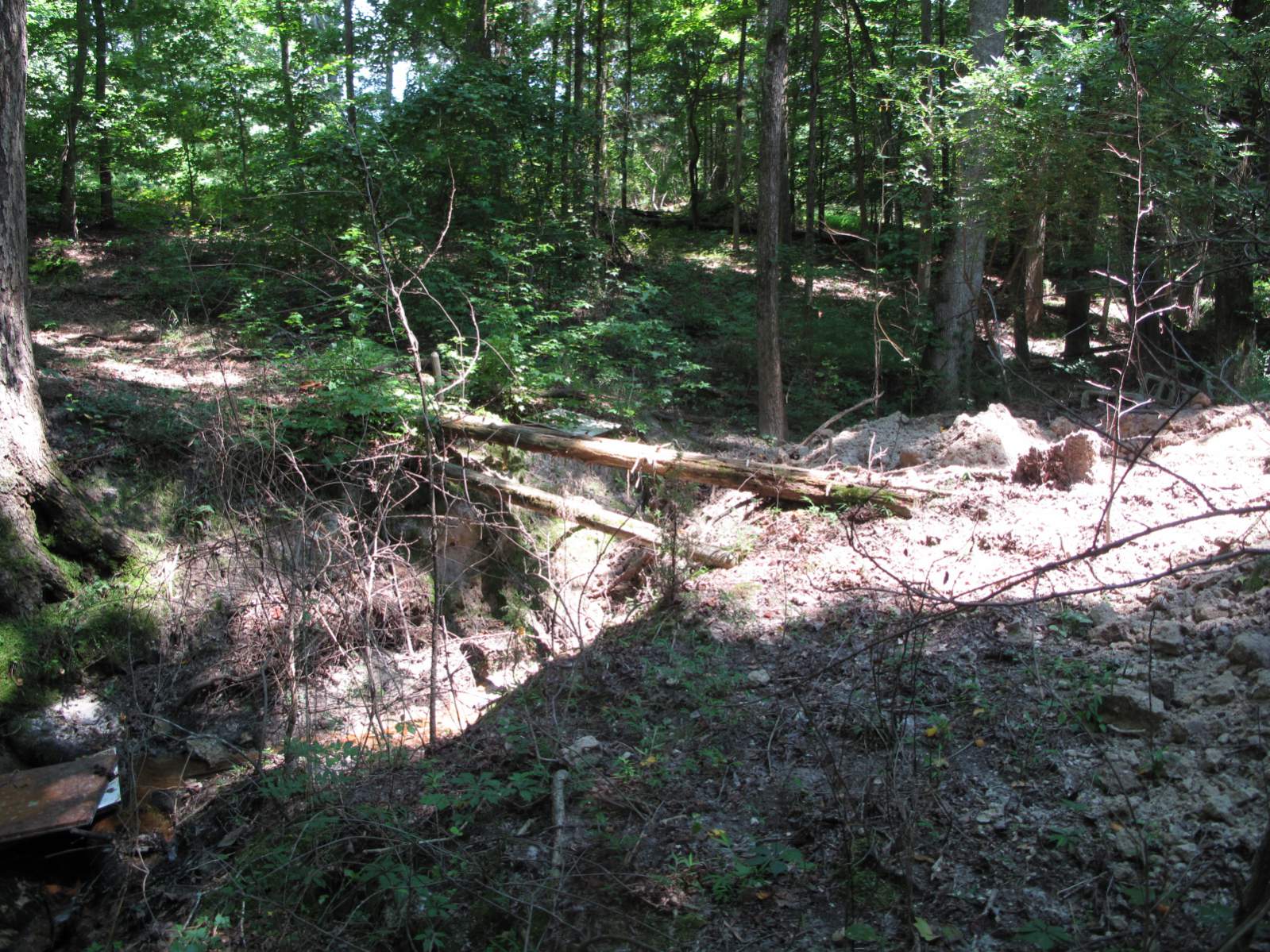

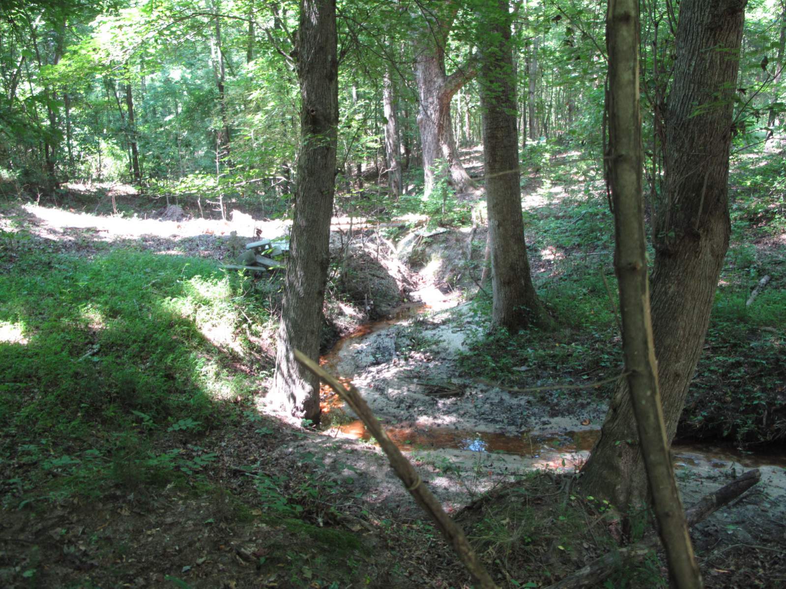

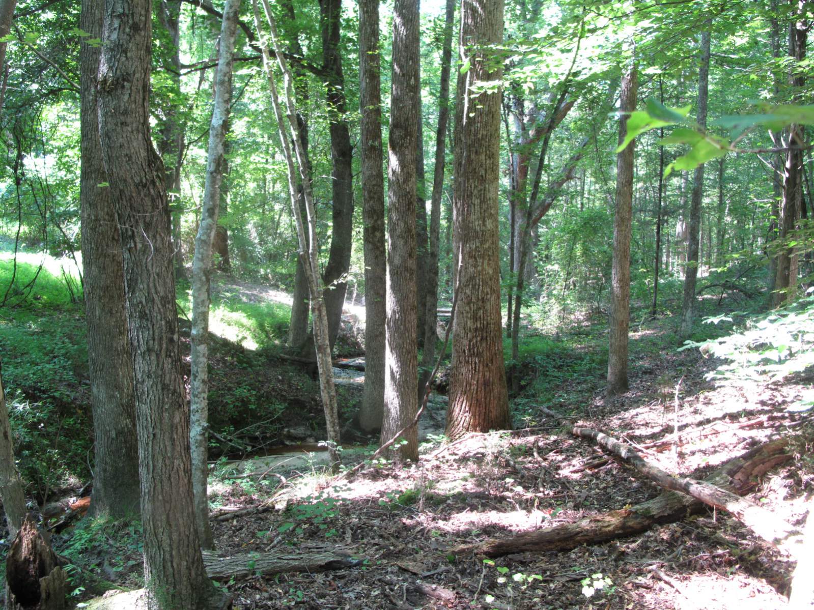

I had a similar issue with a small creek behind the house. The creek is 8.5' wide and the banks were 6.5' tall. On the average day the creek carries about 8-9" of water. I started by widening the creek to 12' to keep the water depth down. I then cut ramps on each creek bank. Now I simply drive down into the creek and back up the other side of it. I had a few issues with deep mud in the creek itself; however I just laid two layers of flat rocks across the creek bed. I like bridges but there's something nice about driving through the creek. Good luck mate.
/ Railroad rails.
#35
I had thought about that but the trail down into and out of the area is already fairly steep. By the time I cut it out to be able to cross, it would be a major slope. I want to use that passage to be able to haul a trailer out carrying logs for firewood. Even with 4WD I don't know if I could pull a load up that slope without creating a mess every time.
/ Railroad rails.
#36
This might give you some idea how steep the trail is coming into and out of the gulley. It is a pretty steep slope. Cutting down to the bedrock at the bottom of the gulley would make it a lot worse.
