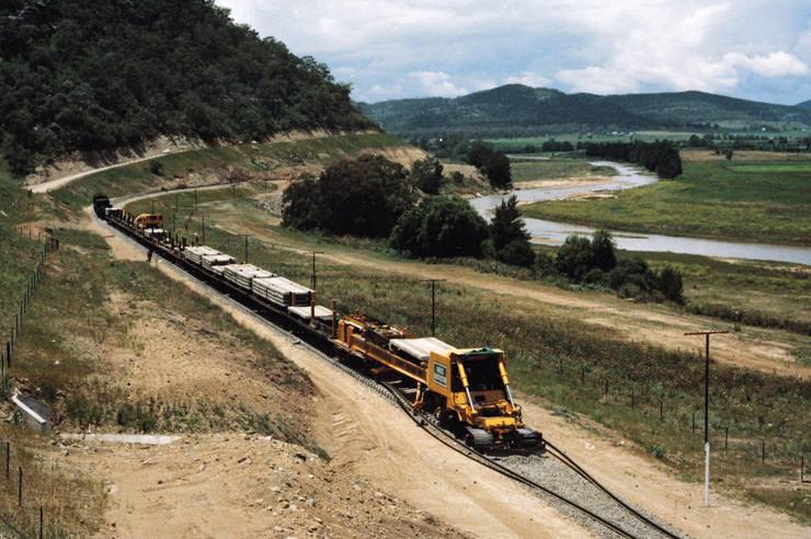

First, rail comes in many sizes.
Rail& Crane Rail
Second, rail is pretty flexible compared to steel beams.
http://www.maritimejournal.com/__data/assets/image/0008/809927/London-Gateway-3.jpg

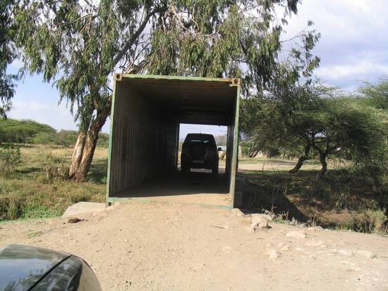

2. Use a 20 box container or old truck trailer, open both ends, and have a covered bridge.

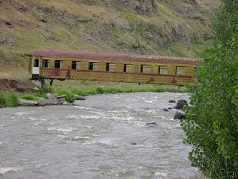

4. Railroad flat cars are often used, but this is more interesting.
