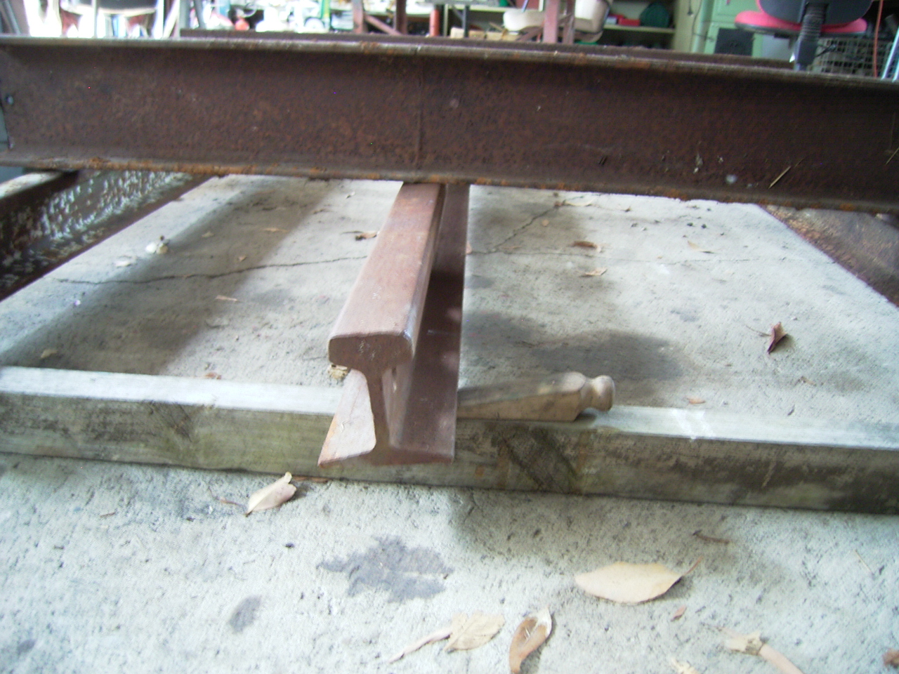

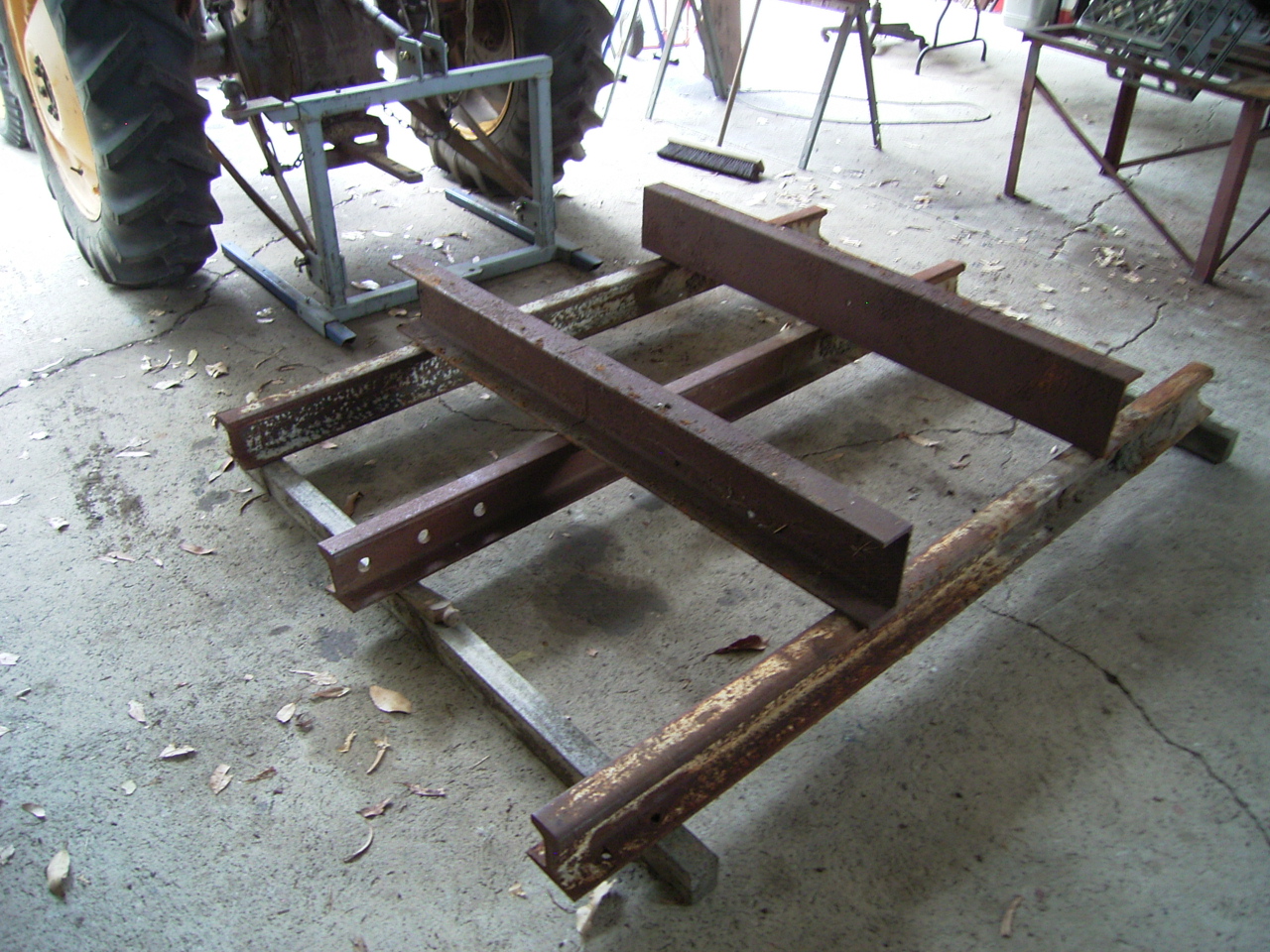

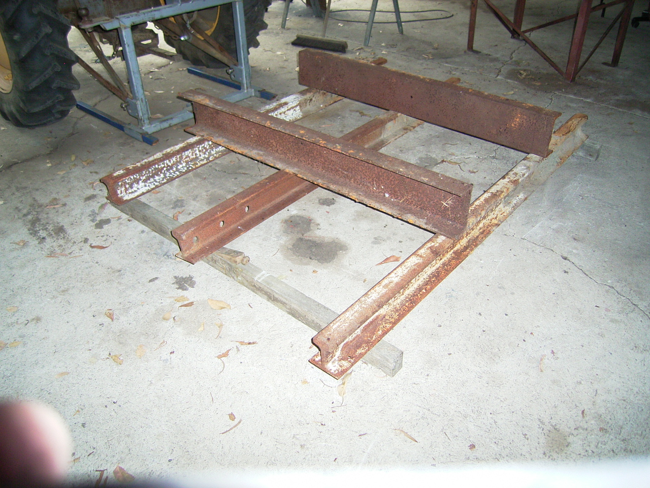

Who has built or used one of these, or similar.
Idea is to use it to smooth rough ground in the spring and autumn.
The photos show a rough mock up of the layout planned.
It will have a 3 point hitch with a floating top hitch (similar to most slashers or brush hogs) the plan being to use it behind a MF35.
The 35 lifts the weight with relative ease and still steers ok.
I favour setting the front and rear level with the centre rail forward of centre

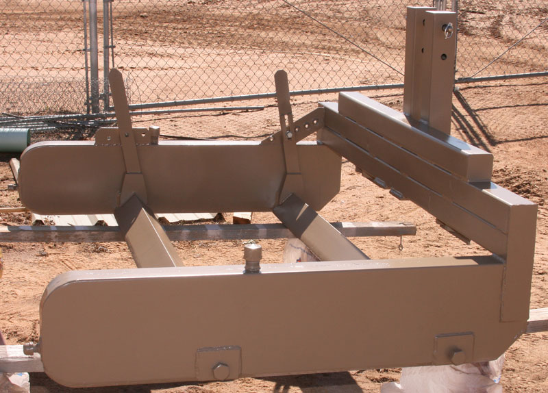

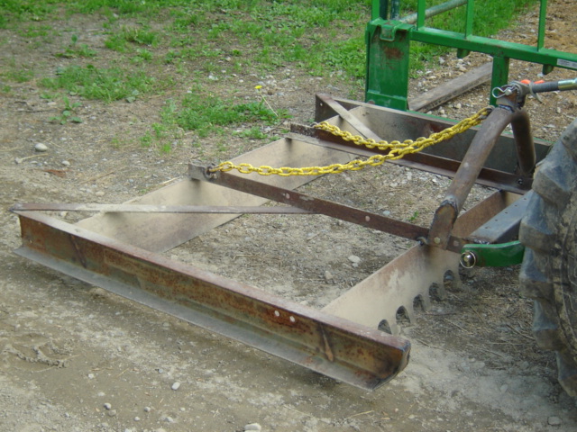

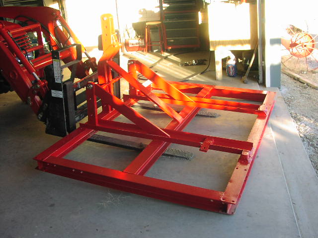

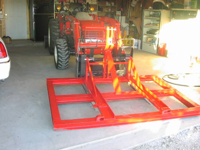

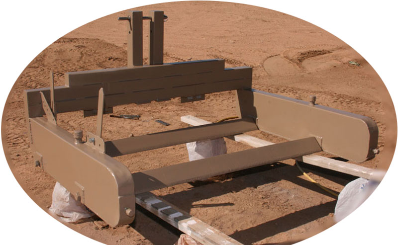

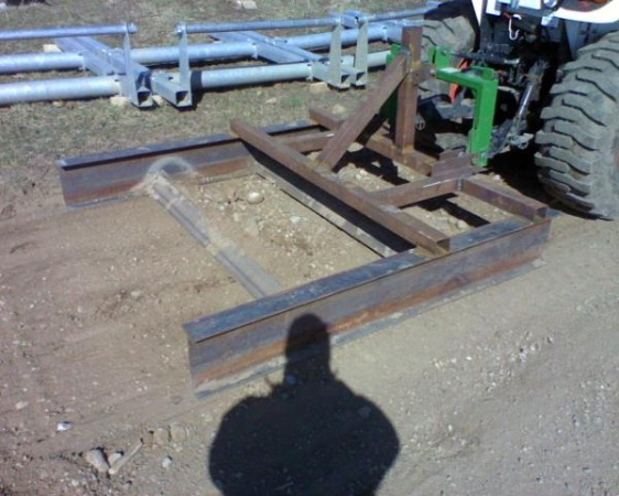

So Landplane is what you call these things.
Searched for Landplane as mjncad suggested.
Lots of land planes, land graders and drags out there and some great ideas from tractorbynet members. Found these interesting.
DSC00121.JPGimage-4196853292.jpgP1000915.JPG.
but this one from oreok has sent me back to the drawing board.
Now to figure out how much angle and protrusion to put rail iron on.

There are many build threads on landplanes. The one picture you posted is the one i built, very simple design

Finally I got to spend some time this arvo to mock up my landplane.
Insiration has come from tractorbynet member builds
Obviously I am using what materials I have on hand wherever possible, hence the rail iron.
my build  22 feb 2013 007.jpgmy build  22 feb 2013 011.jpgmy build  22 feb 2013 017.jpgmy build  22 feb 2013 018.jpgmy build  22 feb 2013 021.jpgmy build  22 feb 2013 022.jpgmy build  22 feb 2013 025.jpg
If the top links don稚 cut for adjustment I will go for bolts as per orezok's design, hydraulics would be gr8.
The plan is to pivot the front edge of the rail iron up 25mm and down 25mm from level, which should allow for all gound and material conditions.
The final build will have gussets and reinforcement.
