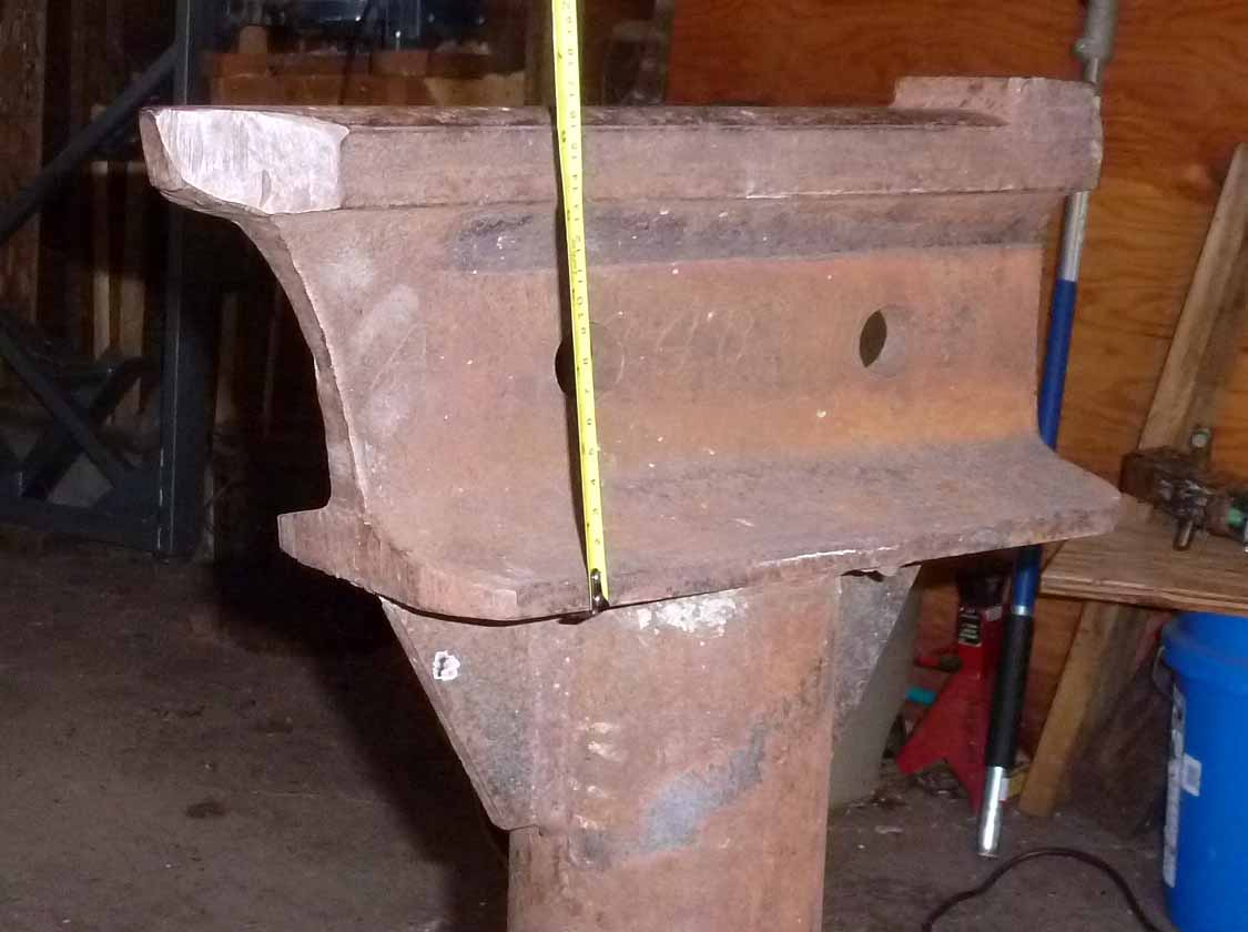

Like your anvil and stand. The stand is least understood and appreciate tool. Necessary part of the anvil to move metal efficiently.
My stand has 8’ of railroad rail, 200# of drill shavings and plasma cutting dust in cement incased in tubing.

Here is a pic of the rails hieght. I went on-line and tried to find its weight but couldn't. That's pound per yard as rails are gauged or measured.. Its about 6.5 inches tall.

I bet that took a lot of grinding wheels and time too. How did you put the Hardy Hole in it?
That was my first thought when i saw Uwould's anvil. After thinking about it I figure he is a torch wizard and that makes a huge difference in required grinding.

I work for the railroad, used a piece of scrap head-hardened 136lb rail, Did the cutting on the base and web with a torch and ground with hydraulic hand grinder, cut the ball freehand with hydraulic railsaw, not a true hardy-hole, just drilled a hole. Rest of the grinding was done with an old black and decker electric hand grinder. Gave the anvil to my buddy Out in montana.
130 or higher weight rail is what I advised people to use for anvils. I have a RR background.
