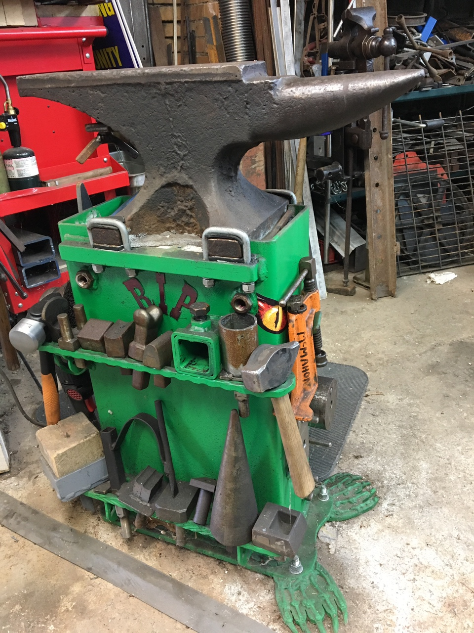

Like your anvil and stand. The stand is least understood and appreciate tool. Necessary part of the anvil to move metal efficiently.
My stand has 8’ of railroad rail, 200# of drill shavings and plasma cutting dust in cement incased in tubing.
Don’t get to forge as much as I like but enjoying particularly meeting some real craftsman.
Just now noticed the feet. Some of that subtle East Tennessee mountain humor going on there.

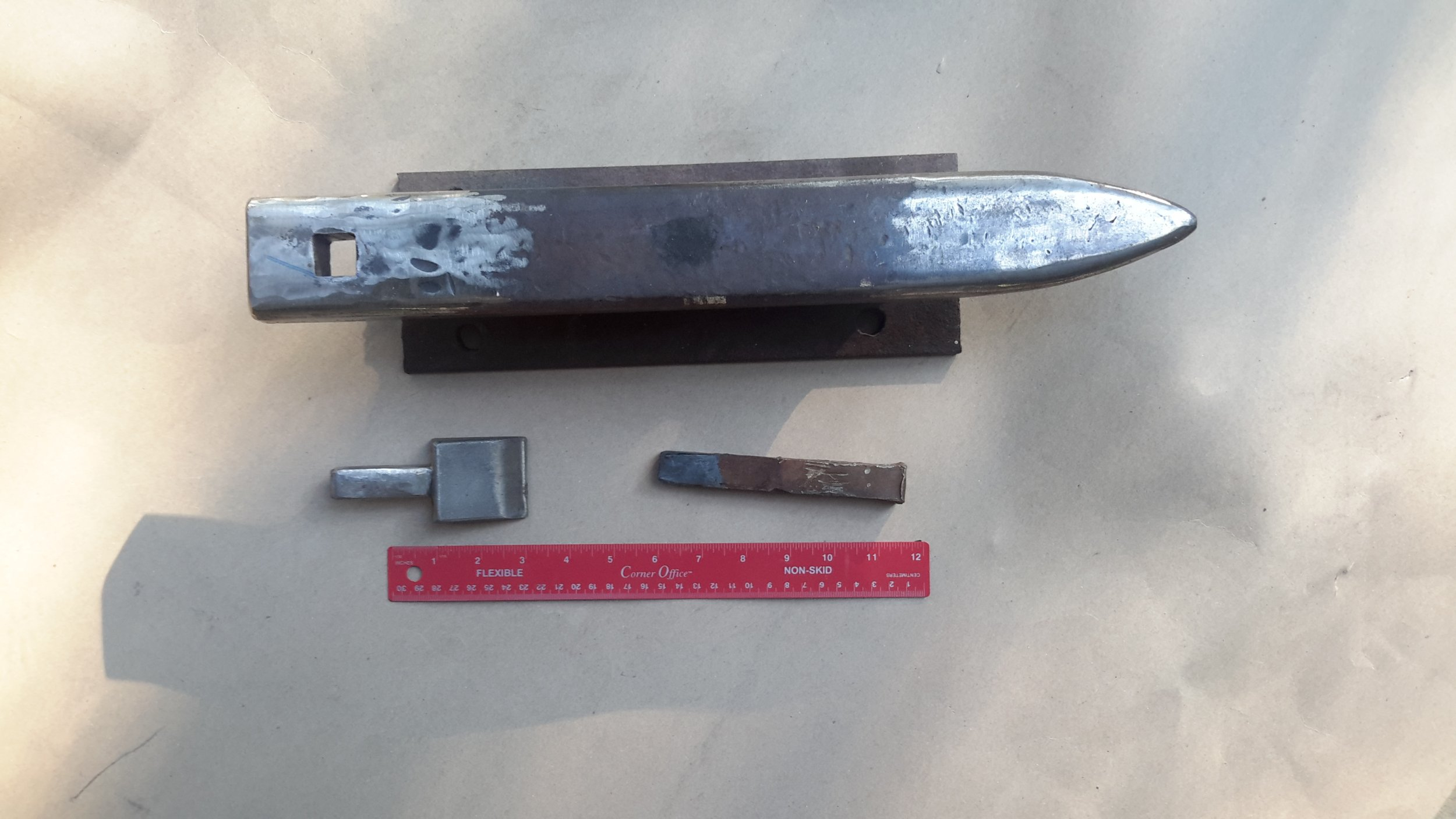

Here is a pic of the rails hieght. I went on-line and tried to find its weight but couldn't. That's pound per yard as rails are gauged or measured.. Its about 6.5 inches tall.

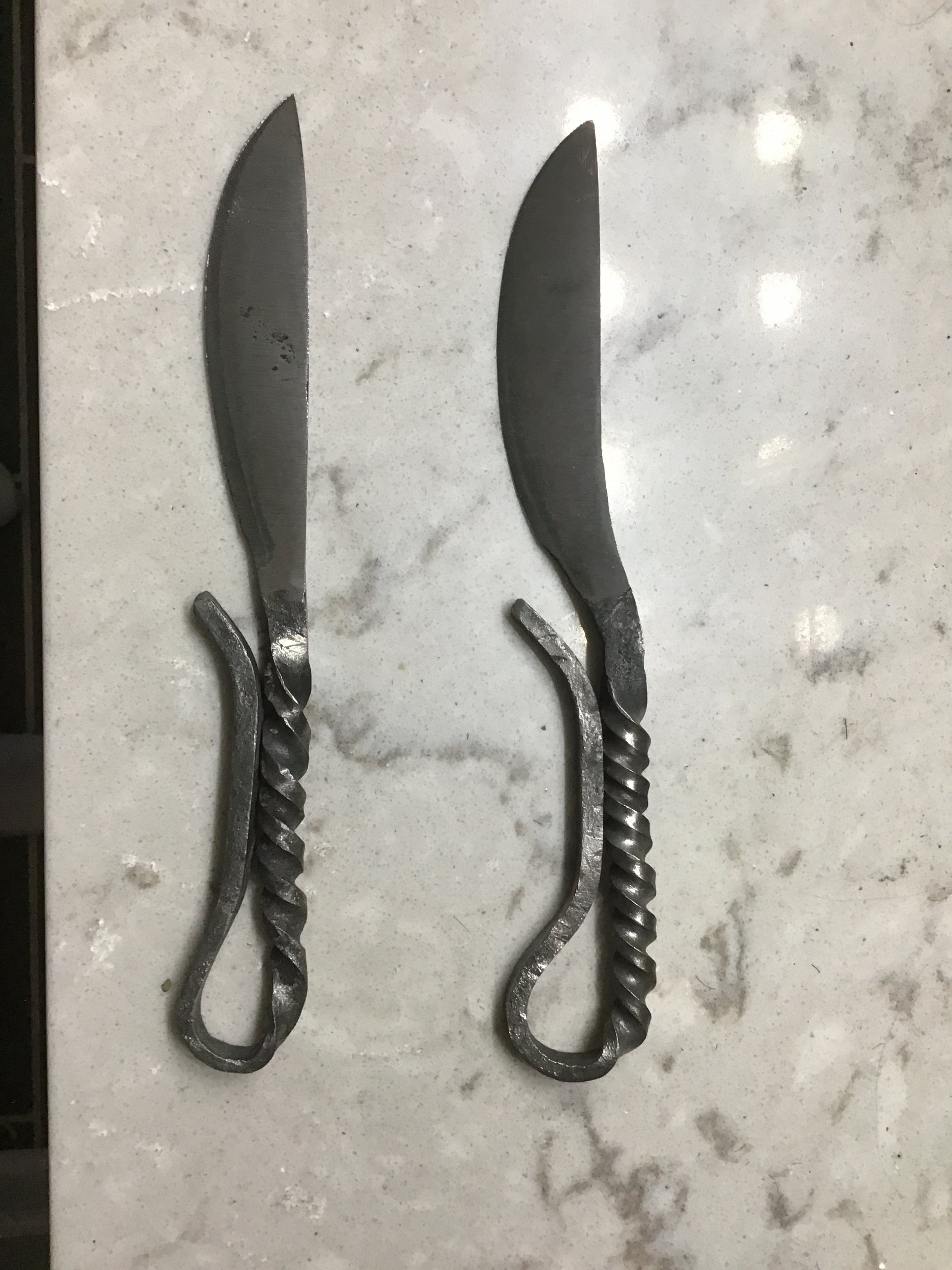

That wasn’t a problem, i was able to get plentry of heat out of it. I used lump hardwood, as a heat source. I just sort of lost interest and free time for that particular hobby. I tend to bounce around on my interests, doing more woodworking lately. View attachment 752331
Used up lawnmower blades make excellent knife blanks.
/ rail anvil build #27
I bet that took a lot of grinding wheels and time too. How did you put the Hardy Hole in it?

/ rail anvil build
#28
I work for the railroad, used a piece of scrap head-hardened 136lb rail, Did the cutting on the base and web with a torch and ground with hydraulic hand grinder, cut the ball freehand with hydraulic railsaw, not a true hardy-hole, just drilled a hole. Rest of the grinding was done with an old black and decker electric hand grinder. Gave the anvil to my buddy Out in montana.
