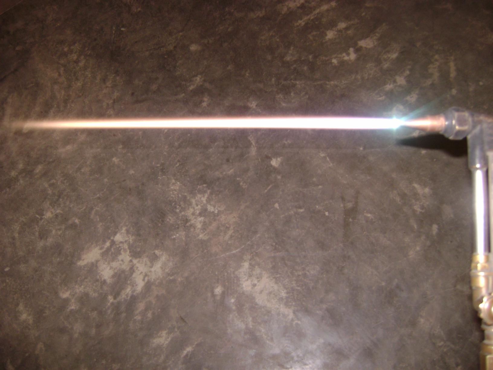

clean your tip and set the regulators until you have a 12 inch long feather when you pull the O2. It needs to be fine and long.
I'm about one step above a hack when it comes to torch work, but this is how I set my torch to cut. In my opinion cutting with a torch is just like welding with a Mig welder, you have to find that sweet spot. Most people push the oxygen lever all the way down. Every torch is different but I generally find the sweet spot by only pushing the oxygen lever an 1/8 to 1/4 inch.
